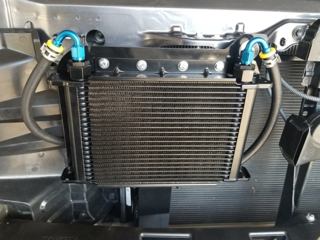

    So I have my truck at Toyota service anyway and so I asked about the transmission cooler and if they'd be willing to install one so they're installing a Hayden transmission cooler with all the rest OEM Toyota parts for $950.
    I wasnt that worried tbh but if they are willing to do it for the price i i said fuck it. I plan on keeping trick for 10 yrs so its money well spent i suppose

    I was reading up on a dodge forum all their trans overheating nightmares. Do our trucks have a trans fluid warmer that is supposed to switch off?

    How are they mounting it? I can tell you its a better option to use a custom bracket instead of them mounting it against the condenser.

    Where is that dealer ?

    I'm not really sure but if I don't like the way they mounted it I can always change it I'm not worried about that. The work will be done.
