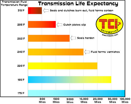

    Im just curious if Toyota has some new alien technology that allows the trans to run up to 280 degrees safely. :monocle:
    That is insanely hot and has NEVER been an acceptable temperature in any transmission. Ever.
    Im not taking any chances or pitching a fit over it.
    Im putting a nice aux cooler on mine and wont worry about it ever again. :spending:
