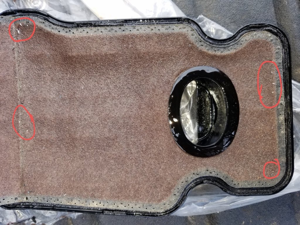

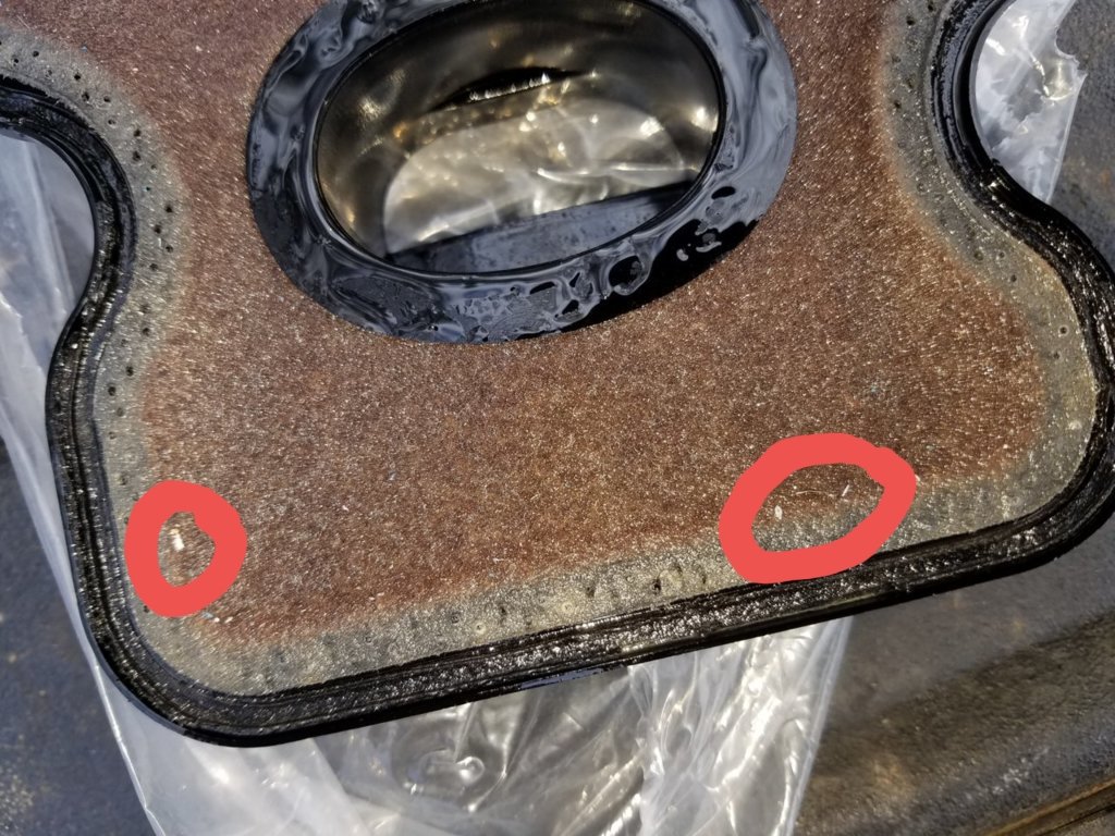

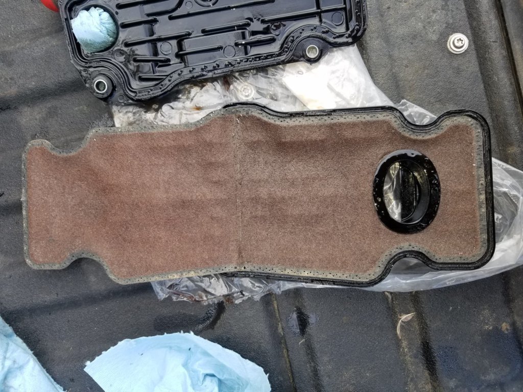

  7. Aug 14, 2020 at 7:24 AM
    #367
    Sumo91
    Sumo91 Busy with projects
    Nov 16, 2019
    #38726
    1,494
    TN
    2014 MGM Tundra Platinum 4x4
    Bilstein 8112/8100 3.25in lift Dobinson leaf springs 2.1in lift Level8 MK6 wheels Big ole dent in bedside
    Here's pics of my original trans filter I split open when I serviced it at 175k. Notice how little clutch material is in there. After 175k miles. Transmission fluid was changed only once before this at 80k miles. With WS fluid. Previous owner towed alot and did alot of off roading as he was an avid hunter. Truck now has 196k miles and runs flawlessly.

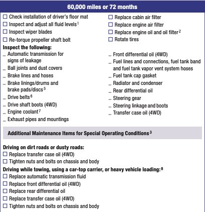

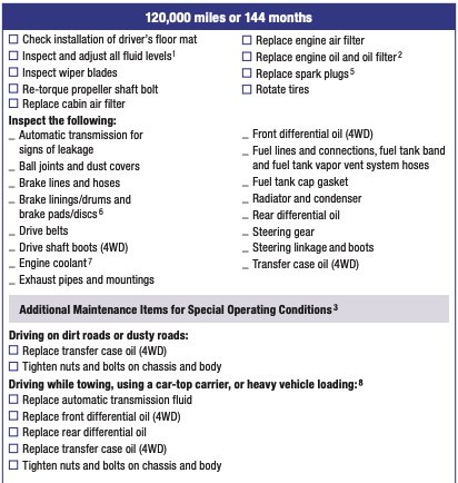

    I tow a boat weekly. It weighs about 5,000#, but more importantly has a t top that acts like a parachute. Interested to see what temps I get towing it.
  26. Aug 14, 2020 at 8:56 AM
