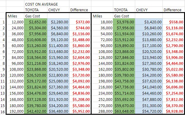

    In all honesty, all trucks guzzle gas... Should've thought of that first! LOL. My 16 Chevy Silverado gets about 14-15MPG in city driving to work.. the Tundra gets 12-13MPG.. big deal.
    Hwy it Chevy's computer says 21, but manually calculating it shows 20. Compare that to Toyota, when manually calculating to about 17 (the computer is pretty accurate on the Toyota - at least more accurate not over inflatted #'s).. it's not that much difference. I did a spreadsheet of the difference in cost alone, in 12,000 miles it will have cost me $370-$400 bucks more only. That's like 1+ yr driving for me.
    I doubt you're getting 4.6MPG.. big fat lie! lol Prove it. ;)

    I did know trucks guzzle gas silly man..lol!!..I had a 2017 Ram that I traded in for my Tundra. The Ram got shitty gas milage too. Its true that im getting 4.6 (just noticed it tonight) and I actually baby the gas. I can take a pic tomorrow showing the MPG. I usually average 7.6 but for some reason, it showed 4.6 before. It would be nice if it wasnt due to actual city driving and that the dealer can do something about it but when I took my Ram in for the low MPG, they were blaming it on my driving habits and I told the idiots that I baby the damn thing. Nothing they could do about it. Thing is I dont do any highway driving at all. Its all city and the fastest I go around town is about 45 mph and thats only a short stretch till the next light. Its all stop and go. I live in New Jersey, right across the Hudson River from Manhattan and nothing but traffic all day, everyday. I bought my truck in Jan. 2018 and I havnt even got a chance to open it up on a highway yet so maybe thats the reason why. I work in Manhattan so I take mass transit to work during the week so my truck is parked all week during the day.
