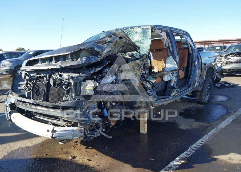

    I dropped a valve in my SC Sequoia. As it has 143k I decided to get a low mile motor (70k) and swapped it in.
    While I was in there I replaced the alternator, starter, waterpump, sensors, torque converter (all OEM) and plugs, coils etc.
    Now I have massive missing. Initially, there were other odd system glitches (loss of O2 reporting, throttle position, etc)
    The shop went through the wiring & all toned ok, yet 1&3 are still missing.
    The shop says it is the injectors, I have a new set coming but in the event the issue remains I'm hoping someone can help.
    Anyone have anything like this happen?

    Did you use the original trucks harness and sensors? Or the donor? Or a mix? Sometimes Toyota swaps pins around in harnesses during year and model changes.

    We used the '13 harness, and ECU that was there, compression was over 200, excellent leak down in all cylinders. Oddly at first the misfiring was initially only in cylinder 1.

    All sensors were replaced (using '13 part numbers) The damage to the donor truck was on the driver side & the cam solenoids were sheared off along with the harness so we used my '13 harness.

    Seems more than coincidence that the damage side is the one creating problems. If there was enough force to shear off the vvt solenoids, I would be worried that something in the valvetrain may have been messed up.

    There is no visible damage on the head, the solenoid ends/connectors are plastic, I hope it's not a valvetrain issue and would think if it were something starting at the actuators there would be more issues with all four cylinders as well as cam timing issues.

    Not all valve trane problems throw codes. In fact, most don’t. Yes, a problem with cam timing on a vvt engine will throw codes, but that would also affect all four cylinders. I have no real idea what your problem is. Just noting the coincidence that the left front of the engine area sustained serious damage and that same area is now giving you problems. A tough correlation to ignore. Maybe the head got cracked in that area. That drops compressions and you get misfires. Could be as simple as cracked spark plugs or coils. The 1 & 2 coils are pretty close to the vvt solenoid
