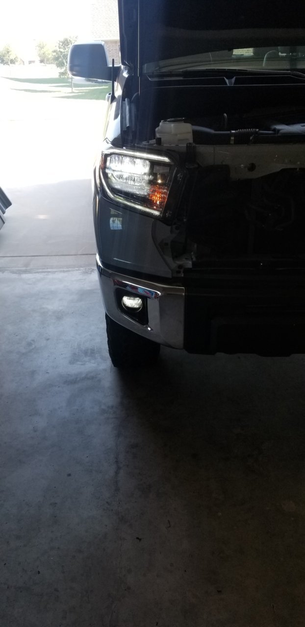

    Evening,
    Have finished the upgrade on the front turn signal lights on the 2018 Tundra CM 4x4 off road. After watching many "you tube vids" on having to pull the grill, head light lower valance and finally the headlight itself to install VLEDS. I can attest that the LEDS can be installed without removing any of the intimidating front of your truck. I did remove the bolts that hold the windshield washer fluid bottle down and on the driver side loosened the battery hold down bracket to move battery over a bit. Did disconnect the negative battery cable. IT CAN BE DONE. I know it is protocol to post pics and I will attempt to do this. A big THANKS to @BlueBottle for the picts of a previously completed project.
    [​IMG] IMG_20181014_152637024_HDR

    I guess I am clueless at posting picts here.

    IMG_20181014_152637024_HDR.jpg Finally, thanks for the prod to keep working. Still outrageously happy with the improvement, fear it is just the beginning.
