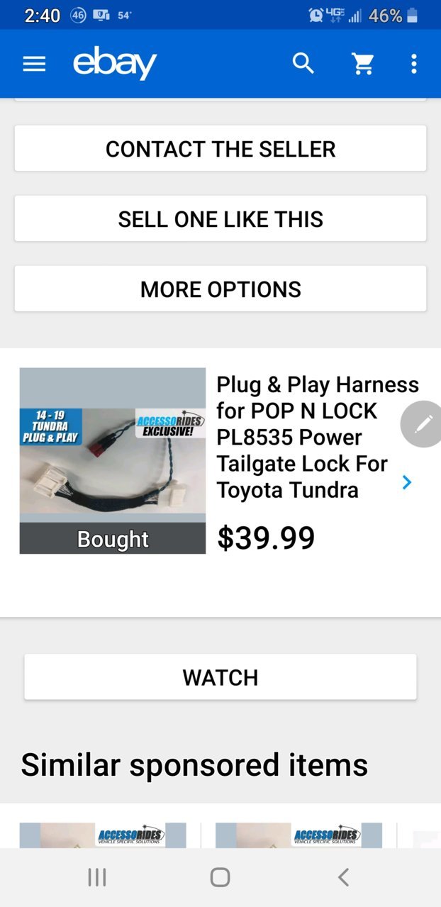

    I used this harness on my 2016 with the POP N LOCK and it worked flawlessly.
