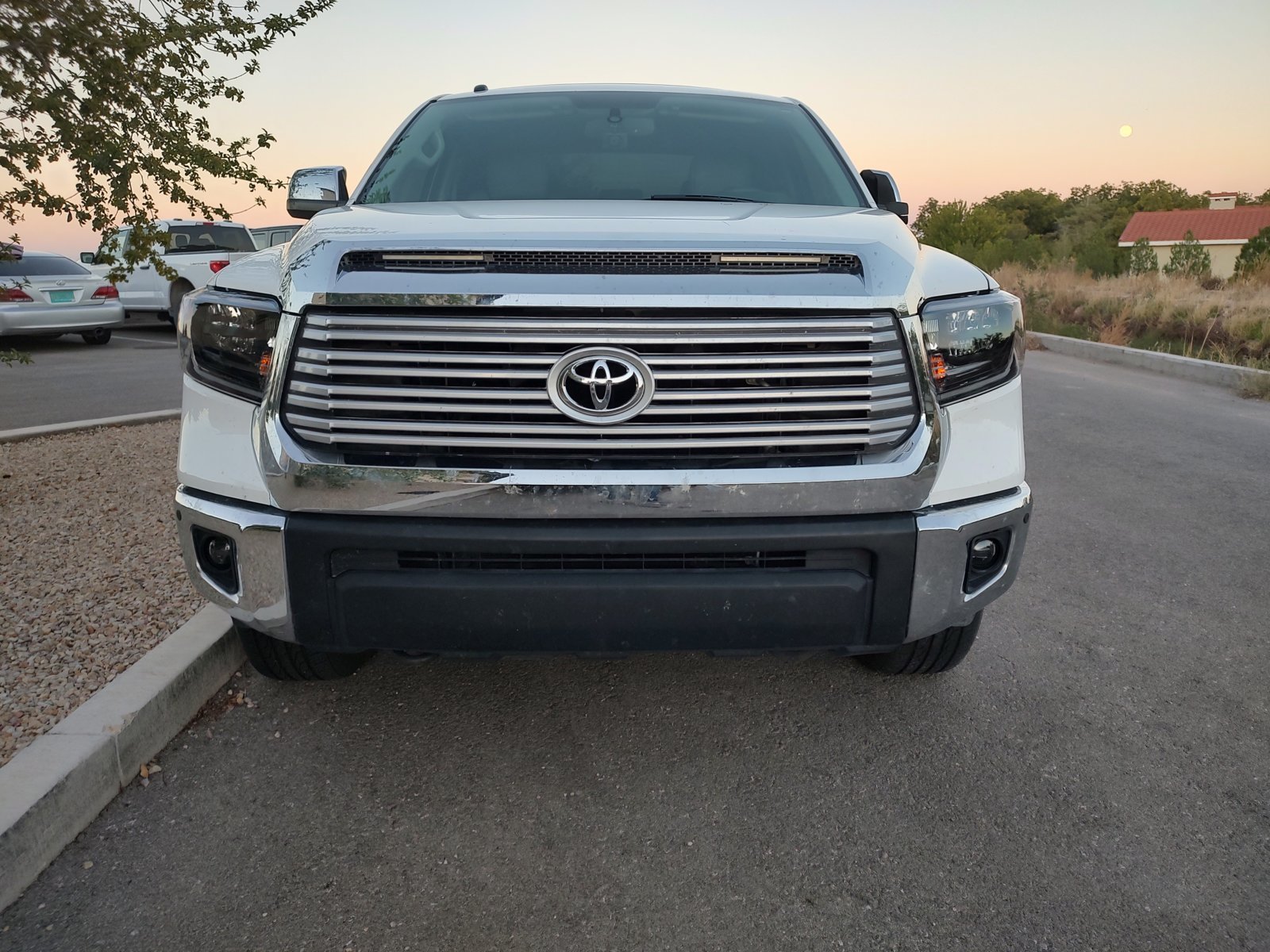

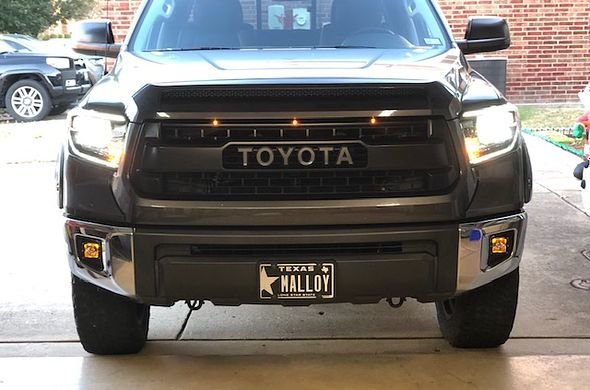

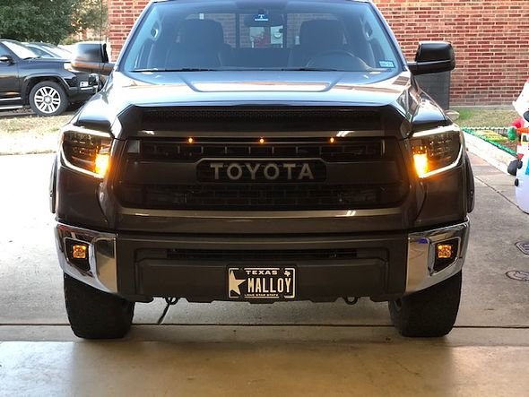

    Shoutout to iHacker for a high quality product & quick shipping! I got my harness within the week I ordered it & had no issues while installing these LED headlights on my 2017 Limited CrewMax. Everything was plug & play & worked the way it was supposed to. I could not be happier with how the truck came out. Don't hesitate to get your harness from him, he's got a great quality product.
    Here are some before & after pics:IMG_20230805_103354413_HDR.jpg IMG_20231027_181056560_HDR.jpg IMG_20231027_181028629_HDR.jpg

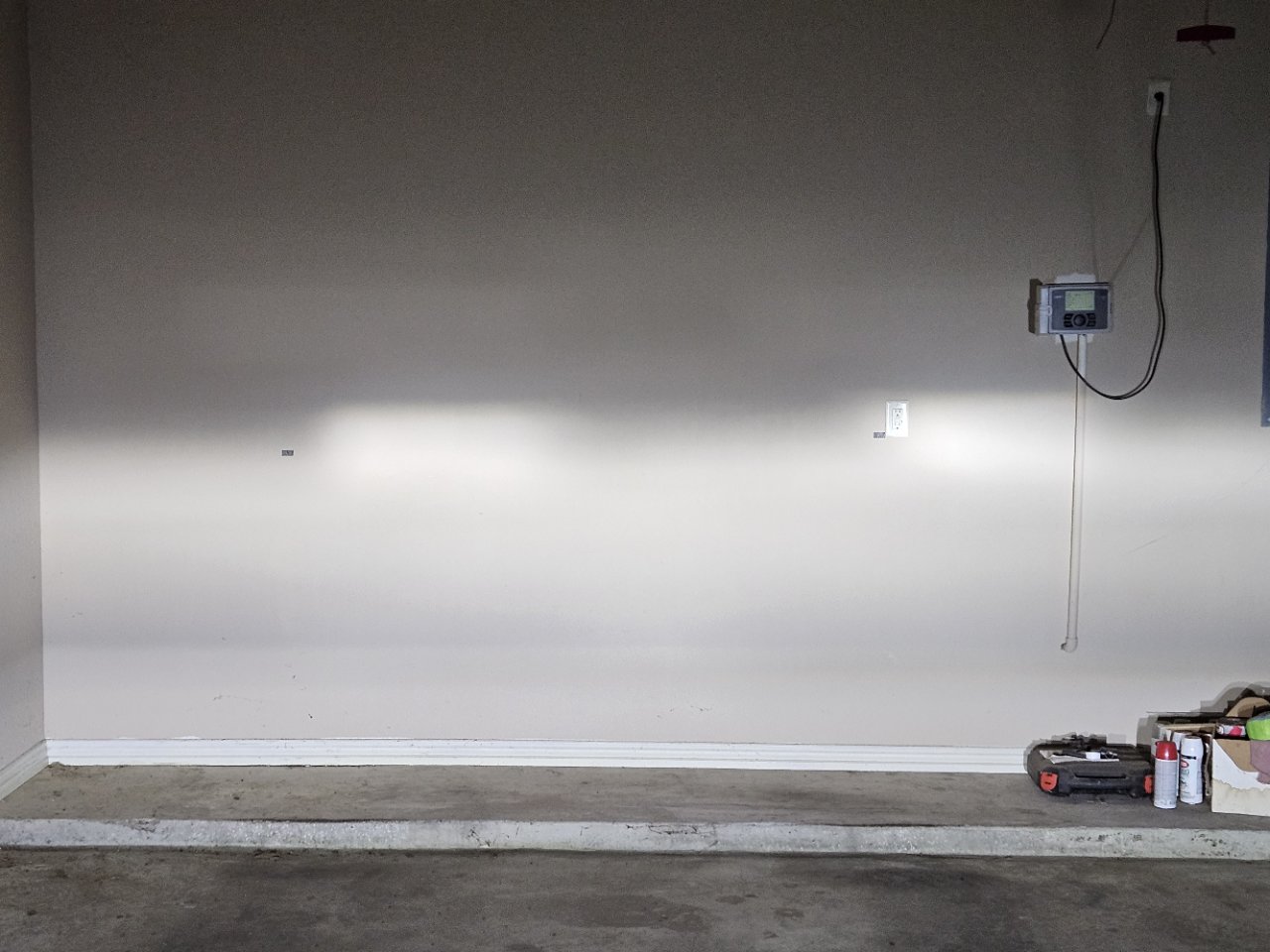

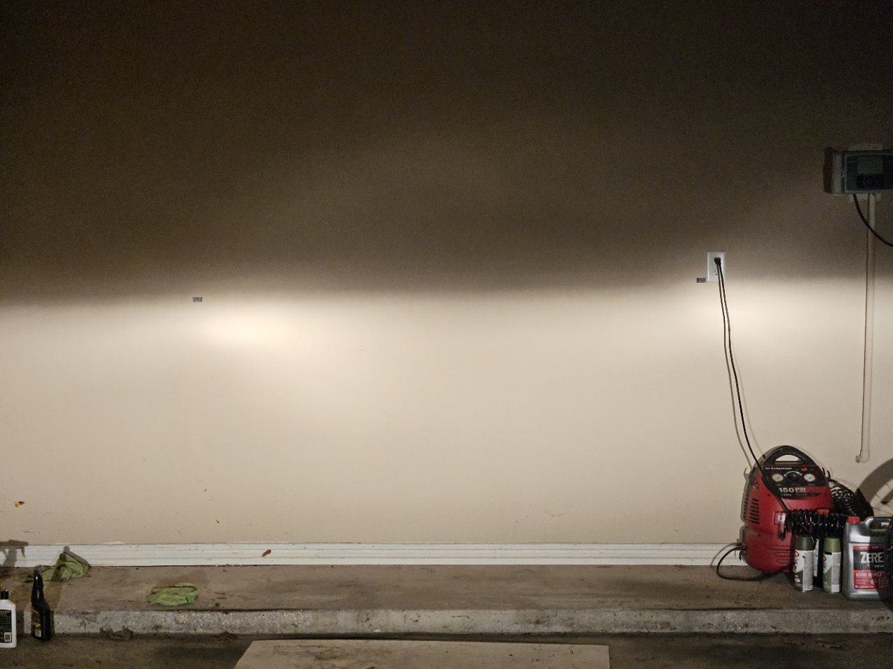

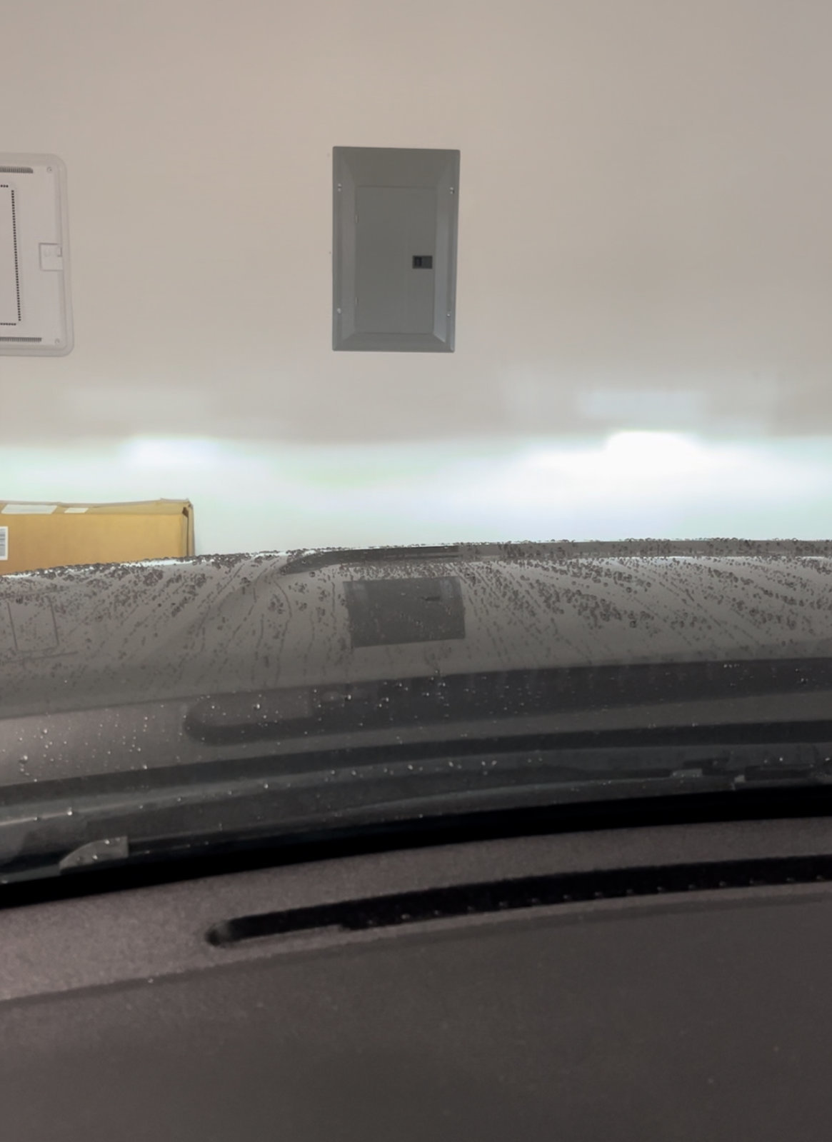

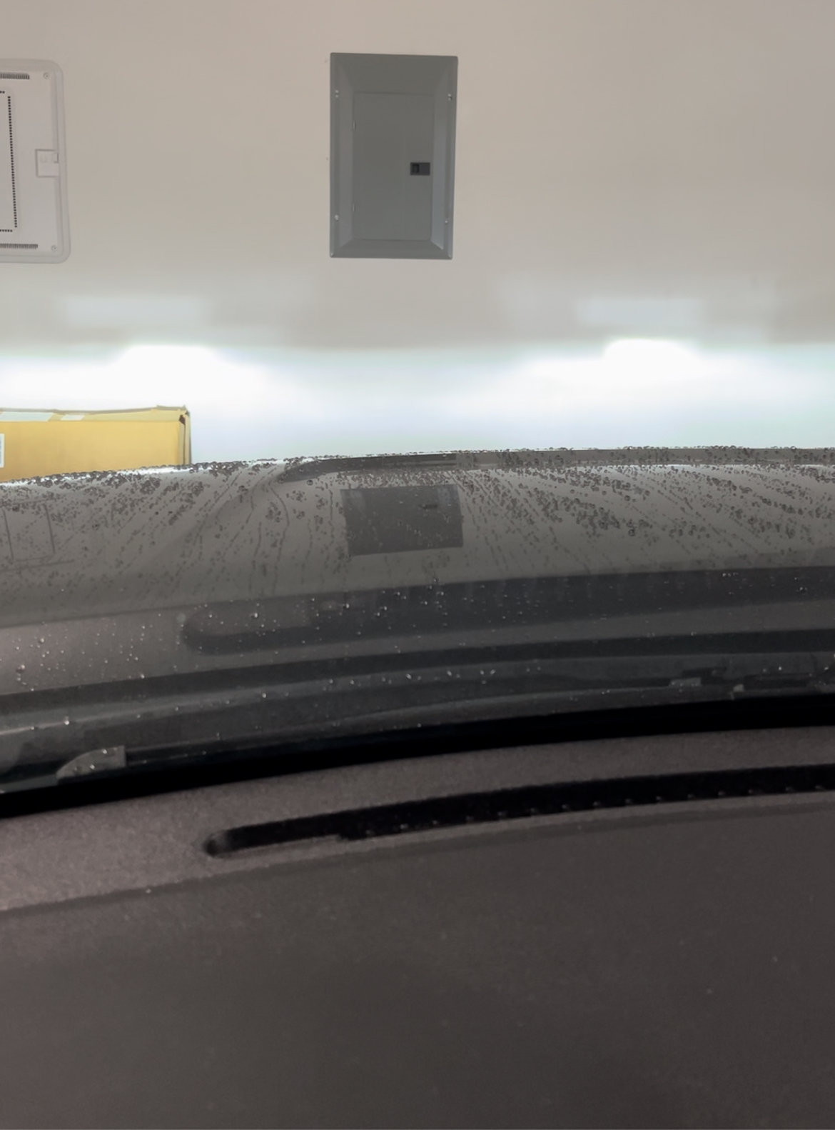

    Just completed the install of my TRD Pro black headlights and fogs on my 2015 supercharged Tundra Limited. It took around 6 hrs. over a couple of days, but I took my time. I'd first like to extend a special thanks to @iHacker for putting out a first class quality PNP product with fast shipping and great instructions. Much appreciated! Should have done this a long time ago, because the stock halogens were terrible. I've attached the before and after beam patterns and a couple pics of the new lights. I am real pleased with the result. Again, thumbs up to @iHacker for his harness.
    old beam pattern 1.png new beam pattern 1.png new lights day.png new lights night.png

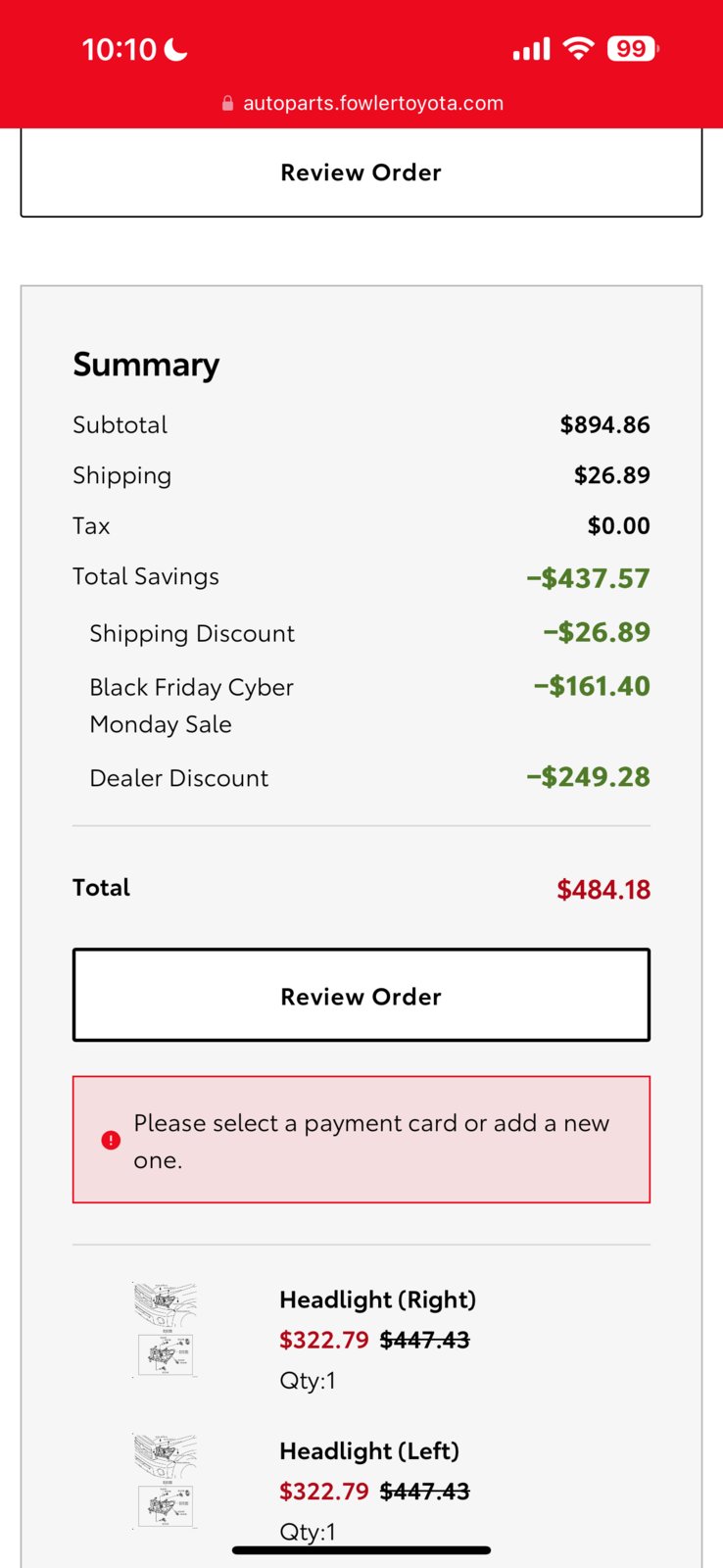

    I have a 2016 SR5 that I want to put 2019 black OEM LEDs in. I'd rather have DRL on all the time than run through the firewall. I'm pretty sure I have single amber DRL but it does look like there is a light strip on the bottom. I've never seen it on in the two weeks I've owned the truck though.
    What harness do I need? Also, any recommendations on where to get OEM LED lights?

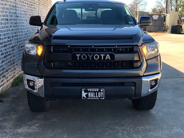

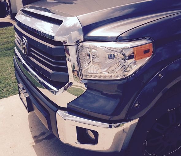

    2014 MGM DC SR5
    Message @iHacker about a 1lowlife setup.
    I didn't want the bright white LED strips for DRLs.
    Ask him if your 2016 headlights are like my 2014, and it sounds like they are.
    He can make you a plug-and-play adapter that keeps the amber DRL and turns on the upper and lower white strips on dim with the parking and headlights.
    If your headlights look like this, there is no LED strip on the bottom.
    5D7E009A-7757-4E27-94C2-C7981799DDA7_zps_ed3a583133cde85b62d92cffcc1fd1f2a41d2613.jpg
    E9F0D5CF-2127-42AC-B5EC-D61C8AB50038_zps_3b4b4a40c7fcc0810d9ee7c6dc4683242d428cca.jpg
    TRD Pro halogens.
    2018+ OEM TRD Pro LED headlights
    Daytime DRL
    Parking lights
    Headlights
    And welcome to the forum..

    Hello, welcome to the forum
    Your SR5 truck have a fake DRL strip but isn’t working is just an empty line without any LEDs and is just for looking only not a working LED strip.
    To get the LED strip on the new lights working as you describe I recommend using the Non dimming harness and you get constant power from the fuses box and the LED strip is switched with the ignition.
    For the best place to buy you can check Toyota Parts online site they are offering a thanksgiving sale in some parts you select the dealer where you decide to buy, I just checked and selected a dealership not too far from me and the price is really a great deal
    https://autoparts.toyota.com/
    I used dealership Fowler Toyota in Tulsa Oklahoma
    Part Numbers for TRD PRO black headlights
    Right Hand Side
    - Headlamp Assembly RH - 81110-0C211
    Left Hand Side
    - Headlamp Assembly LH - 81150-0C211

    Ok Good info guys! I ordered the lights from the dealer in town, less than $500 so thanks for that info.

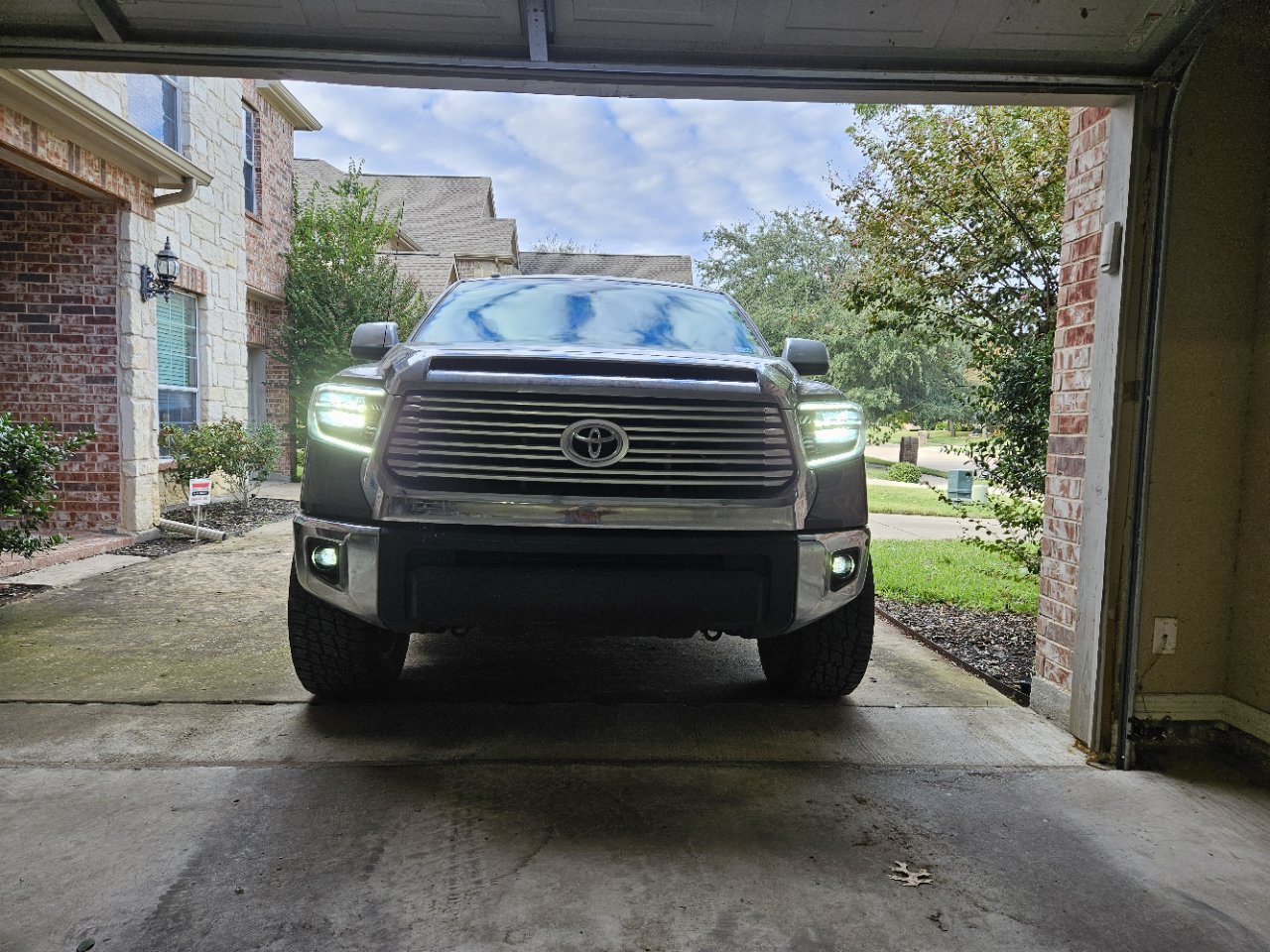

    Question - I've upgraded to the OEM LED lights... is the drivers side headlight supposed to dim after about a minute? It’s bright when I first crank up and then it dims after about a minute. Here’s two pictures I made this morning in my garage. First picture shows when I crank and put in drive- both headlights are bright. Then second picture shows about a minute later that the drivers headlight dimmed about 50%.
    I DMd ihacker, but wanted to see if anyone else had this issue before.

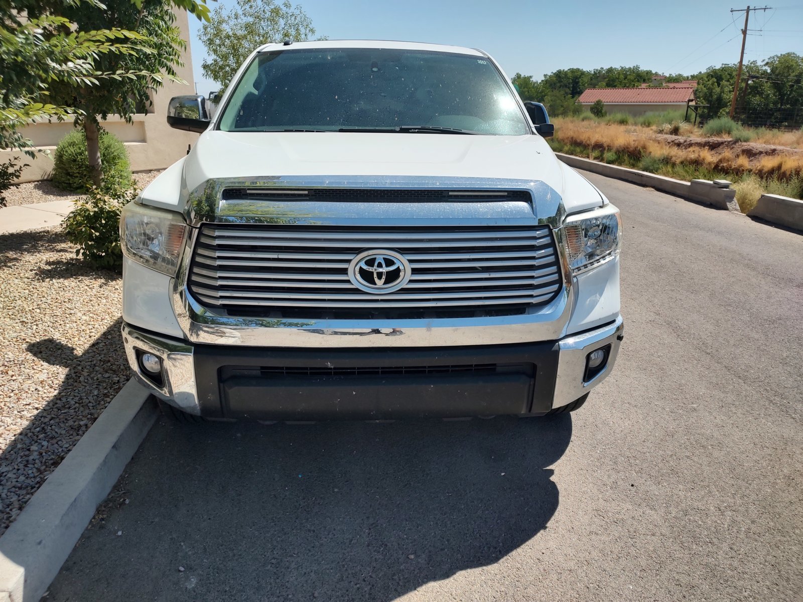

    Just joined. I have a 2019 SR5 and I’m looking to do the headlight conversion to the OEM LEDs.
    How do I get this Ihacker harness so I can install my headlights and what options do I have for the harness?
