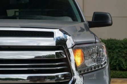

    Check first page on type's of harness. Do your current headlights have the LED DRL strip?

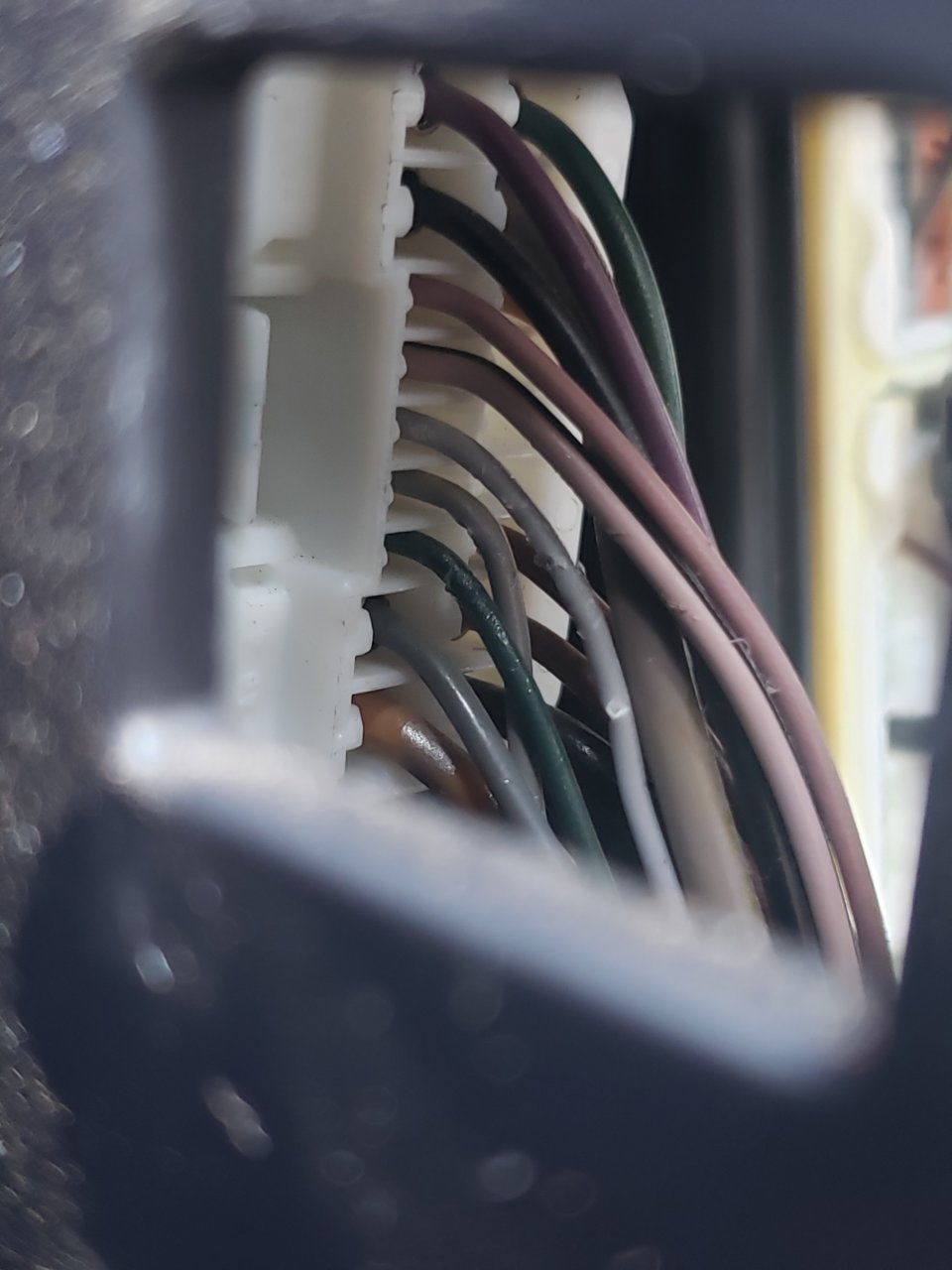

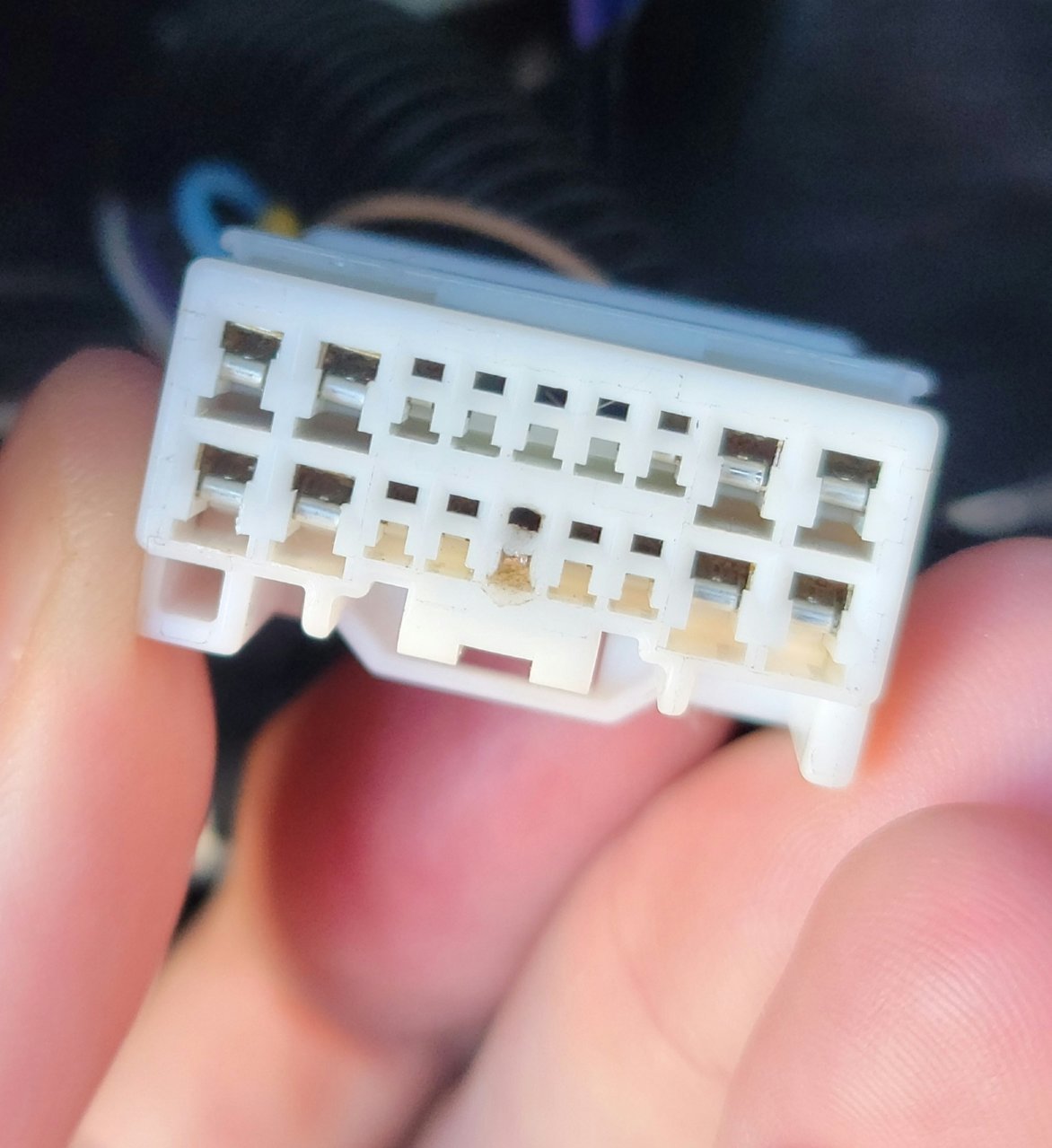

    Got the @iHacker harness last night and have been attempting to install it this morning.
    My 2015 SR5 has different wire colors than the ones referenced for deleting the amber DRL. I have multiple gray wires rather than the single gray wire shown in the instructions.
    Initially I just counted the number of wires and began trying to de-pin the corresponding wire but that's been such a pain in the ass (30+ minutes) that now I want to make sure it's even the right one. Any suggestions?

    I'd be more curious why the wires look burned...

    They aren't, it's just the lighting. The one gray wire that's chewed up is from my attempt and depinning it

    I may be wrong, and someone correct me if I am, but I believe that you have to unplug it and depin from the front of the connector (not the side where the wire goes in). Again, I haven't started my install yet, but I believe that's how it works.

    Yes that's correct. I just put it back in place temporarily to take a picture in the same position as the one on the directions

    Just count the wires it should be the 5th circuit wire and looks kind of chewed already in your picture, also you can use a test light.
    The correct wire should be 12V (+) with just the ignition and parking brake ON, after releasing the parking brake the wire should be (-) Ground

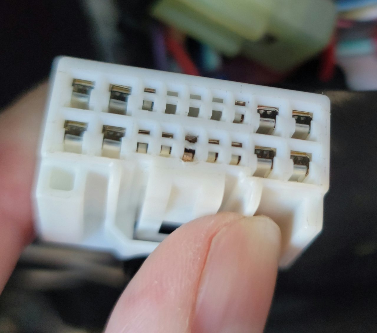

    Needing some help ASAP w/the depinning. I'm about to say F it and cut the wire before I screw the plug

    @Gav91183 see my post above. Was in the same place as you.
