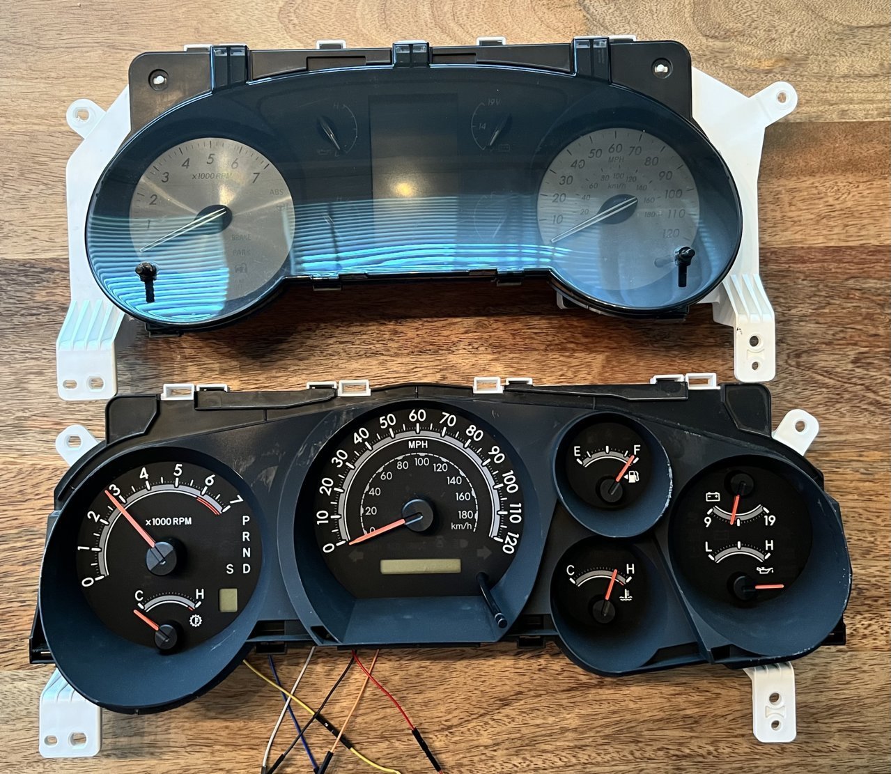

    Jeff, you seem to be the best one to answer this considering the amount of time you have spent on all these gauge clusters. Do the 2014-17 tundras and the 2018 Sequoia clusters appear to be the same size? I'm wondering if a 2014 tundra dash would fit behind the 2018 Sequoia bezel? If so that would Make the swap to the 2014 instruments almost plug and play with your wiring harness adapter.

    No the 07-13 Tundra and 07-21 Sequoia seem to be the same. I have a guy with an 08 Tundra wanting to go with an 18 Sequoia cluster. It should bolt right in. Making it communicate is another story.
    The 14-21 Tundra is a different shape, smaller in size.
