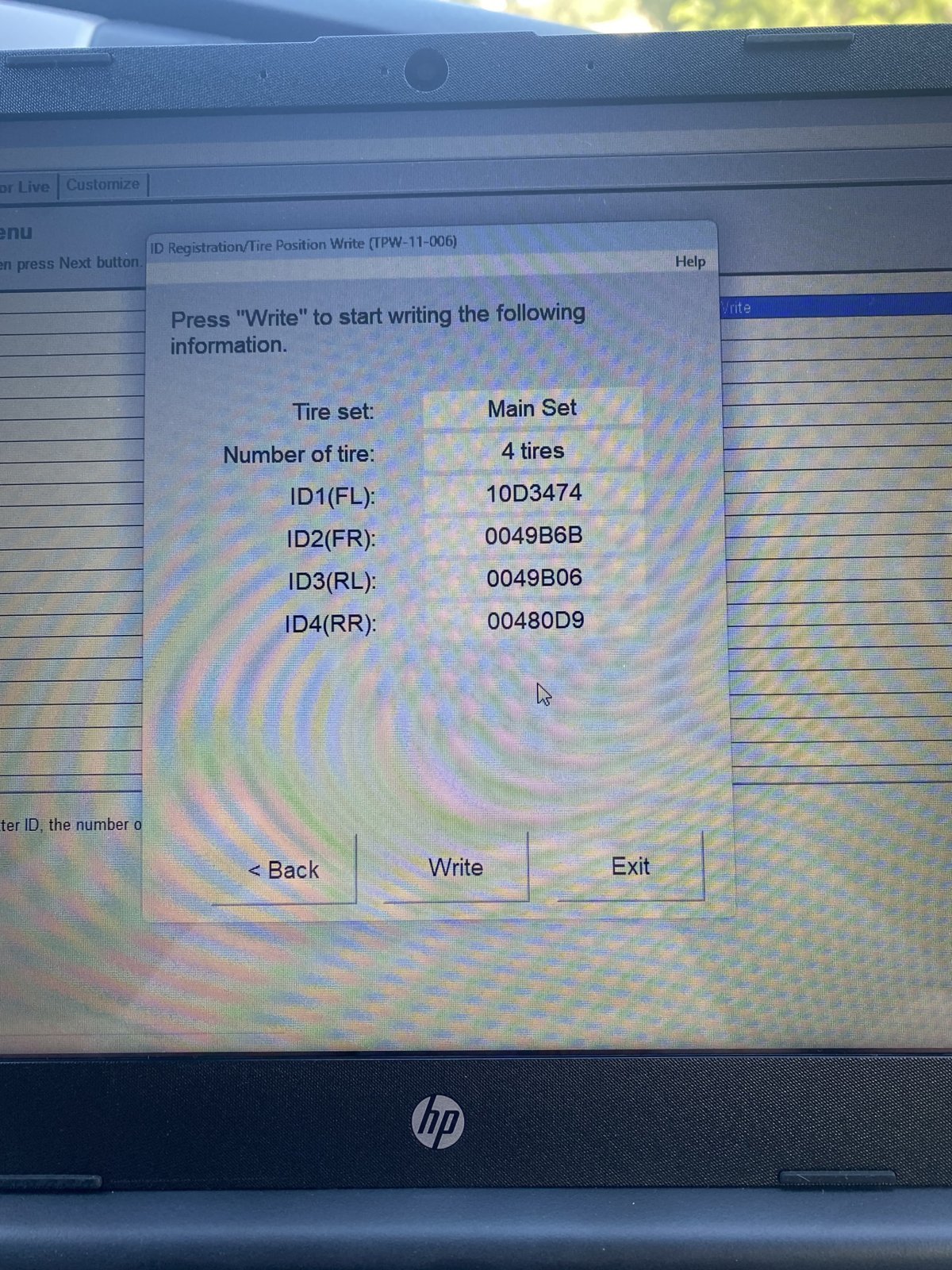

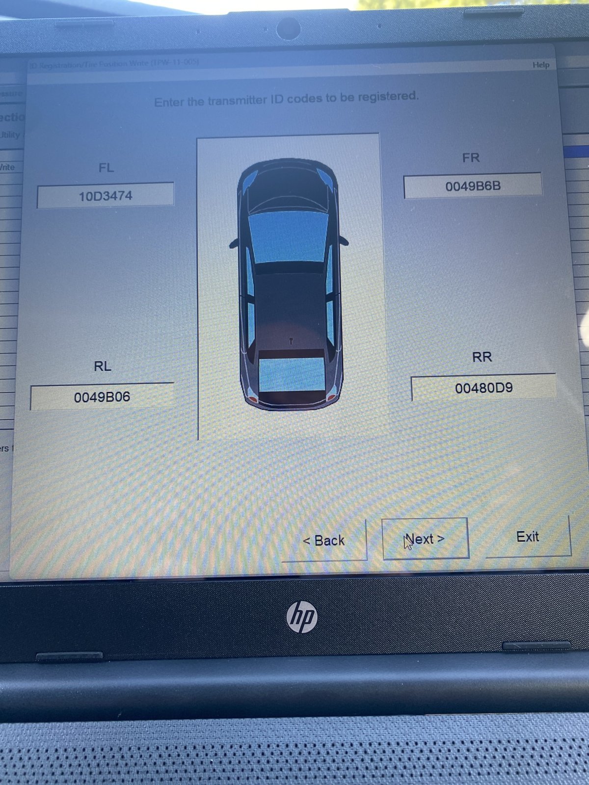

  6. Dec 16, 2023 at 11:36 AM
    #36
    Chad D.
    Chad D. New Member
    Feb 12, 2019
    #26010
    1,525
    Western Oregon
    2018 CrewMax Platinum
    I can only see four tires, and am unable to add a fifth like you show in your photos. My truck is a 2018 CM Platinum. And, I do not have 5 TPMS yet. New wheels and tires are not installed, I was just trying to get in front of this if possible.
    See my screenshots below:
  7. Jun 16, 2024 at 6:54 PM
    #37
    Chad D.
    Chad D. New Member
    Feb 12, 2019
    #26010
    1,525
    Western Oregon
    Bringing this back to the top. Sensors are in my 5 new wheels, but only 4 are registered to the truck.
    I’d love some help getting the 5th one recognized by my truck via Techstream, as well as showing on my dash.
    @Jeff_5_7 are you still helping with this?

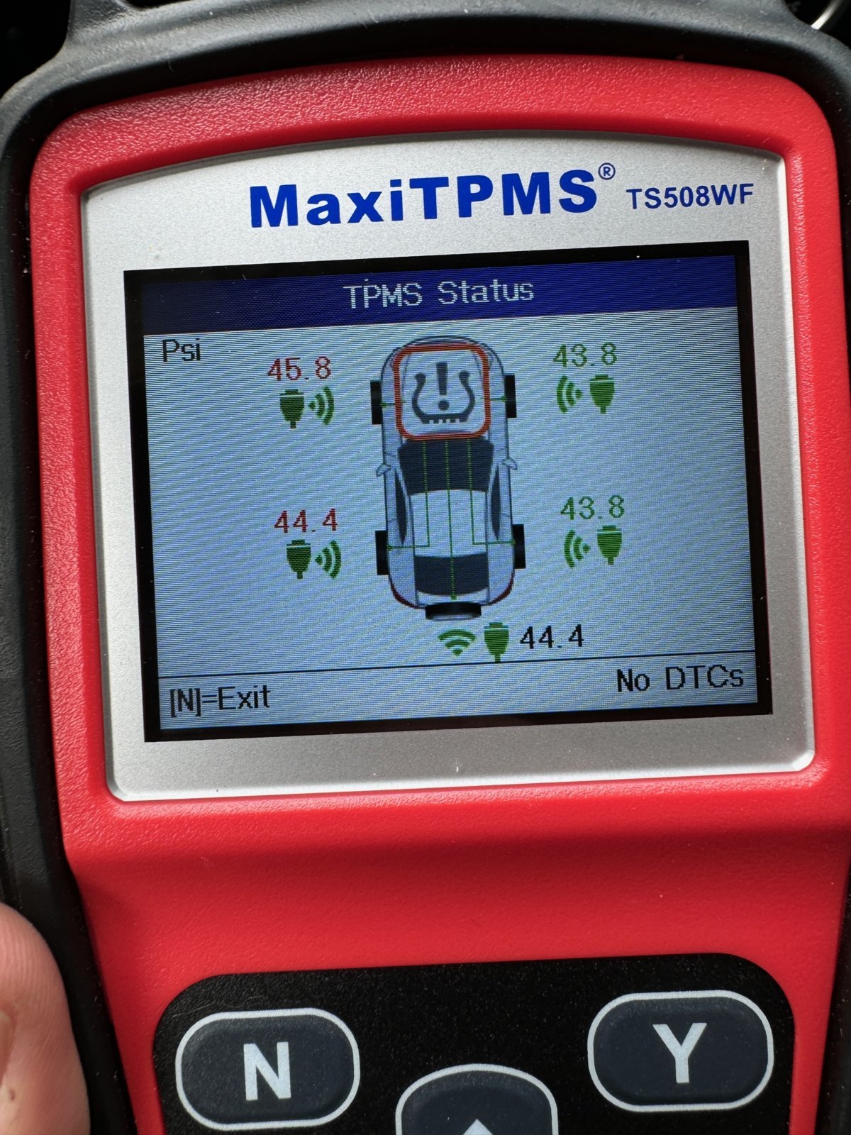

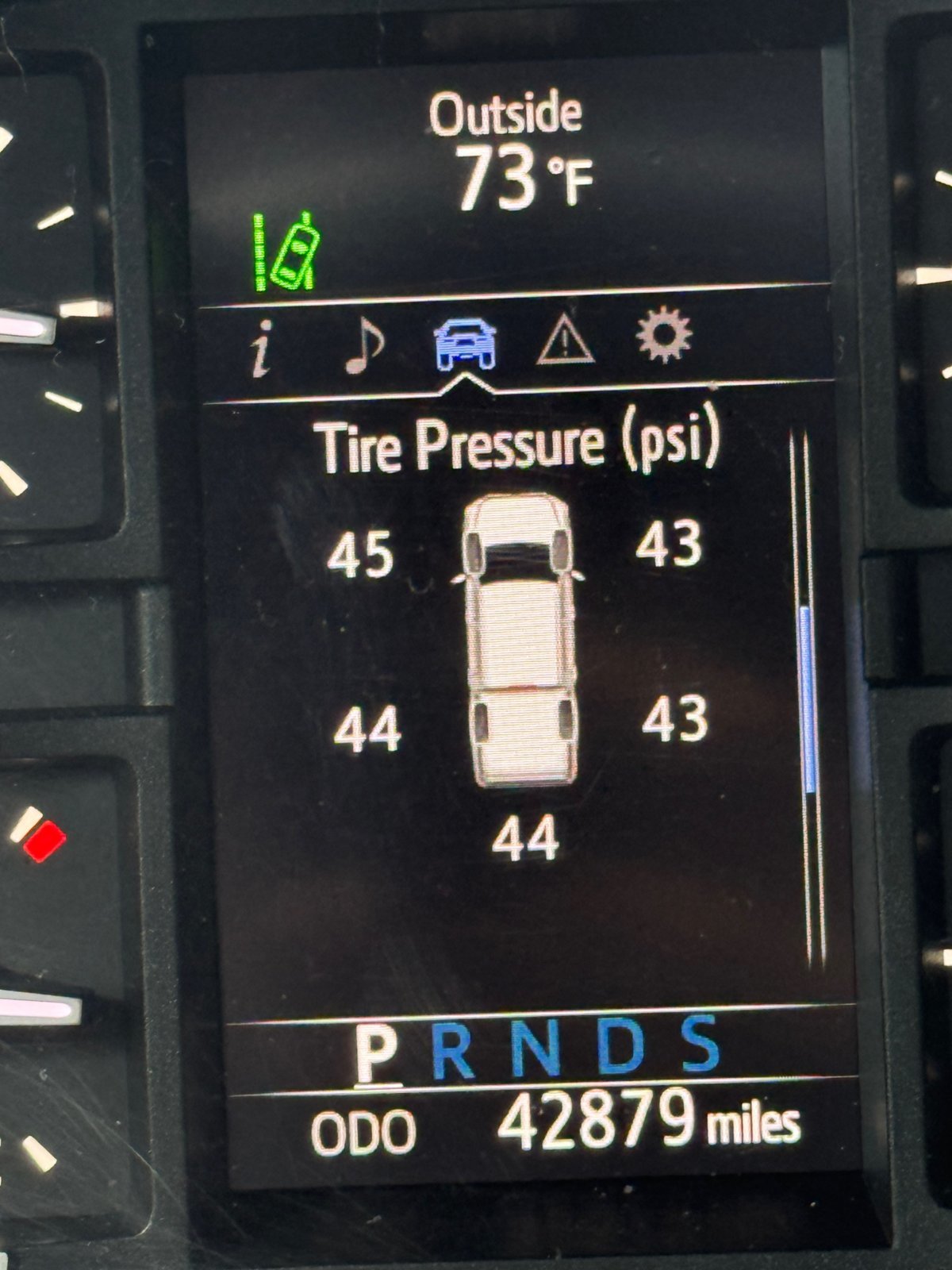

  21. Jul 8, 2024 at 1:41 PM
    #51
    roughfisher
    roughfisher Aggressive hockey is back in town!
    Feb 27, 2021
    #59698
    211
    JP
    Northern Minnesota
    2021 MBM CM SR5 TRD OR 4x4
    @Jeff_5_7 and @azTony @TRDFerguson @Chad D.
    Fellas, I think I stumbled into something...
    I rotated my tires yesterday and discovered a secret unlock!
    I bought an Autel unit this spring as I was sick and tired of having to go to walmart to perform an OBD relearn for my TPMS every time I rotated my tires because the relearn button under the dash doesn't do shit except stay stuck in recalibrating mode with aftermarket TPMS sensors. So I go through the OBD relearn procedure on my Autel and scan all four tires and the spare. The displays on the unit prompts me and asks if I want to add the spare. I've followed this thread from the beginning and figured why not, nothing was probably going to happen anyway without using techstream and Jeff's hacks. Low and behold I was shocked when the spare was added to my display. the million dollar question was going to be if my speedo calibrator would still work since Tony's became non functional after his mod was done. I tested my speed with two different GPS and a couple of radar monitored speed zones and every one of them displayed the same readings as my speedometer. So I don't know what the hell the Autel unit told the ECU but I now have a displayed tire pressure for my spare and a functional speedo.
    ericmunns and Tundra-XP like this.
  22. Jul 8, 2024 at 1:45 PM
    #52
    Jeff_5_7
    Jeff_5_7 [OP] New Member
    Feb 20, 2021
    #59378
    1,443
    Jeff
    Houston Tx Area
    2007 RCSB 2014+ TRD Pro Conversion 5.7 4x4
    Full 2014+ Conversion Regular Cab Short Bed 4X4 2019 TRD Pro Grill, 2014+ Front End Swap 2014+ Interior/Dash Swap with TRD Pro Leather Seats, 2014+ Bed Swap with TRD Pro Stamping SOS 2/4 Drop Kit
    It turned on the 5th TPMs sensor the same way I do. There is only one way to enable it.
    Also nice proof it has no effect on the speedometer calibrators. I have though from day one the 5th tire addition should have no changes to the speedo calibration operation.
    coTony and roughfisher[QUOTED] like this.
