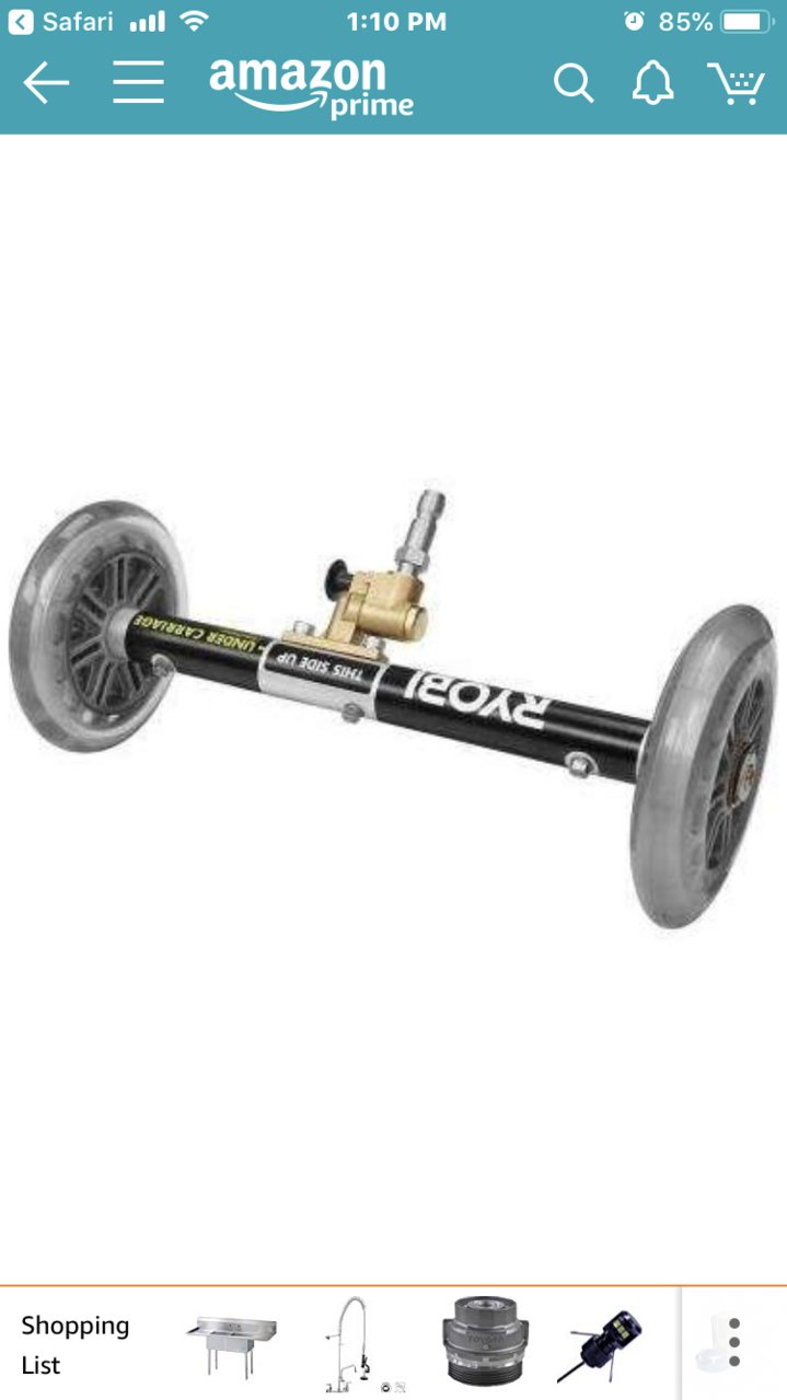

    I recently bought a Ryobi under carriage/floor power wash sprayer accessory. Home depot. 43$. And extension wand. Picked one up and LOVE it.

    Vermont
    2018 White Platinum CM
    Brilliant!!! I'm going to get one of these. Thanks.

    I'm seriously considering buying something like this. The one I saw looked like the spray was way too wide though and didn't have much power left once the water actually hit the underside of the truck. How has this one been about removing mud and dirt?

    From another forum I belong to where they were taking about the HD deal on the Ryobi water broom:
    “used mine today with a 1900 psi 1.3gpm karcher... it just moves dirt... doesn't clean like a regular head does.... i guess i need a gas one to make it work properly”
    Sas[QUOTED] likes this.

    Hmm, I may just build my own at some point then and use nozzles with narrow angles.
    JoshuaA[QUOTED] likes this.
