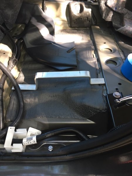

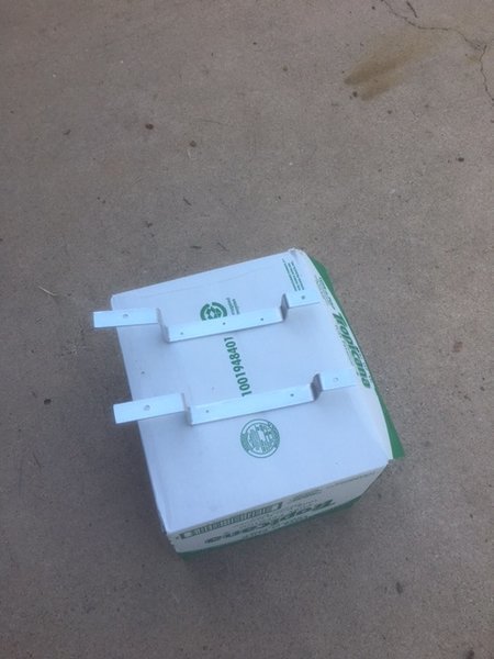

    Step 3. I decided to mount my amp under the driver's seat and my LCQ-1 under the passenger seat. Since both required seat removal and center console removal (to facilitate wire routing) I decided to take the plunge and do it all together, so on Saturday morning I started the work...
    The amp required a mounting bracket, so the first step was to figure out the exact location and fabricate the mounts. Before I had completely removed the seat, I placed the amp in position and figured out how much space I needed. I pretty much eye-balled it and figured an inch stand-off from the carpet would clear the floor heating/cooling vent and still give me enough clearance from interfering with the seat mechanism at it's lowest setting. I used some aluminum bar stock from Lowes to fab the brackets...
    I finished the first one (always the hardest) and duplicated a second, then finalized the location to avoid interference with the vent.
    I spent a fair amount of time checking underneath the floor to make sure I wouldn't be drilling into anything but structure.... Then I took the plunge...
    With the brackets formed and installed, I needed to make a few cuts inthe carpet to make sure everything would lay flat and look right...
    Next, Time to paint the brackets and finish the mechanical installation...
    Now I needed to find a spot for the amp ground cable attachment. The nice engineers at Toyota were kind enough to include a pre-threaded 10mm bolt hole in the driver's sill trough. So I made sure I had the bolt that worked (same bolt used for the license plate mount) and sanded off the finish so I would have a solid ground connection...
    Next step was to make all the wiring connections, re-position the carpet and be done with the Amp install. I ran the RCA input cables and the amp output lines over to the LCQ-1 and the J144/145 harness adapters. I also routed a subwoofer wire back to the rear seat area. Not sure which side I'm going to install the sub on, so I included enough wire on the end to reach all the way to the right rear seat location. Then I coiled it up and stashed it under the left rear door sill cover.
    I used self-adhesive tie-wrap anchors to help organize the routing. I like to keep the wiring neat.
    Amp installation complete!

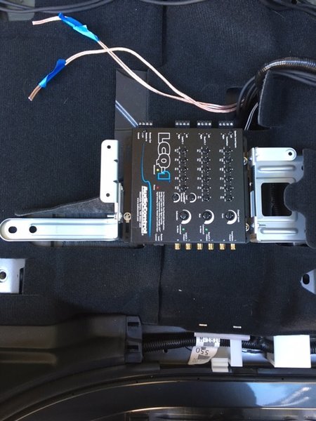

    Step 4: LCQ1 installation.
    The LCQ1 is a Line Out Converter (LOC) and Equalizer (EQ) all in one nicely engineered box. It is desiged to take amplified outputs from the Head Unit (or factory amp) and adjust them to line level inputs for the after-market amp. It does a lot of other things as well including Bass Restoration with adjustable trigger threshold, channel summing (for full spectrum audio to the crossovers), remote turn-on input from HU and send to amp, and of course, EQ.
    I did a lot of research to determine the best way to install this and whether or not to keep the factory amp. It turns out that the center dash speaker, front dash tweeters, and rear door speakers are fed directly by the HU and do not go through the factory amp. These feeds are wired in parallel through the factory amp which feeds the Front door speakers and rear tweeters. I have no idea what useful purpose the amp serves other than to provide a place to plug in J144 and J145. So since there is full spectrum, gain level audio coming out of the HU, I decided the factory amp would create an unecessary noise source in my audio chain and take up precious real estate under the passenger seat. I've seen some write-ups where people experienced noise or "hiss" problems using the factory amp in the chain. I believe removing it is absolutely the right answer.
    So the factory amp is out! The brackets, however are another story, and were quite useful for the LCQ1. The LCQ1 has mounting tabs built into its case but is a little over an inch wider than the factory amp. No problem. I added aluminum angle to the factory brackets to provide mount points for the LCQ1. Then I drilled a new mount hole in the aft factory bracket in order to reposition it for the extra width. This provided a nice sturdy easy mount with no need to modify the carpet.
    Once the mount was taken care of, it was time to do the wiring. I didn't want to modify the factory harnesses, so fortunately there are adapters to take care of this. J144 is a 10-pin connector and mates with the 10-pin connector in the Metra 70-1761 harness kit. (Provided to me, free of charge from Crutchfield). The 12-pin was another story entirely. I spent a tremendous amount of time trying to find a matching connector. I eventually found the toyota part number for the male mating connector, but the shell plus all the pins and wire leads would have been about 70 bucks!!! Crazy talk. So with much googling and researching, I stumbled on the solution.
    I found the part number (Y-TYT02) from a company called Apps2Car. It's a "Y" cable with two 12-pin male connectors for $9.99 on Amazon! So I cut one of the connectors out of the "y" and had my mating connector.
    Next step was to wire up everything to the LCQ1 and amp wiring and test it out!
    After rocking out to some amped/EQ'd Garth for a few minutes, I declared success and straightened up all the wiring and carpet. Next step... The Sub...
    One additional comment... My configuration maintains the existing dash tweeters and center speaker. They are fed independently by the HU and are not wired down to J144/145. So I have an 11-speaker system plus the sub when it's installed. if the dash speakers cause a problem when I do my final EQ I'll just disconnect them and leave them in place. I don't believe they will cause any problems at this point.

    The Audio mod is finally complete. I finished up the Sub-box build this week and installed everything today.
    I really wanted to mount the sub behind the passenger side rear seat. The passenger side seat is smaller and therefore easier to remove and reinstall, but the tire jack equipment is mounted under the seat on that side and I didn't want to relocate it. There are also existing mount points on the driver's side rear cab wall. I think the JBL-equipped trucks use these for the factory sub mounting. So I went with the driver's side, even though it was a harder installation.
    As a side note.... The first mod I made to this truck was the ESP under-seat storage locker. It mechanically interfaces with the rear seat mounts to lock into the floor. However, to do this, the seats must be manipulated a bit to the rear and then they slide forward into the locker mount interface. This means that to accomodate the seat installation, the sub box needs to be even more shallow because the front surface and speaker face need about an inch of clearance behind the seat back. Unintended consequences of multiple mods! A bit of a pain, but worth it.
    I mounted the box using external angle brackets into the floor and I also used a 6mm bolt through the back of the box into the factory mount point on the back cab wall.
    I gave everything a quick ops check and then re-installed the rear seat. I'll tweak the final EQ sometime this week, but it already sounds great. I'm very happy I decided to do this mod. Now I can start focusing on my FRAC-AV video mod!

    question- I see you have speaker wire with blue tape on it, where does that come from/go to?
    also do I even need to pull the head unit and splice into anything in the back HU harness or are all the door speakers fed from the factory amp for me to just splice from there?
    thanks in advance!
    -Joey

    Thanks! And thanks for asking your questions, it made me realize that I didn't provide a very good description of the final wiring configuration.
    The speaker wire is carrying the Amplified Audio signals from the Amp (Under the Driver's Seat) to the appropriate J144/J145 adapter connector pins for distribution through the factory harness to the Door Crossovers/Speakers.
    No need to mess with the Head Unit or cut into the factory harnesses under the passenger seat (as long as you are using the adapters)!! That's the beauty of this installation! J144 is a 10-pin connector and mates with the 10-pin connector in the Metra 70-1761 harness kit. J145 is a 12-pin connector and is one half of a "Y" cable, part number (Y-TYT02) from a company called Apps2Car.
    All the signals you need flow through the two factory amp connectors under the passenger seat! (J144 & J145).
    See the pinouts and connector diagrams below ...
    The "wire color" column indicates the factory harness wire colors so you can be sure what signal you are working with - the adapter connector wires may have different colors in some cases. That obviously doesn't matter, just make sure you are connecting the proper adapter pin/wire to the signal in the "connects to" column. PLEASE NOTE: if you are using a different LOC/EQ and/or amplifier, reference the "Factory Signal" Column to make sure you are routing signals properly according to your equipment configuration.
