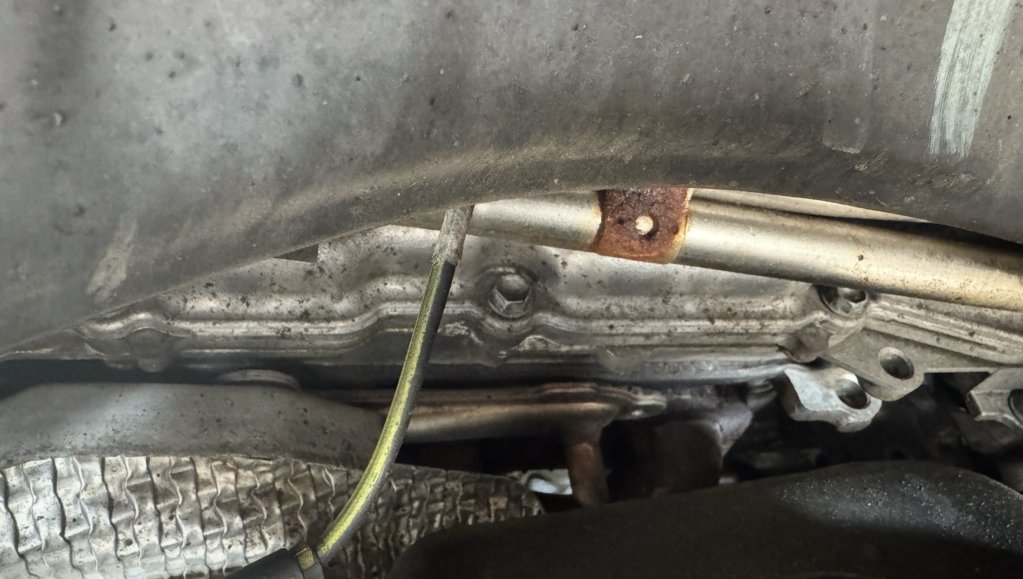

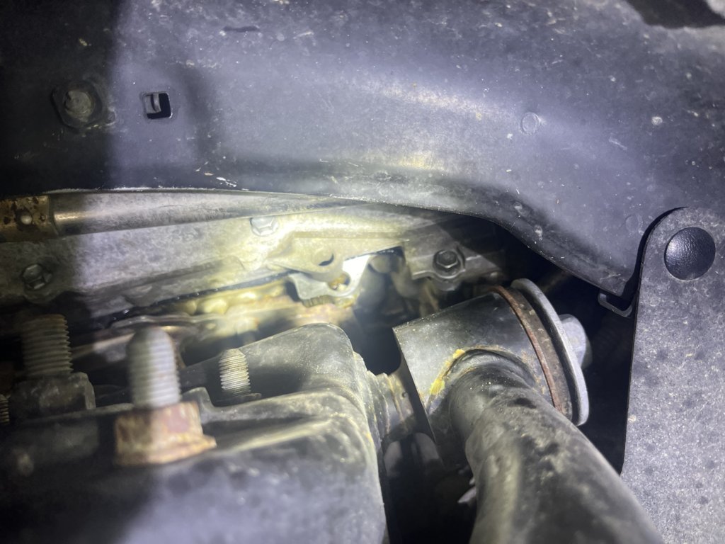

    I believe I have a cam tower leak. Compared my truck to my brothers and his is clean as a whistle…mine has some obvious oil residue along gasket area viewed from front passenger wheel well. Brought to a local dealer months ago when I suspected it and they said that the engine was just “sweating” oil….pretty crazy terminology for a professional mechanic huh?? So obviously I won’t be going back there. My extended warranty guy said they cover it…& he actually used to be a Toyota mechanic and said they do plenty of those fixes….but I should research dealerships in my area who have successfully done the fix because I want it done right. Truck has 64k miles and my warranty is good through 121k miles or 9/30….so I’m in no rush.
    Anyone ever have this done and how do you find a reputable dealership and know the dealership will do it right?

    If you just have residue and it’s not actively dripping, I probably wouldn’t mess with it if it were mine. I have a 2016 and had the left cam tower resealed using my Toyota extended warranty and probably should have left it alone. I think you’re better off not tearing into the engine unless really necessary. I found one of my bolts just sitting completely loose not even hand tightened, and discovered quite of bit of wire wheel debris (from them removing the old seal) on oil changes and in oil filters for at least 3 or 4 oil changes after the procedure was done (a common occurance from other people I’ve heard have the work done). In retrospect my engine would have probably been better off with leaving the minimal leak well enough alone. Just my thoughts. YMMV

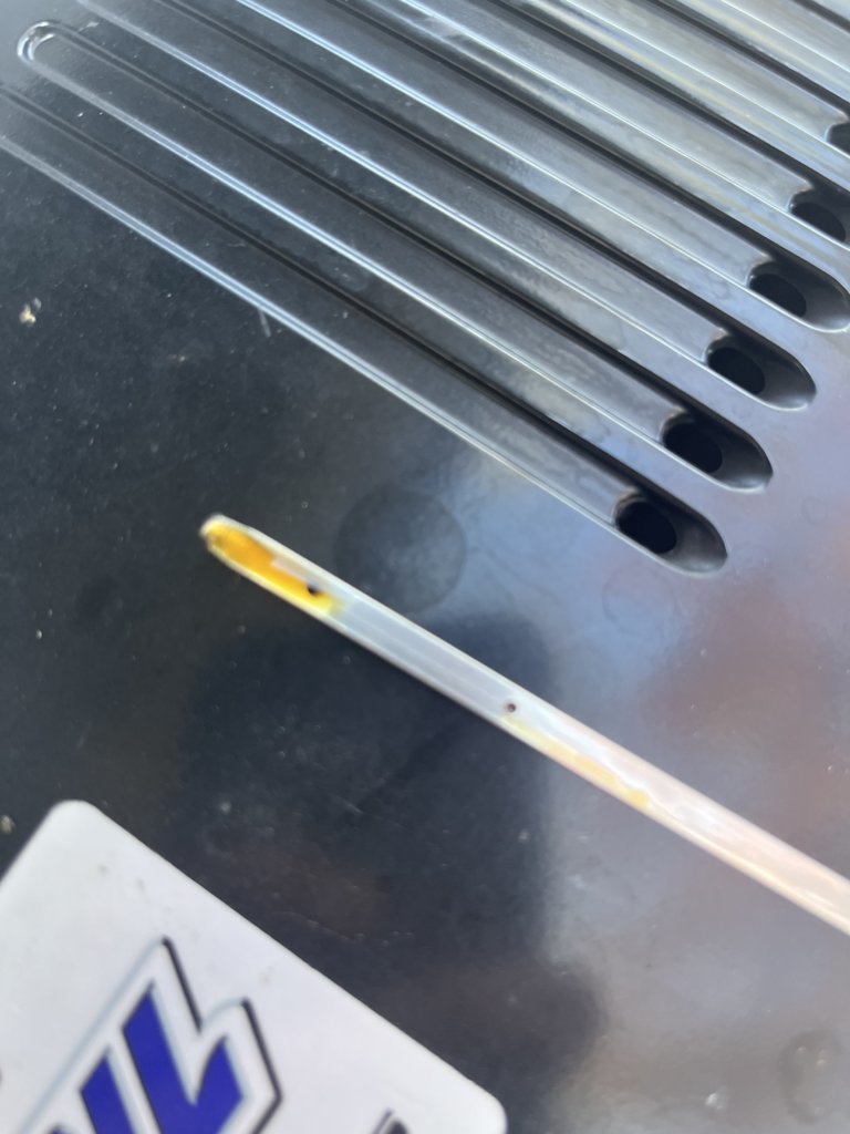

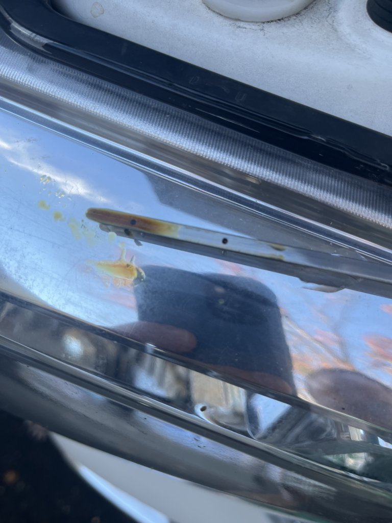

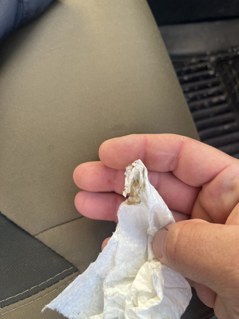

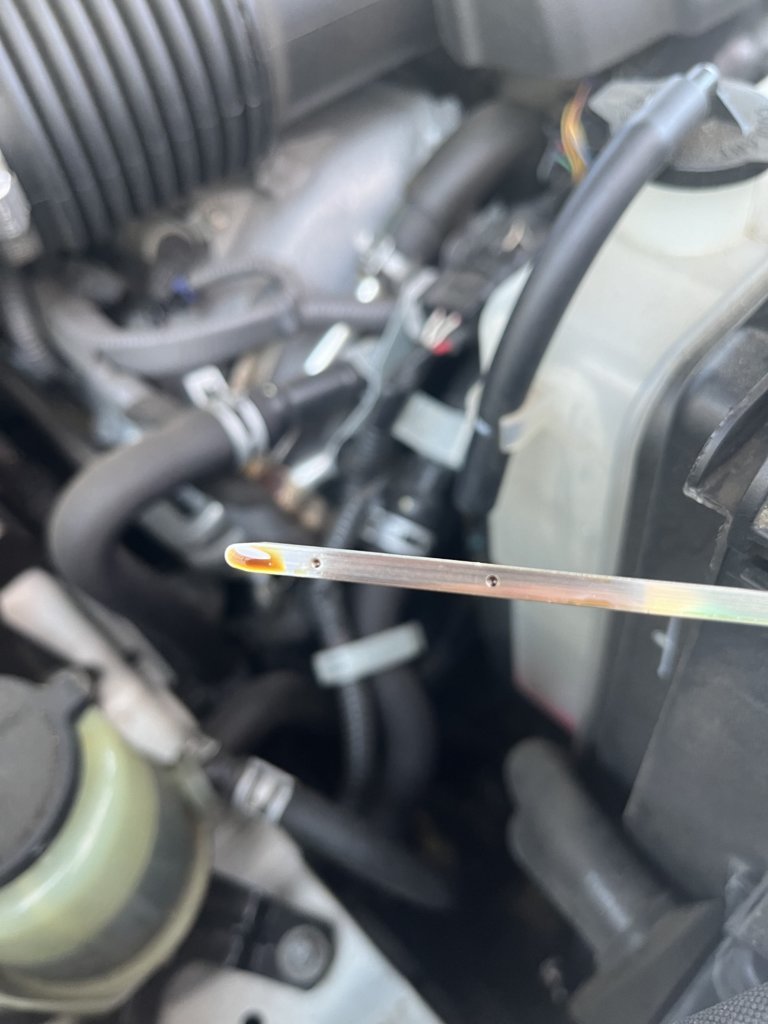

    Looks like I may be contacting Turnersville Toyota to fix my cam tower leak! I havnt been keeping an eye on it too much but when I checked my dipstick 2 days ago the dipstick was bone dry!! I added 2 quarts of oil!! Below pics are after adding 1/2 quart, then a whole quart, and then adding a second whole quart. Low oil light never came on. Cam tower appears to have a drip. I have an appointment tomorrow at Gateway Toyota…last time they looked at it they said it was the “engine sweating oil”….so I don’t have confidence in them doing a cam tower fix.

    Doesn't look like a 2 quart leak? Most I've seen leak minimal.

    I added 2 quarts and it took the level up to mid way between the 2 dots on the dipstick. I didn’t notice any on the ground where I usually park it though.

    Update. Truck is done and will pick it up tomorrow AM. The Triton extended warranty covered the $3380 bill. Hope they did it right. Is there anything I should keep an eye for if they botched it?

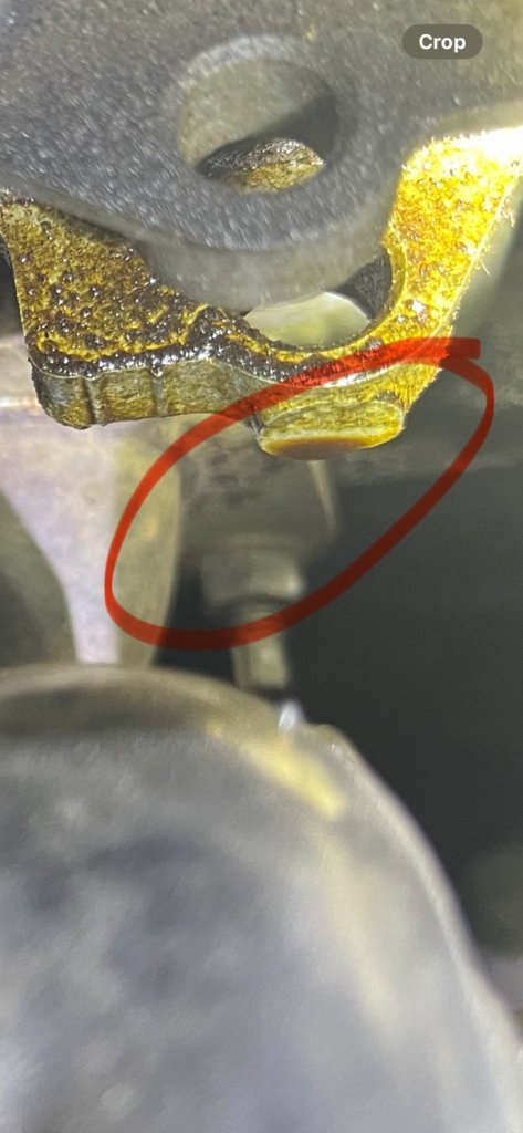

    Just picked up truck…tried charging me for oil change labor and other half of $175/hr diagnostic fee….told him I should not have to pay for those 2 things…he went to manager n got it waived. So I only paid for oil filter and $100 warranty deductible.
    this is what it looks like….i see the black caulk. I don’t like the oil residue I see on the bottom of the rounded plate…figured this would be clean and bone dry….so I will keep an eye on it and let warranty company know.

    I whose under the 30,000 mile warranty and Toyota said that it's a weep and wouldn't fix it. But said when it becomes a wet spot they will fix it under warranty regardless of mileage. That looks like a fix is required.

    just seeing the update now. I'm 99% sure mine looked the same. I'll check tomorrow and report back. The black caulk looking stuff is good to see, means it was fully sealed. I believe them not using enough originally is how the leaks started.
    I agree they could've cleaned it up a little better but it's luck of the draw based on the tech and dealership I suppose.

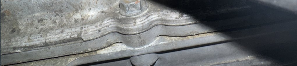

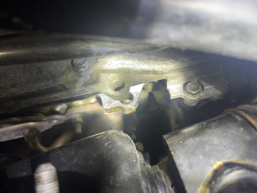

    Screenshot 2024-11-18 at 12.43.49 PM.png Screenshot 2024-11-18 at 12.43.40 PM.png Screenshot 2024-11-18 at 12.43.30 PM.png
    Took photos about an hour ago. Definitely not as thick as yours. Not sure what to think lol but mine's been solid since they re-did it.
