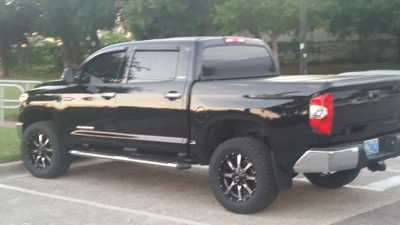

    After 2000 miles it was time for some upgrades.
    Bilstein 5100 middle setting, w/ 2 CB shims per side 1.5" toytec aluminum blocks
    295/60/20 Toyo Open Country AT2s
    Moto Metal 970 20x9 +18mm
    Undercover Flex fiberglass tri fold bed cover

    looks good.
    any tire rubbing in the front? did you have to modify or remove anything for clearance? how is the alignment?

    I think the rubbing I experienced is typical of this size tire and wheel. Removed front and rear mud flaps this cut down on most of the rub. Just rubs in front of wheel in reverse, will do wheel well mod when I get time.

    Don't forget to re tighten the u bolts to the plates after a couple rides and again after about a week or two. Had to do the same after installing 1" blocks myself.
