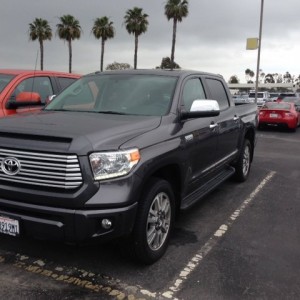

    Gentlemen: Finally made the jump to a truck as I need a work horse tow rig/parts hauler for my idiotic race car habit. This thing will be bruised and beaten, but needs to be utile enough for a daily (ie: get into parking garages in Los Angeles, ride reasonably well)
    What I have:
    2015 Platinum Tundra in Gray, 2WD
    What I want:
    A car that doesn't look like it's used to run kids to soccer practice, but still works as a daily
    Here are my thoughts, any and all help really appreciated:
    • Suspension lift for road use (0% offroad). How high can I go and still get into parking structures, and what do you recommend without braking the bank?
    • TRD Pro grill
    • Fender Flares (don't seem popular here?)
    • Wheels/Tires to match suspension lift and flares (any recommendations?)
    Car is in LA; any shop/parts supplier rec's welcomed as well.
    Obligatory pic below:
