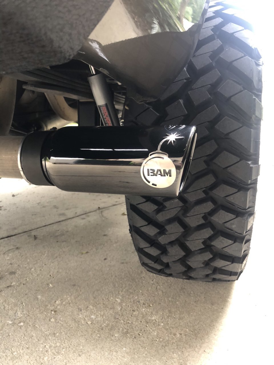

  26. Apr 17, 2021 at 5:26 PM
    #26
    SCBobKat
    SCBobKat Lov'n the Tundra life.
    Jan 9, 2021
    #57333
    9
    Rob
    Moss Landing, CA
    2017 BlzBlu CrewMax
    Grille w/LED Bar, Rolln'Lock Tonto. Yakima racks, UnderCover Swing boxes. AJT Interior upgrades.
    Love the Tundra forum...when you get frustrated, someone else has a fix already. Found the OEM black chrome tip on Amazon for ~$60. One more step done in the de-chroming of my whip. 20210417_171740.jpg
    TS1794 likes this.
