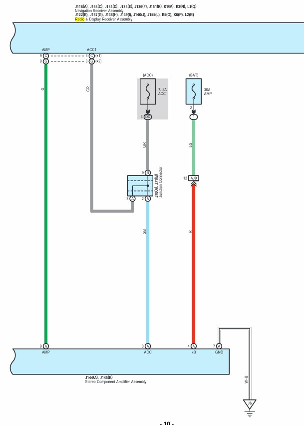

  6. Mar 29, 2025 at 8:56 PM
    1lowlife
    May 4, 2016
    #3296
    10,709
    DADA
    THE GREAT STATE OF TEXAS
    2014 MGM DC SR5

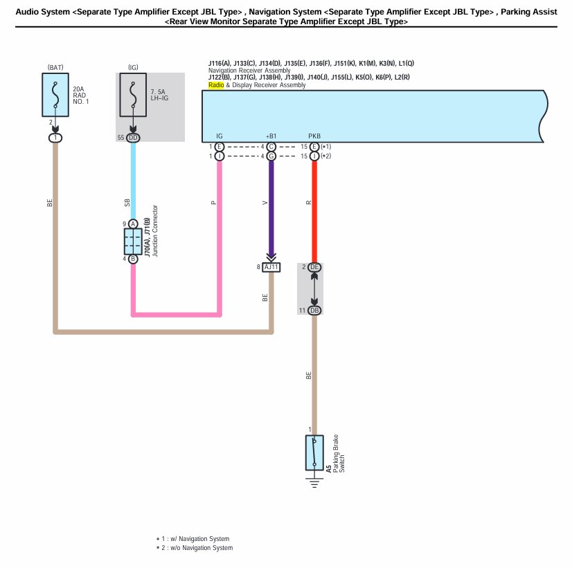

    No, they are wired and function differently..
    If you know wiring diagrams, you can find them here..
    Ultimate TUNDRA Wiring Diagrams Collection | Toyota Tundra Forum

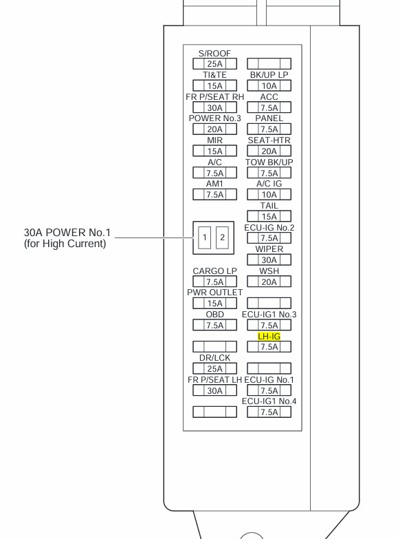

    Make sure you check the LH-IG fuse, although if it was blown more stuff wouldn't work.
    You'll find it in the underdash fuse box.

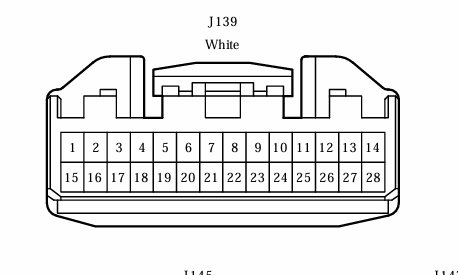

    I'd get your multimeter out and start testing the radio plugs for current.
    There are only 2 wires to test, each in its own connector on the back of the radio.
    The battery RADIO feed is the violet wire pin #4 of the J137 connector
    The IG (key on) wire is the pink wire in pin 1 of the J139 connector

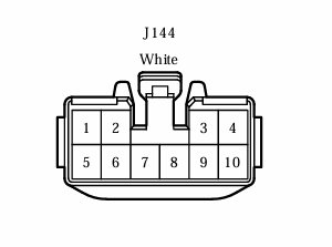

    I doubt it is an issue with the amp..
    But the wires to test at the amp are both in the J144 connector under the passenger seat.
    ACC (key on) wire would be the sky blue wire in pin 3
    The battery AMP wire would be the red wire in pin 4
    It would be good to at least test the radio wires so you'll know it getting power.
    Then you'll know the radio is shot.
    Several options for aftermarket radios, although you'd need to bypass the OEM amp to install one.
    Perhaps you can find someone with an OEM replacement radio.
    Good luck..

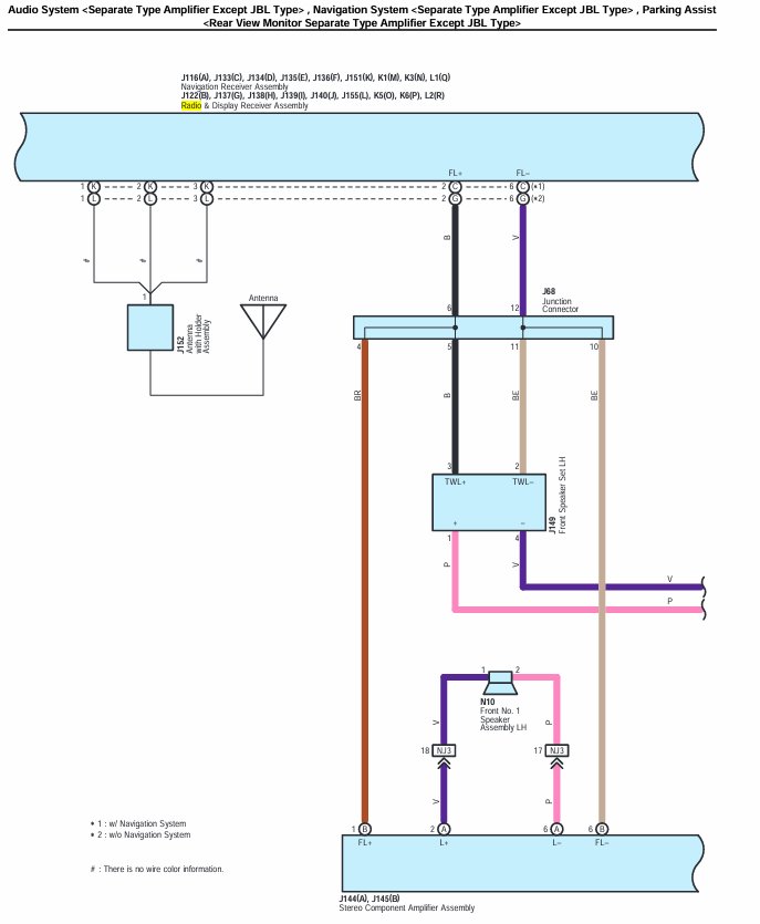

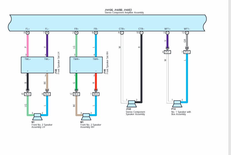

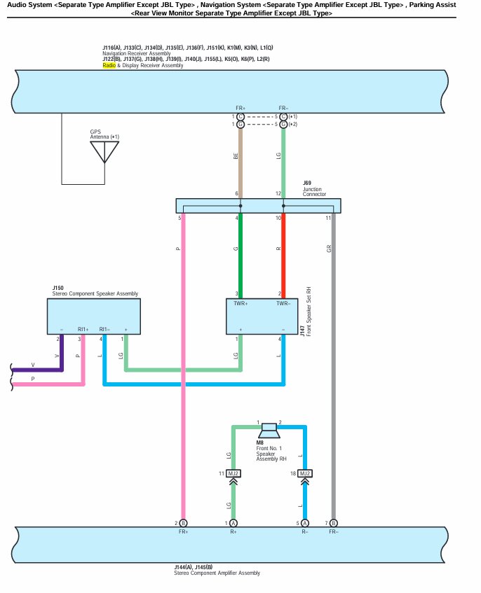

    No, the truck wiring is different.
    For example;
    On the JBL, all speakers are powered by the underseat OEM amp.
    CTR is center dash, as well as the sub output to the woofer.
    On the non-JBL, the dash, center, and rear door tweeters (crewmax) are powered by the HU (radio).
    The doors are powered by the OEM amp.
