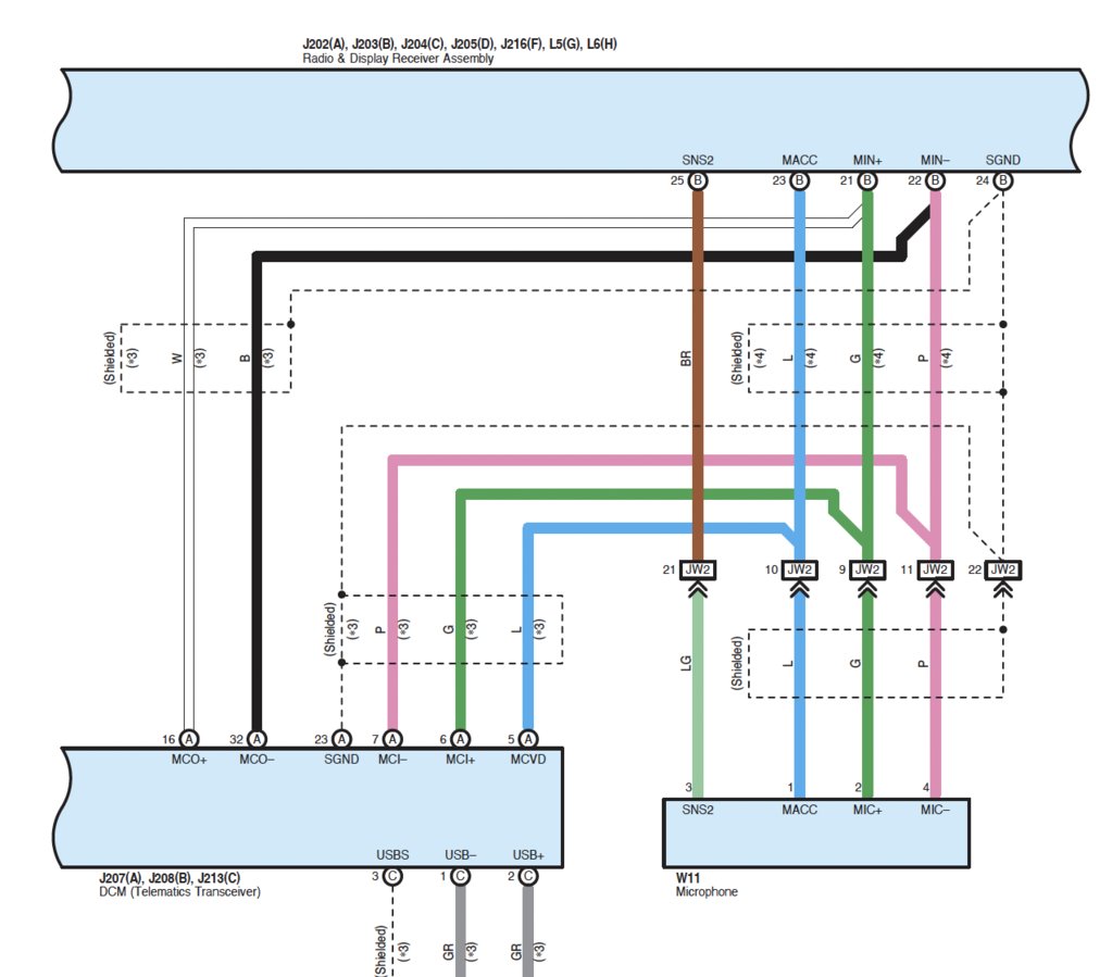

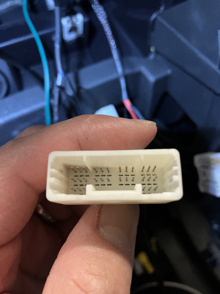

    I am guessing that one of the mic lines may have been damaged or may have a loose or bent pin or some other issue. The mic assembly feeds the Head Unit directly through pins 21-25 of the 30-pin connector that the FRAC harness uses. I would check those lines for any damage or loose pins. Let me know if you see any issues with those pins or wires. In the factory harness 21 should be green, 22 Pink, 23 Blue and 25 Brown. 24 is a shield.

    I don’t think that’s the case on the trucks with DCM.
    My experience with these diagrams is “either/or” when they have the option numbers on both sets of wires.
    I’m fairly certain the mic goes only to the DCM (three wires plus shield) and then the DCM sends mic output to the HU on pins 21/22 (plus shield).
    That said, the wires at the HU connector themselves are all the same either way, and the FRAC jumper harness would simply pass those through.
    I would agree that it sounds like a loose or damaged wire or a bent pin somewhere in the best of wires behind the HU.

    Since I don't a a '21 Pro to examine myself I can't be sure. I agree with you that normally the asterisk indicates two different physical wiring options. However the notes for *3 and *4 are "with Safety Connect" and "without Safety Connect". I'm not certain but I thought Safety Connect was an optional service - facilitated by the DCM - but not mandatory. So I'm not sure if both are wired or not. Either way, these wires are the first thing to look at in the troubleshooting effort.

    It’s not mandatory to have it operating, but if the truck has the SOS button the unit is still there and the mic is running through it. Same for the one dash speaker that routes through the DCM - the mic and speaker work even if the radio is off.

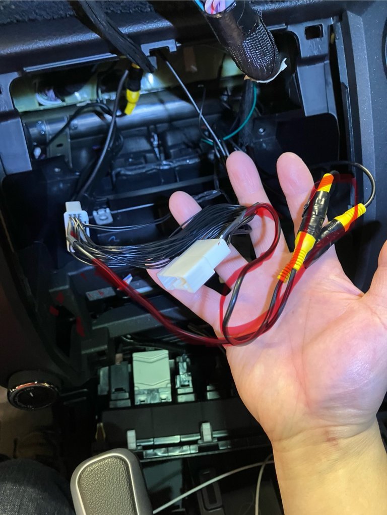

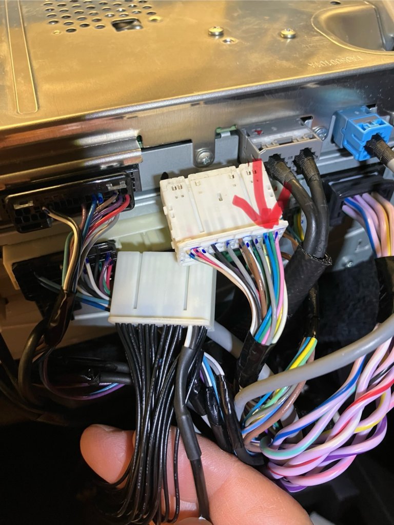

    So I located the OEM plug and wiring, on the jumper harness the wiring goes through the yellow RCA wiring, through the relay, and back to the jumper to plug into the radio. I thought that was front camera input, I could be wrong.
    But checking the jumper harness pins and wirings, it looks fine to me. Should I start cutting out the insulation on the soldered joints?

    While you have it apart, I would re-install the FRAC Harness connections and try some bluetooth calls again. Could have been a poorly seated connector. If that doesn't help then I would contact Brian and he will work with you to get this resolved.

    There are multiple Head Unit functions that work even if the power is off Since it still has Ignition power applied... Cam video for one. From the pics it appears that the wires are there at the head unit connector. So maybe they are in parallel after all.
