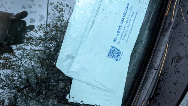

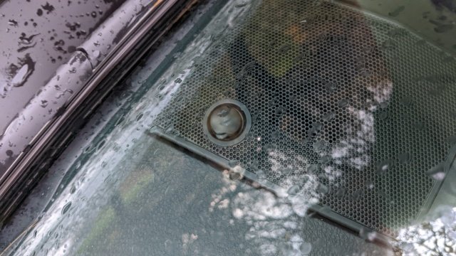

    @TundraTex, Lou, I have another question for you.
    Is it possible that the FRAC harness is interfering with the head unit's "daylight sensor", which controls the headlights turning on automatically when it starts to get dark out?
    This Tacoma is new to me so I'm not sure if it ever reliably worked the way I expect it should, and changing the setting for sensitivity doesn't seem to help at all.
    The automatic lights seemed to be working last week, ie: during daylight, only the 'driving lights' would be on, and the dash lights and head unit display would be bright, that is, in 'daylight mode'. When dusk came, the headlights came on and the dash lights dimmed. But I only noticed this function a few times.
    Now when I turn the headlights on 'Auto', they're always just 'On', no matter how bright a day it is. I'm not sure when this stopped working, but in the interim, I'd pulled the head unit out once more, to connect the front camera and the front camera switch.
    Is there something in the harness that might interfere with that daylight sensor?
    Thanks again!

    I've never heard of anyone having this issue and there's nothing electrically interfaced to the headlights. That said, my thoughts on things to look into would be as follows in my most likely to least likely order:
    • Daylight sensor being blocked. Not sure where this sensor is located in your truck, but its usually somewhere on the passenger side dash near the windshield. I have heard of windshield inspection stickers blocking light to the sensor and causing problems. Check to make sure nothing is blocking your sensor.
    • Camera Power Tap - When you connected your camera power, did you tap into a fuse that may affect the headlight circuit?
    • VIM Enable not switched on. Are you utilizing your VIM switch properly? if VIM is off continuously, it can affect turn-by-turn prompts and navigation accuracy - but those are Head Unit functions. Not sure why Toyota would use the HeadUnit VIM input to affect DRL or Auto
    • OEM-Style FRAC Camera switch illumination. Are you using the illumination features on the camera switch? If so, how did you wire it. if you tied into the illumination circuit improperly, perhaps that could affect other items tied to the illumination circuit.
    • Front Camera Position. I'm pretty sure the auto-high beam sensors are tied into the TSS "Camera" on the grill. Did you have to disconnect anything from the TSS when you did your camera installation? If so did everything get re-connected properly (i.e. connectors fully connected) when re-installing the grill. Is it possible your camera is potentially blocking or shadowing the TSS sensors? I doubt this would affect the auto on function and there are usually lots of warning bells and whistles if the TSS is not properly connected.
    Let me know how it goes.

    @TundraTex! You nailed it, on the first try.
    (Jeesh - I'm a bit embarrassed!)
    Perhaps the gas bill was getting in the way???!? :bananadance:
    Arghh!
    Thank you so much for your sage advice! You build the excellent FRAC, then you troubleshoot for me.
    Yes, off to the far right of the dash, embedded in the speaker grill, of course. I assumed it was using the 'Lane Departure camera' up near the rear view mirror.
    Thanks again.
