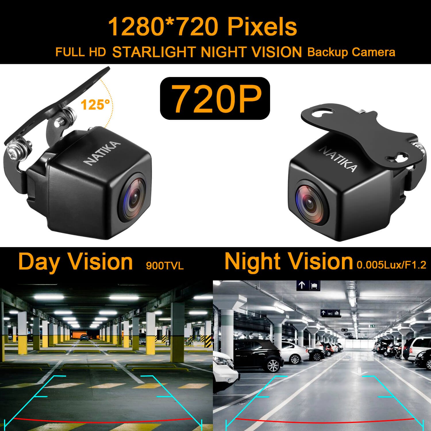

    Considering this one for its adjustability

    Did you install this camera? What is your review of the cam?

    Have not purchased yet. Will be doing so soon.

    Looks like a decent camera but the field of view is 145 degrees. Mine "seems" wider but I would have to look up the specs
