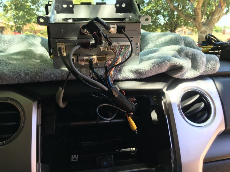

    I've been thinking about what to put in the instructions. Here is a list of the major tasks you will need to accomplish in order to install a FRAC harness.
    1. Buy a harness kit from TundraTex
    2. Buy a 12 Volt Front Camera from the supplier of your choice. The camera should provide video on an RCA male plug. The FRAC harness has a female RCA jack for the front camera video input. The FRAC Harness also has a 12V power line for the front camera, so run the power line along with the Video.
    3. Buy a set of panel tools like these for $5
    4. Install your Front camera. Pick the installation location and run the video and power lines through the firewall boot (I used the passenger side boot). The 12V power and video lines need to be routed to the Entune Bay behind the radio. The camera ground can be connected anywhere in the engine bay. This thread provides a little info on how I mounted my camera. NOTE: The camera RCA connector may be too big to fit through the firewall boot nipple, so you'll likely need to cut the video cable to route it through the boot, then splice it back together once you're through.
    5. Remove the two consoles below the Entune HU. These consoles are tight, but they are just clipped in, so they will pop straight out. The tools you bought in step 3 can be useful here. There are lots of YouTube videos demonstrating this.
    6. Place a towel on the dash above the HU.
    7. Remove the Entune head unit. You'll need a 10mm socket wrench with an extension. 4 bolts hold the HU in place. When you remove the HU bolts, you can pull the HU straight out and flip it up onto the towel on the dash to get access to the connectors as in this picture.
    8. Connect the FRAC harness between the radio and vehicle harnesses - specific instructions will be provided.
    9. Remove the Blank switch panels from two locations and snap in the provided panel and switch assemblies. Or if you're like @BlueBottle, cut your own switch mounting holes and install the switches.
    10. Route the included FRAC harness switch wires to the switch locations and connect to the switch terminals.
    11. Connect the relay ground wire from the FRAC harness to the Side of the Radio bracket. EDIT: This step no longer required.
    12. Tidy up the harness with a few tie wraps. Reinstall the HU, the switch panels, and the other console panels and you are done!
    I'll have a few more details written up later, but this list should give you a feel for the task.
