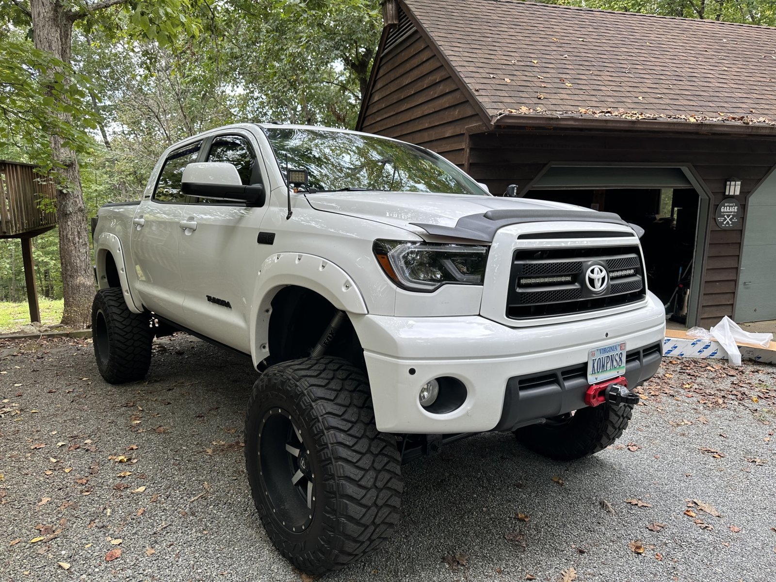

    My truck has been in the shop for almost a month waiting for a transfer case, but when I have had it I’ve loved the headlights. If you can find them sold as VLAND headlights I think they are the exact same but cheaper price. My mights say VLAND right on it.

    off topic but howd you mount that winch? truck is beautiful

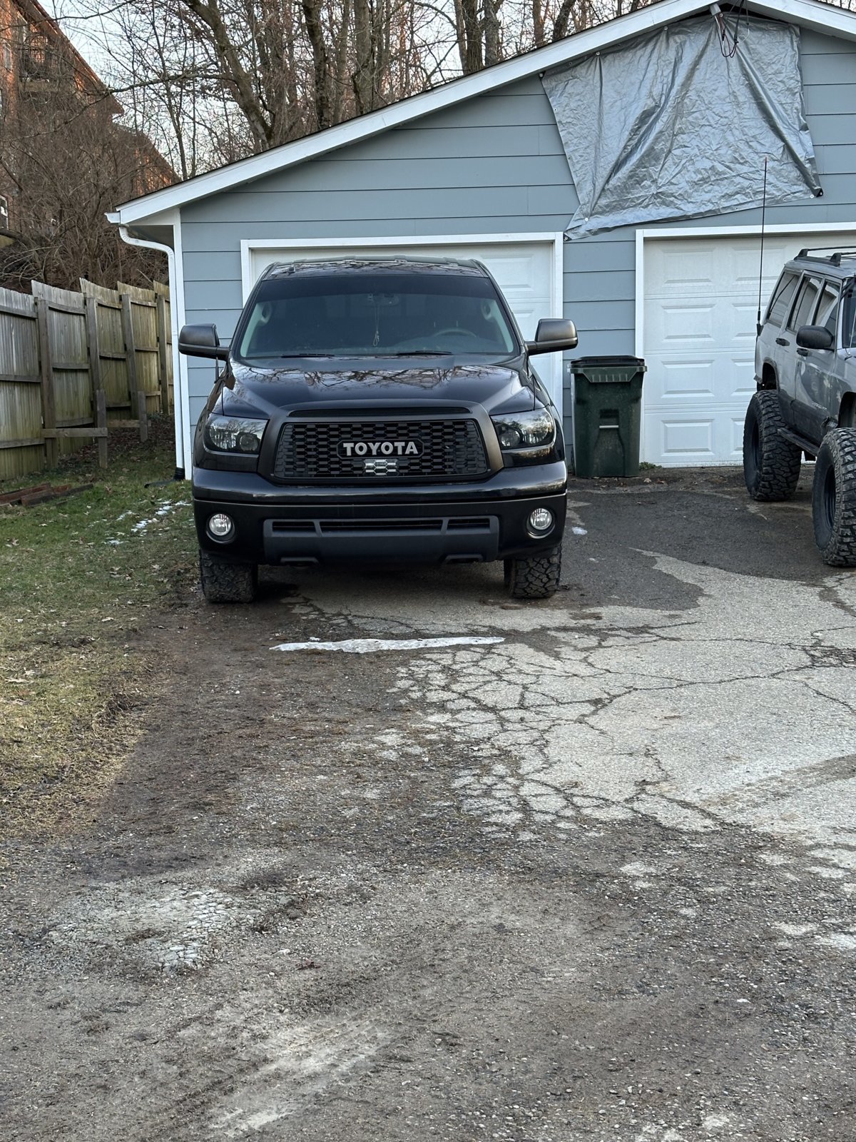

    i did led bulbs in the stock housing after doing the bhlm and smoked lenses IMG_6154.jpg

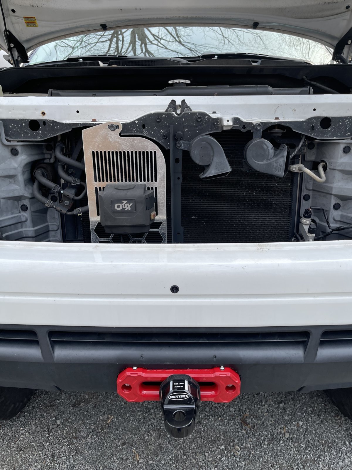

    I used the SDHQ Hidden winch mount. Takes the place of the crash bar behind the factory bumper. You do have to cut out for the fairlead.
    the winch control box is mounted in front of the radiator. Can’t remember the company that made that mount off hand.

    dang thats clean
