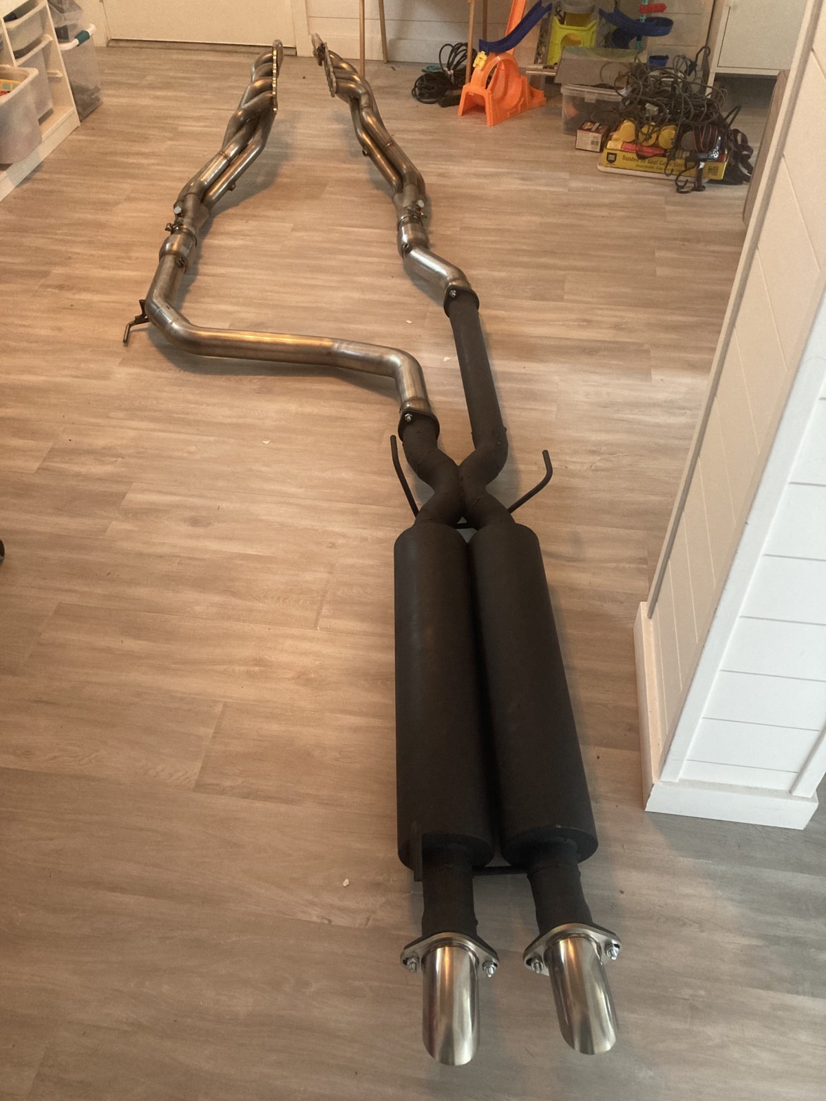

    I have my 2021 set for sale for 200$ over in the for sale section haha. Removed when I put in long tube headers.

    Curious as to why as I'm considering some AmericanRacingHeaders.
    Interference or went with Hewitt bypass?
    Sorry for the hijack.

    Oh no problem. With ARH you choose if you want the air injection tube and I wanted to make it as clean as possible so got no tube. Then took out all the SAIS system to make the engine bay more empty. Definitely not a requirement and doesn’t do anything power wise.
