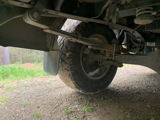

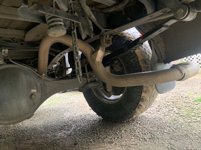

    Yes, the passenger leaf spring is installed backward - facing the wrong direction - flip it; there is about a 1" length difference between each side of the leaf pack - so that is pushing you're rear wheel 1" farther to the rear of the truck too.
    I'm not totally sure flipping the leaf will raise you up the 1.5" you need - but it's a start!

    2012 Tundra TRD
    Rusty
    you are correct sir. Went outside and my wheelbase is off by 1”

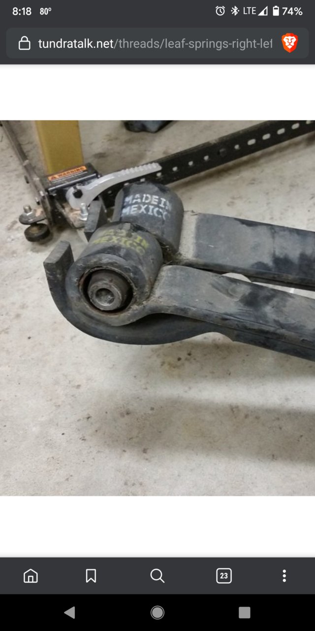

    Hmmm.... Looking at your pictures, I don't think it's backwards... Take a look at this picture below of stock leaf springs. See how these have the "extra" metal curving around the end of the spring? That part should be in the forward position of your truck. I'm not seeing that in the pictures you posted. So you can rule out them being installed backwards. Is there any gap at all between the spring and axle?
    Edit: I am assuming all tundra stock springs have this extra curve. My 2013 did. You might crawl under and see if both of your springs do. If the passenger spring does not have this, it very well might be backwards still.

    I'd wait to blame the mechanic just yet. You said it was in a wreck? Wonder if the frame is tweaked. You might measure the distance between the spring and frame in the center of each. It really does look like your axle on that side is pushed back, but I wonder if it's something more going on.

    The leaf spring is 100% on backwards. It is the same spring but it is installed opposite of the other side, hence the wheelbase being off by about and inch. It will be fixed today. I don’t know if it will help the sag but a problem nonetheless that I didn’t even notice initially because I was pissed that it was still sagging.

    In the pictures of his you reposted you can clearly see in your first pic of the passenger side that the "curved" part is installed facing the rear of the truck - not the front - look closer.

    Guess zoom isn't working well for me anymore. Gonna have to break out the reading glasses. So I was right the first time. Thanks
