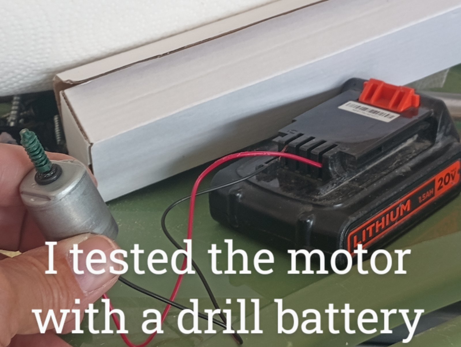

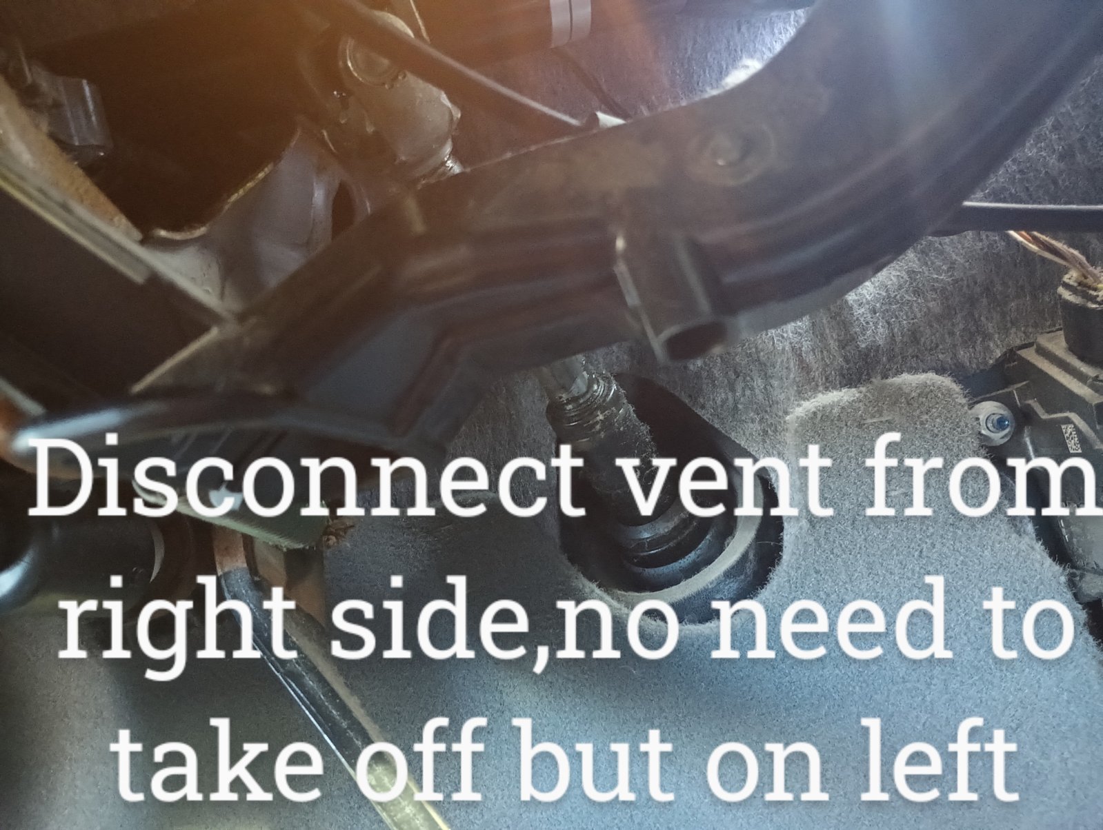

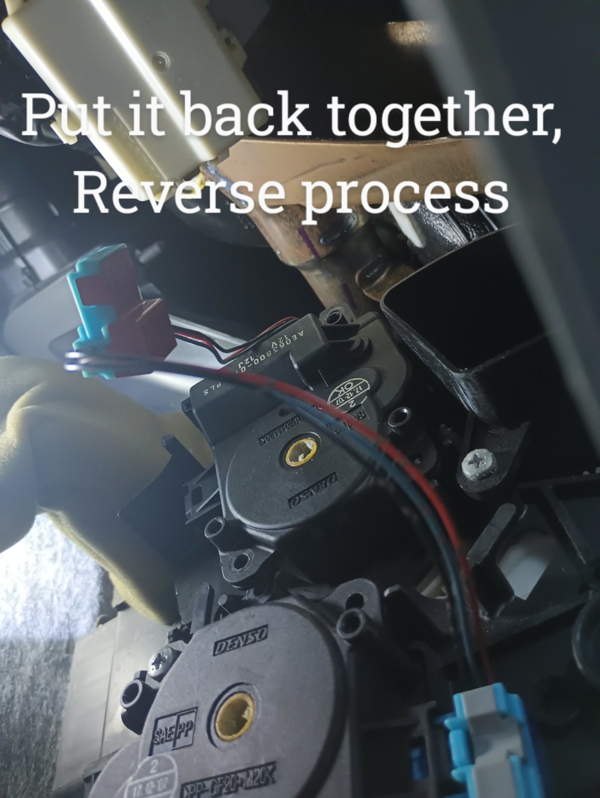

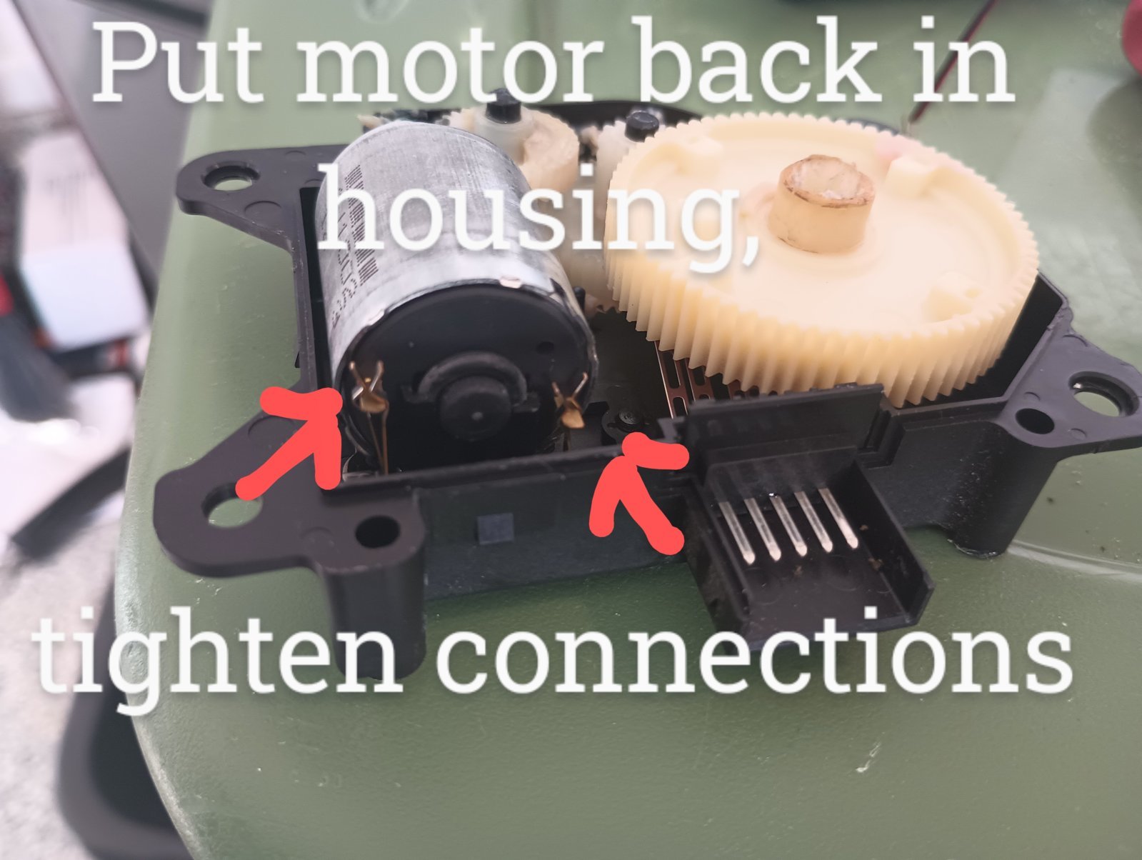

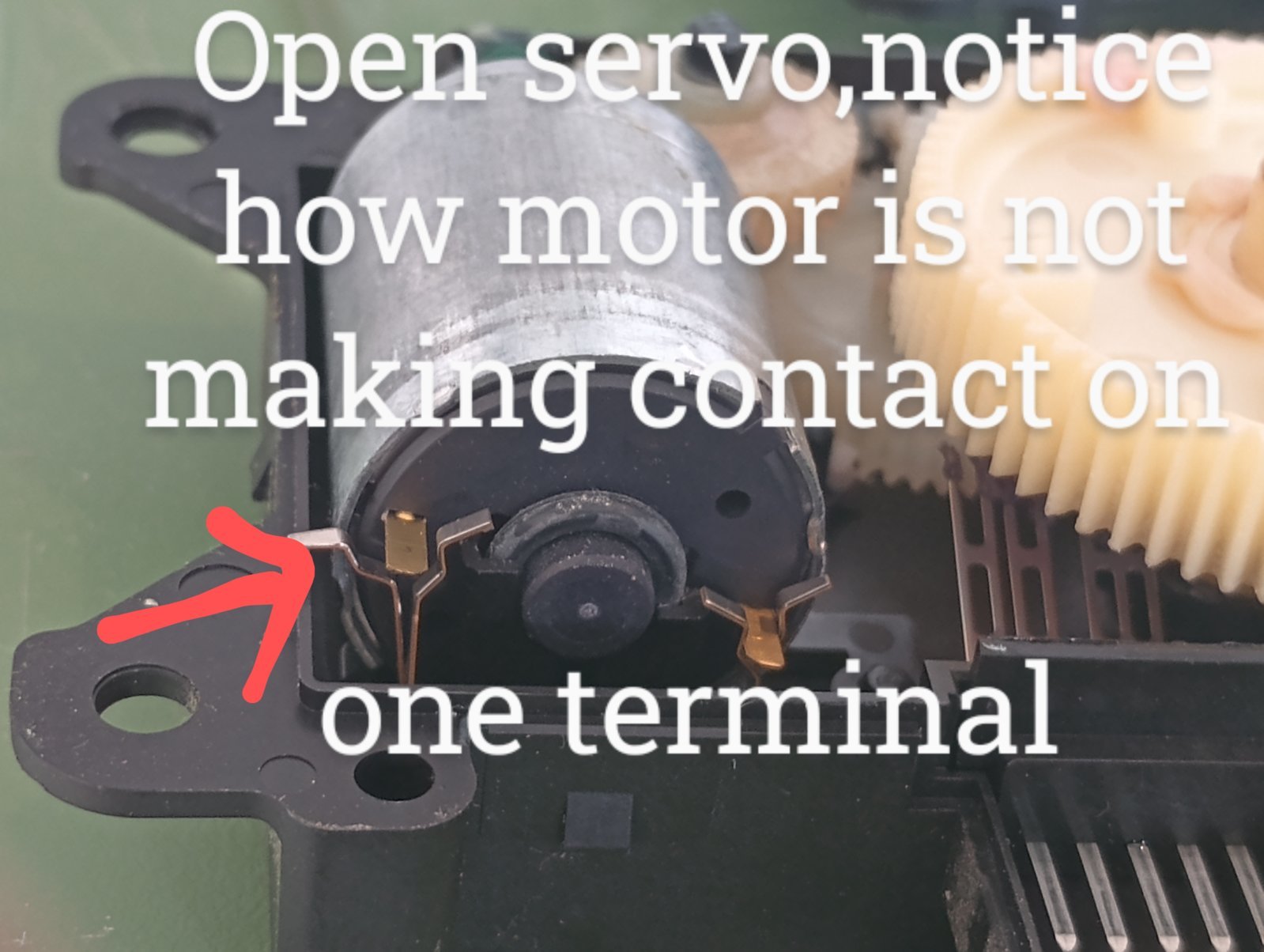

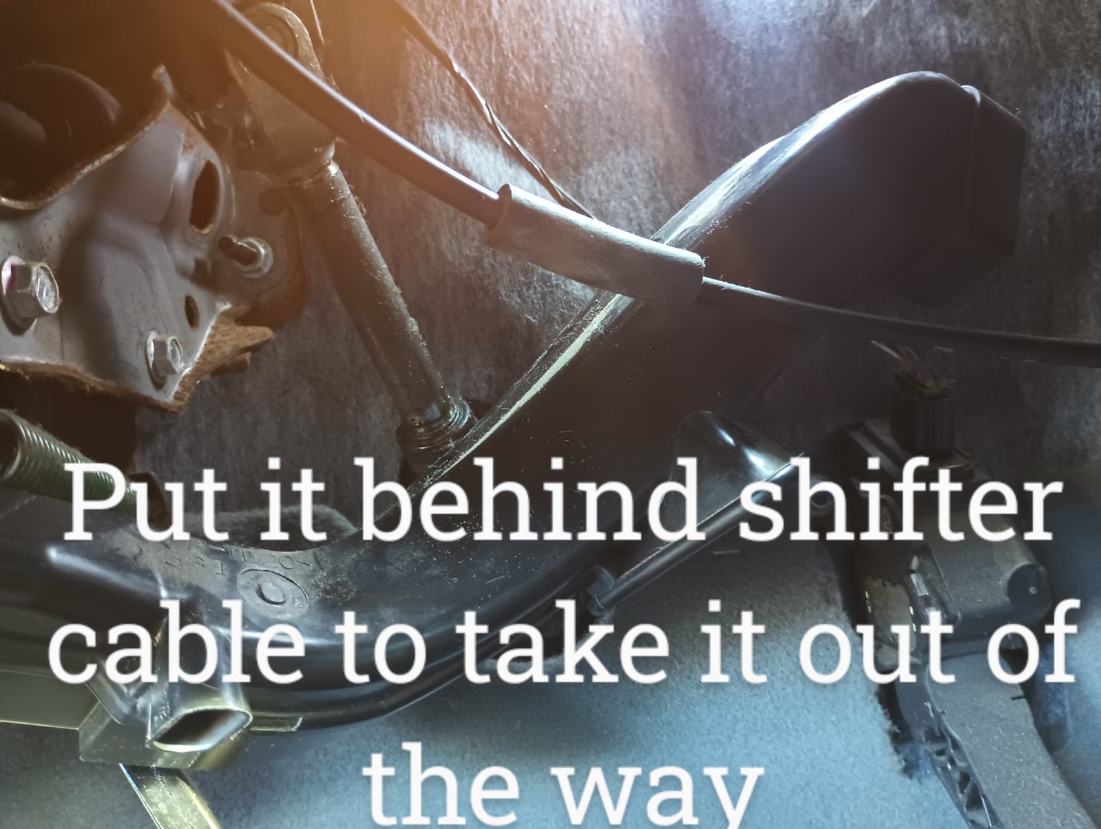

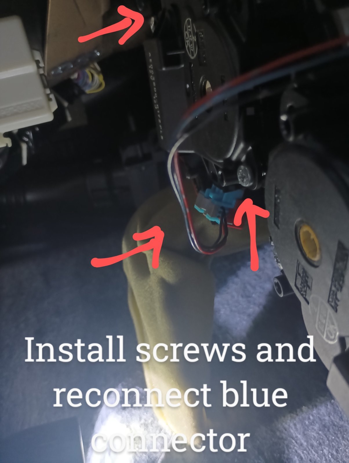

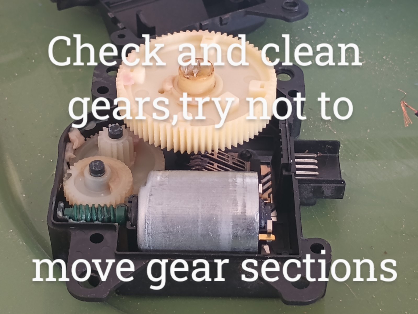

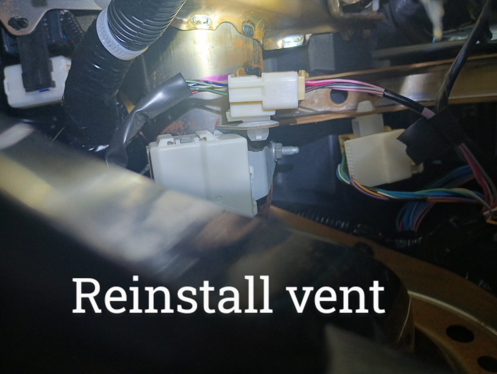

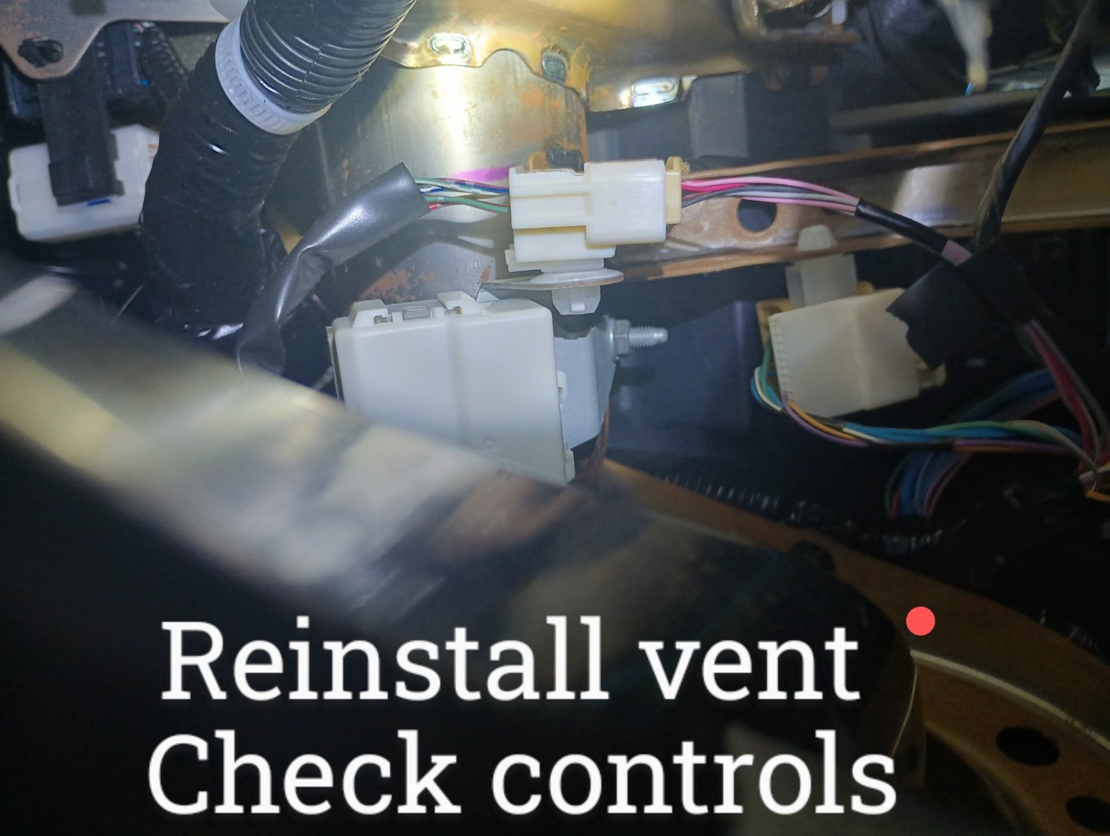

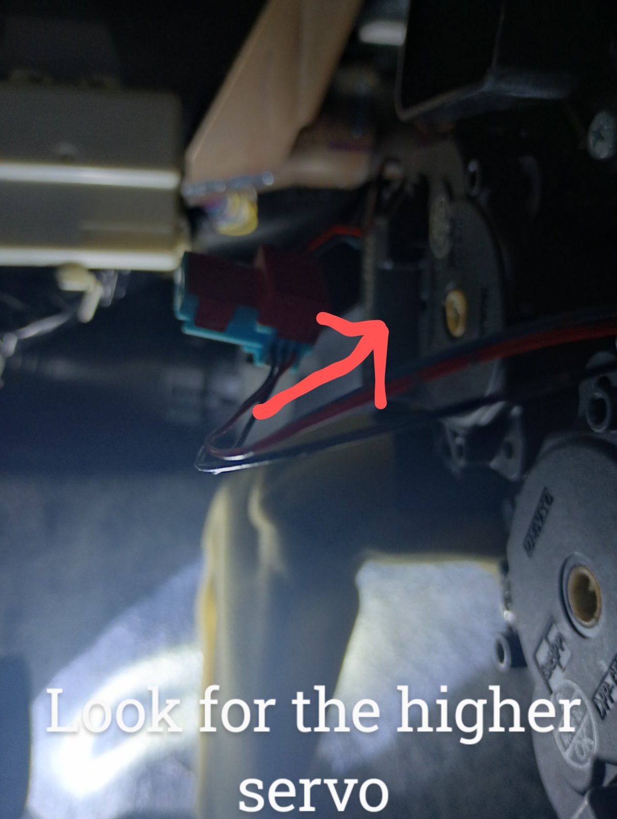

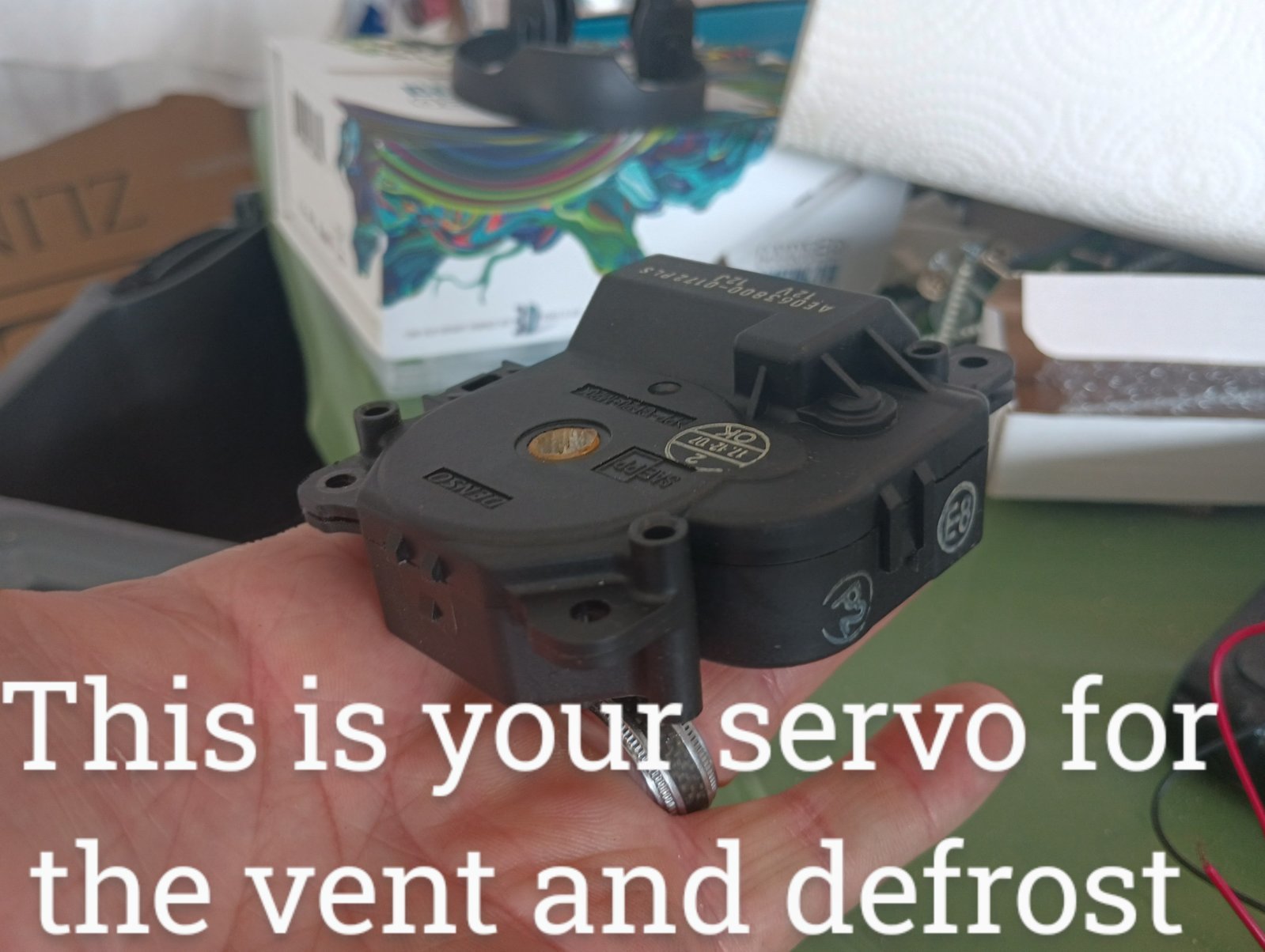

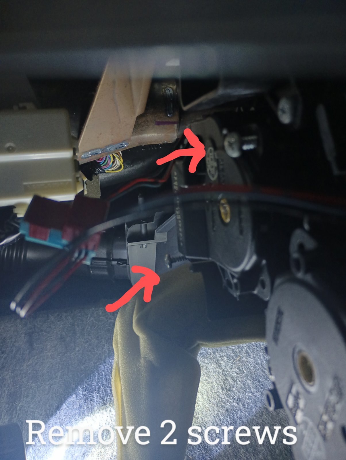

    Hey guys,here is the step by step fixing of my servo issue,hope it helps those in need,pretty sure it could be done with any of the other servos,vent and defrost servo located on driver's side

    This is gold. I'm getting ready to dive into this.
