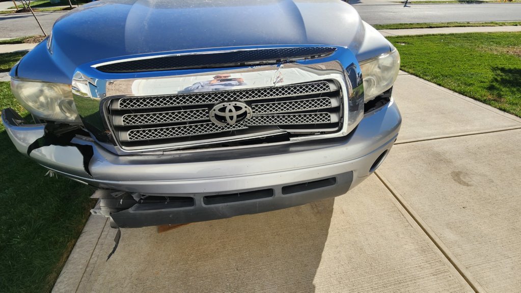

    Due to the unfortunate circumstances of grilling venison in my 2008 Limited, I'll be retrofitting my Tundra with a Sequoia front clip.
    My brain is absolutely fried right now, so excuse if I ramble, but I plan to document the process here and hopefully provide as much useful information as possible so others can do this with ease.
    Short backstory, I bought my dad's 2008 Tundra Limited from him a few years back.
    He bought it brand new and kept it in fantastic condition. Of course, I hadn't wrecked or damaged a vehicle in 19 years so naturally I decided that liability coverage was adequate. Suffice to say, that bit me in the booty cheeks and I'm a firm believer that the old hazy halogen headlights (that I was going to replace) played a major role in the unfortunate events.

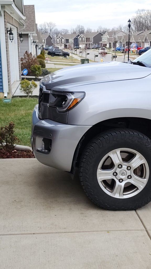

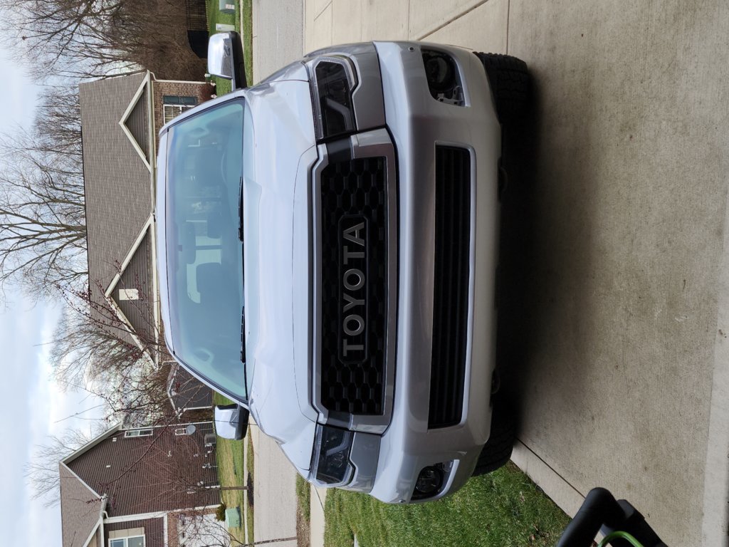

    Well, it's been a long painful process but it's mostly complete. Still more complications to sort but here's how she looks. 680edacb-1133-4d70-9c9d-f437375b964b.jpg Snapchat-2066055823.jpg

    I still need to order the lower fender liners (the tundra ones don't fit the sequoia bumper). Also, she needs some adjustment to the passenger headlight and bumper body lines along with needing the fog lamp bezels. The fog light bezels I bought don't even clip into the bumper.

    Looking damn good. Did everything just swap right over?

    Not really, I had to buy the sequoia center bumper retainer, Hood latch support, and now I need to order the lower fender liners. That is not including the grille Brackets, bolts and retaining clips for the grille conversion.
