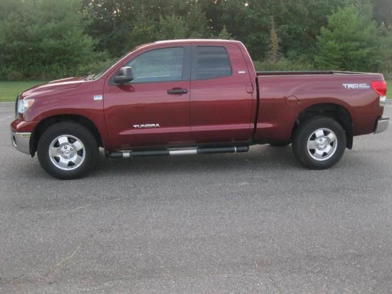

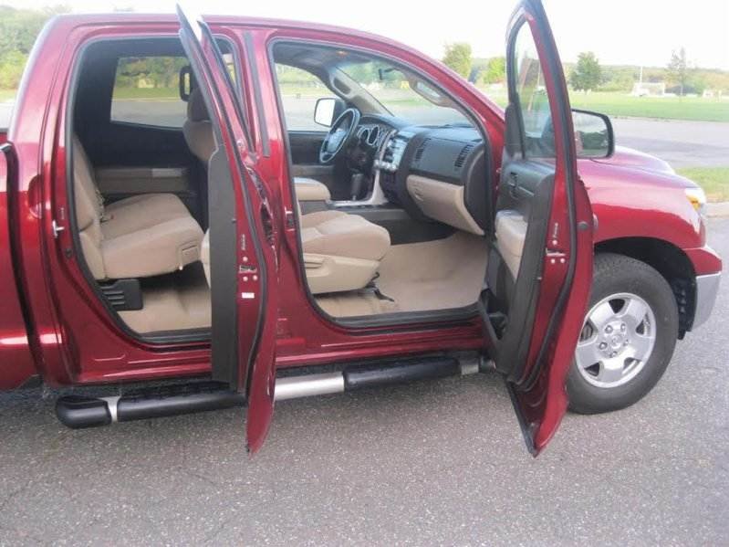

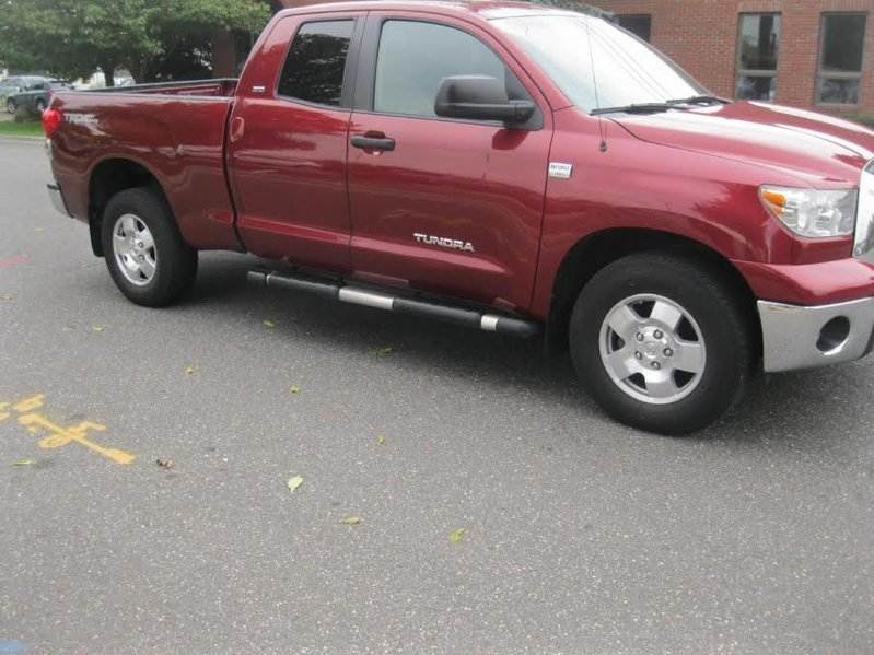

    My trucks suppose to arrive by this Friday. Below are some pics forwarded to me by the dealership:
    I look forward to every bodies input and ideas! Bill

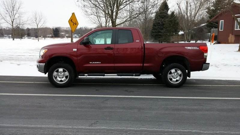

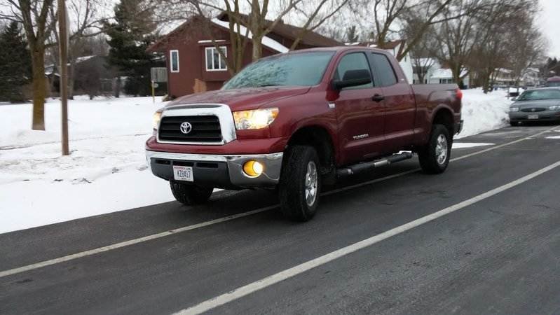

    I sure did! 4" front, 2" rear. :) $1,230.00 for parts, labor, and alignment. Drives beautifully!

    looks great! what kit did you go with? readylift?
  13. Feb 17, 2015 at 2:28 AM
    Wisconsin Bill
    Wisconsin Bill [OP] New Member
    Jan 10, 2015
    #864
    52
    Bill
    07 Tundra Dbl TRD
    in the plans!!!
    Actually the guy I had do this builds custom street rods. He ordered all the parts individually. Used a 2" block in the rear, and have coilovers and a sway bar to install for stability when the 35's go on. New steering arms and and extensions up front.
    I couldn't be more happy about how it handles. Very smooth, especially how it holds the curves on the off-ramps. Literally couldn't feel any outside force or lean coming off from highway speed.
