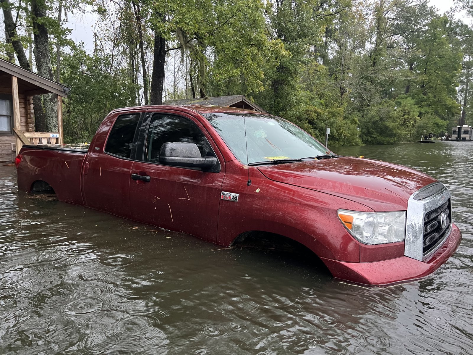

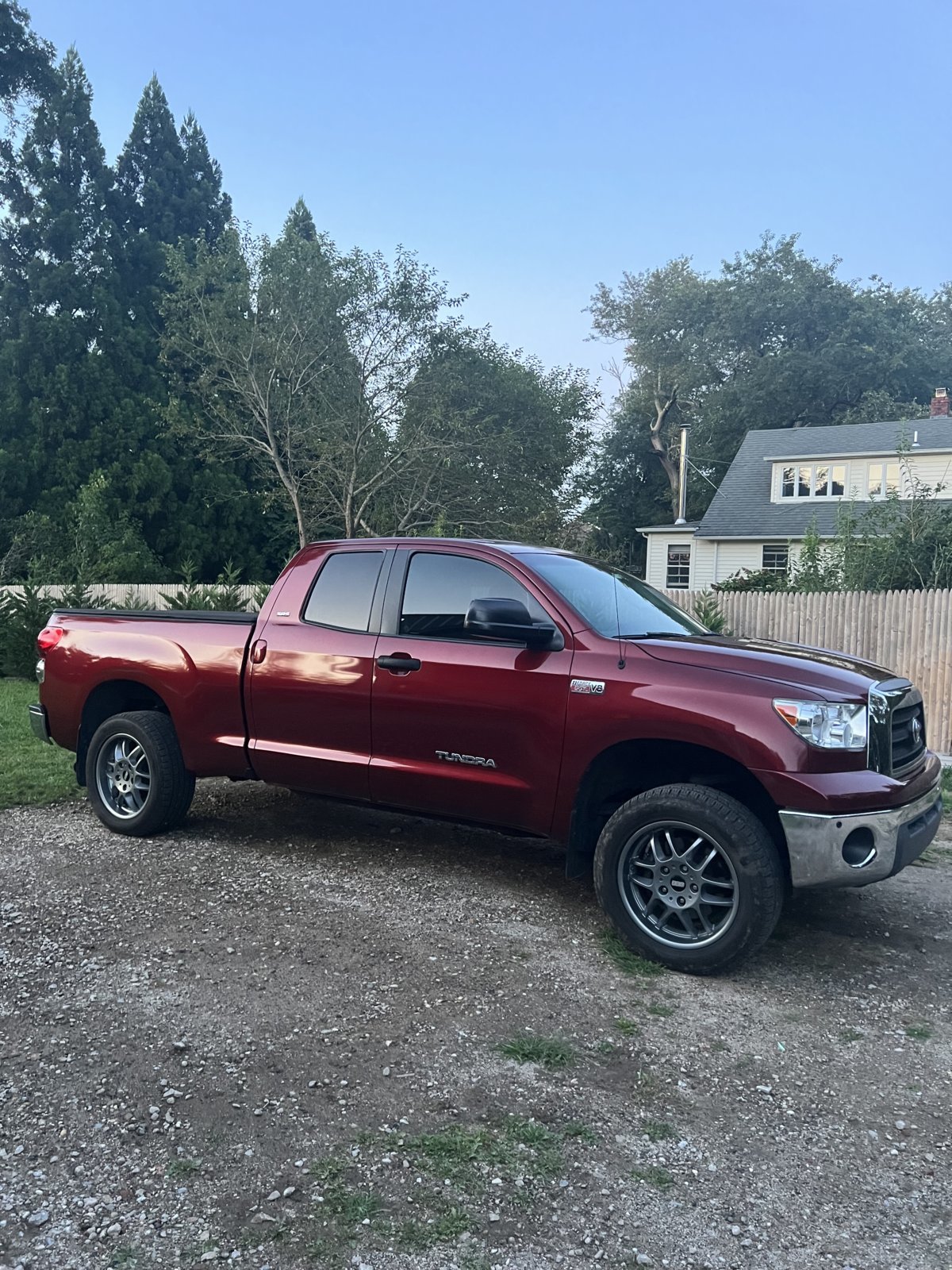

    Thanx for the replies. Yes, the cab was gutted. The driver's seat power controls shorted out and smoked all those wires. To my knowledge, no other modules or relays were submerged / below water except for the fuel pump ecu / relay on the rear frame (i am planning on removing tomorrow). And I will definitely look into the referenced websites. I'm gonna give it an honest effort, BUT I did tell my son that he's better off just selling it for parts (but complete because we don't have a facility to dismantle). It truly is a shame but life happens. And just for reference, this is what it looked like before water and after waterIMG_7804.jpg IMG_8537.jpg

    Damn. You couldn’t have paid me to take that truck seeing how high that water line was.
