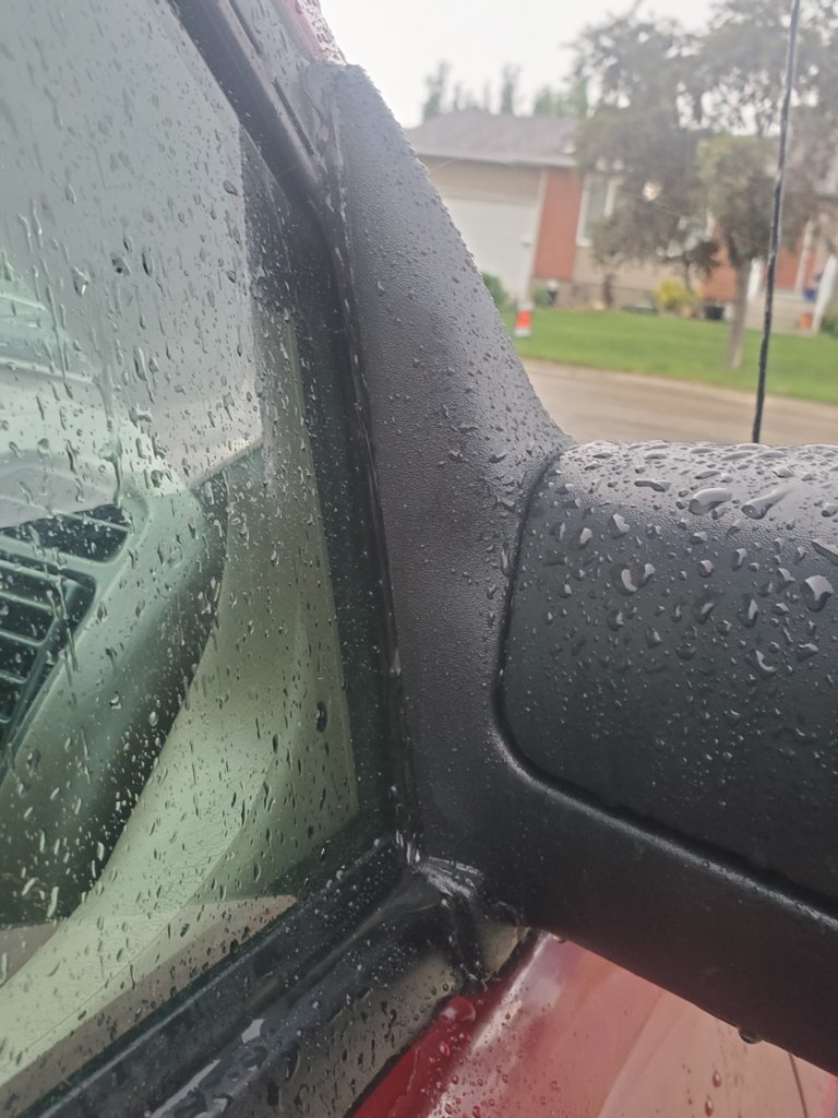

    I think the worst part (from what I've read and seen pics of) is trying to get a good seal that doesn't create excess wind noise that'll drive you nuts or let water into places it shouldn't be, which is probably more of a problem in the rust belt than anywhere.

    I installed Dodge mirrors, cut a rubber gasket, drilled the holes bigger, and then used silicone. I think my biggest issue is the mirror vibrates quite a lot, but it's probably because I used cheap aftermarket mirrors.

    LED Lights Galore. Mostly Stock
