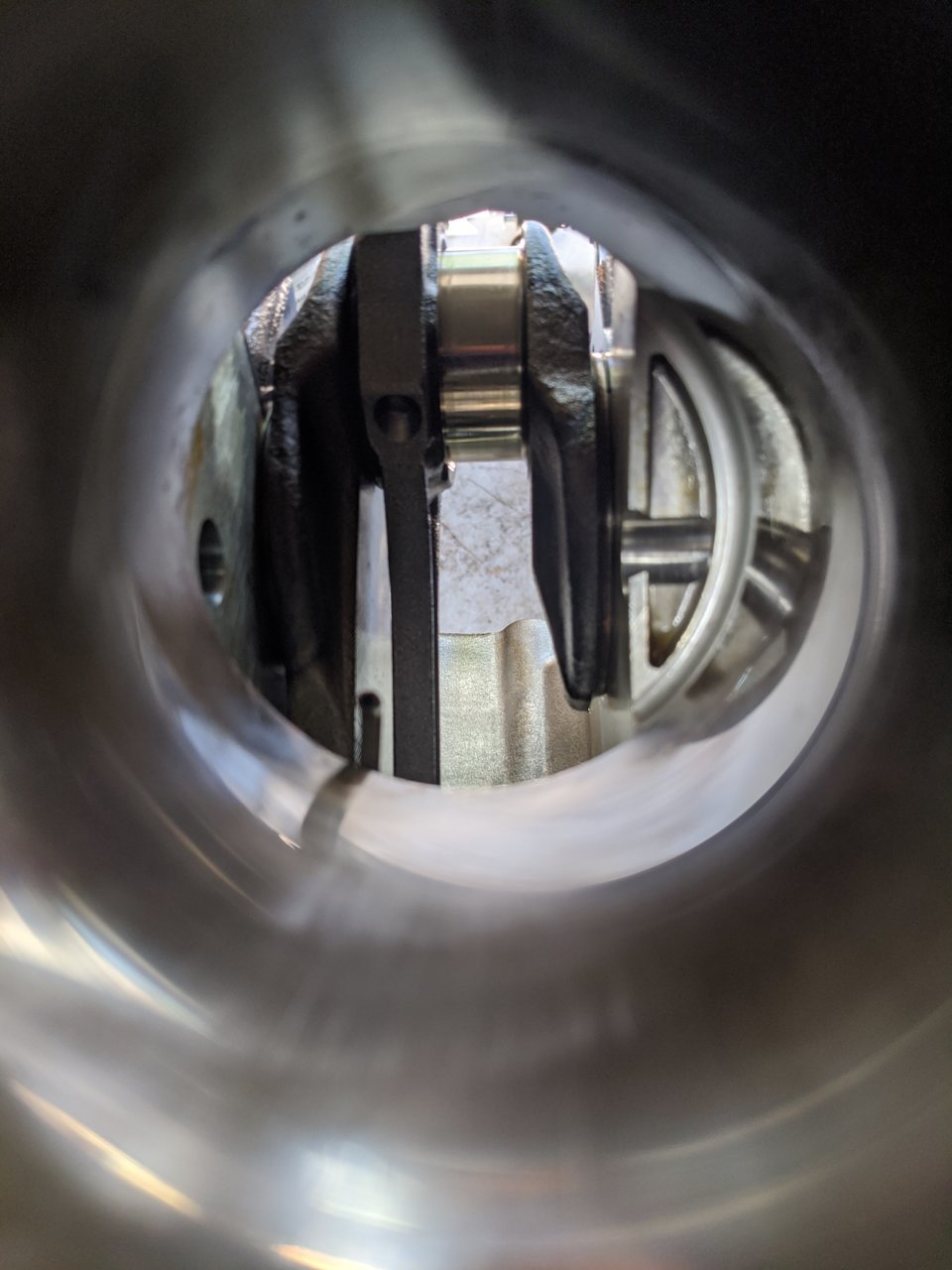

    What condition is the cylinder that piston came out of? Almost looks like too much boost for the ring gap it had and it finally bound up and broke the ring lands. Weird it only happened to one piston and not any others?!? I'd tear into the others and see what you find. Looks like full engine rebuild is in order. Also a good time to have the block machined and go all forged internals. I'd opt for the Total Seal Gapless rings set up for mild boost/nitrous. Sorry to see it was way worse than valve seals.....I'm guessing you knew that when you pulled the engine though....good luck with it!!!

    That cylinder looks good in the pics! You dodged a bullet there I think!! If no scoring or cracks in any of the cylinders, should be rebuildable. What are your plans with it now?

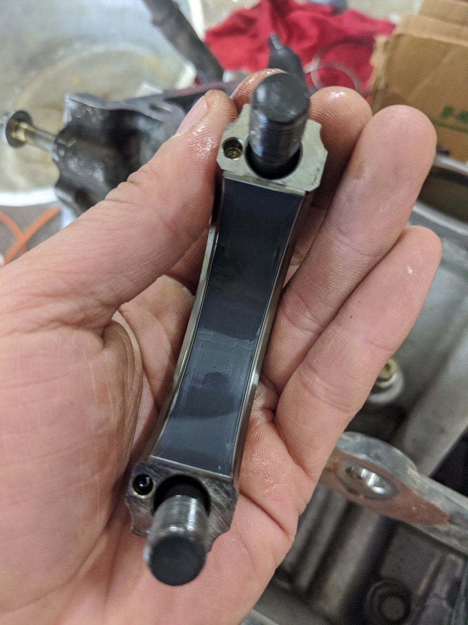

    Yea its incredible how little wear there is inside this motor. All the bores still have crosshatching, bearings look brand new, hardly any carbon buildup anywhere.

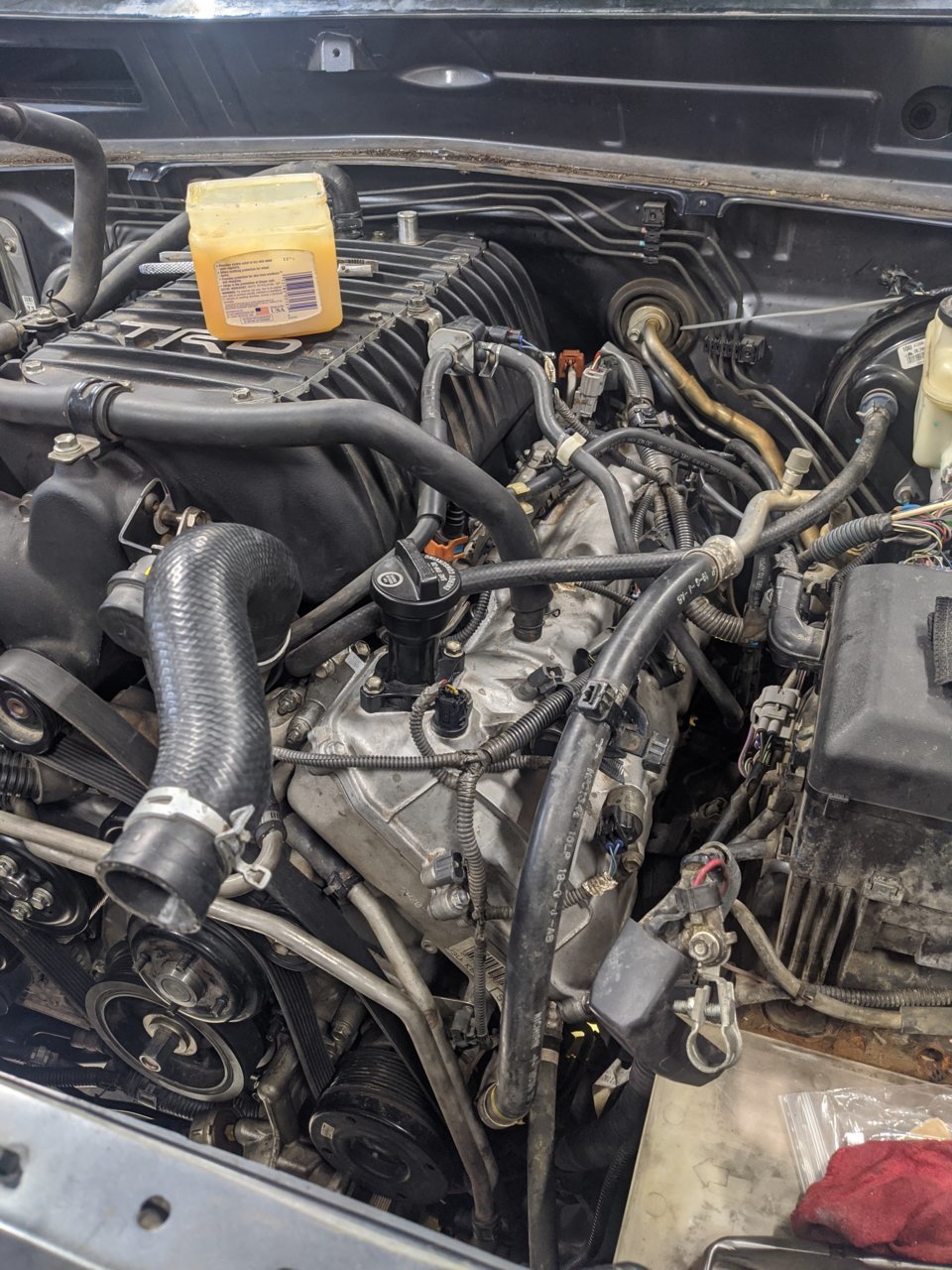

    Snapchat-1691665101.jpg Making progress. Got a massive air bubble worked out of the cooling system, found a transmission temp sensor I left unplugged, finished burning residual oil and pb blaster off the exhaust manifolds, and road tested a handful of times. I'd forgotten how strong this thing is.
