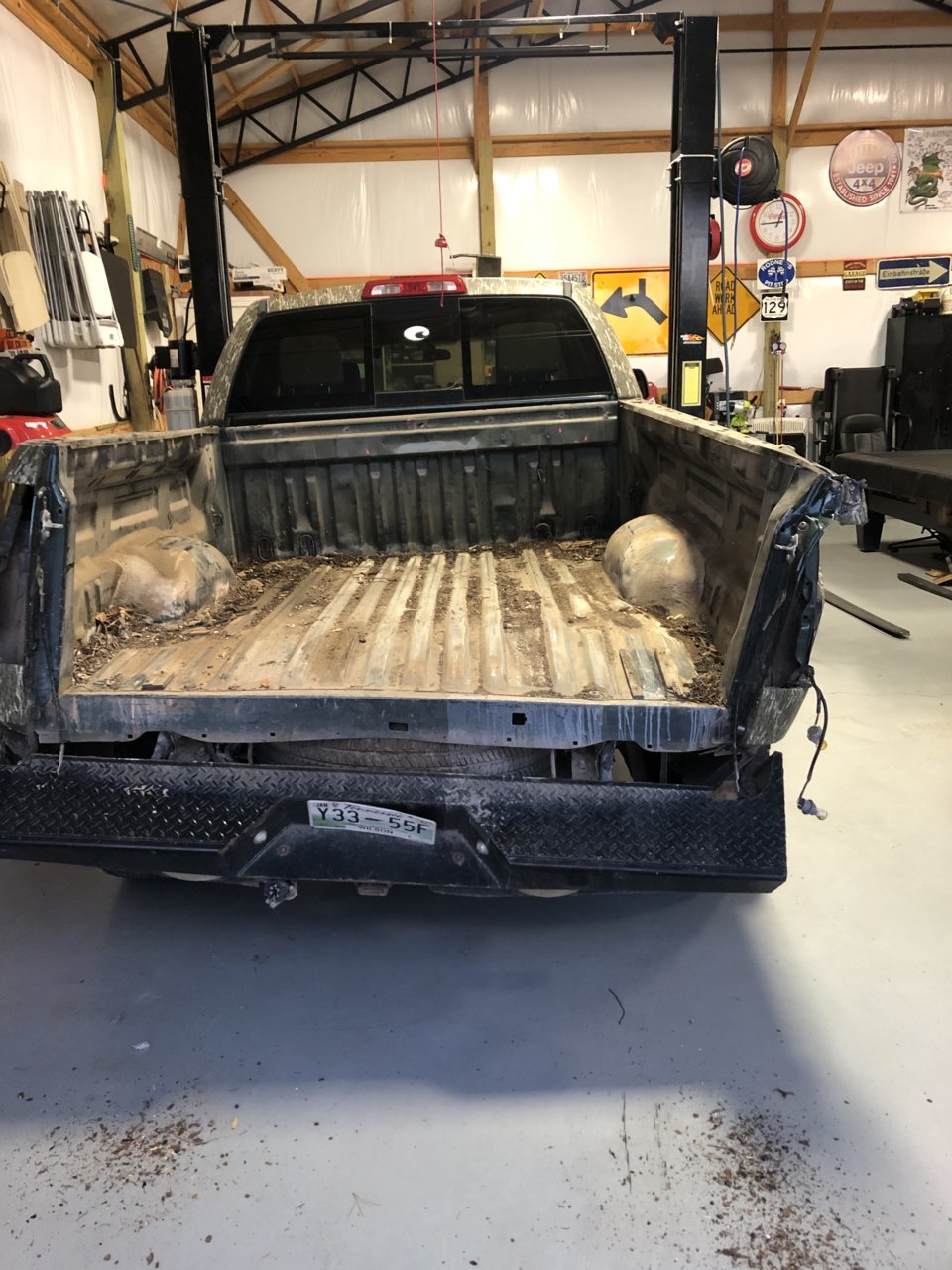

    Well. I bought a wrecked 2007 sr5 tundra 4x4 with a hideous wrap. Been working and buying parts the last couple days8DA2E3BE-0F80-4E83-B2D1-0EA75744DBC3.jpg 53733EAB-B2E2-48C9-A40E-EAD91DB97359.jpg Hauling it home.
    May need some parts if any of you guys have them

    Good luck with your project, but did you check the frame for damage?

    Yes sir. My friend has a frame machine

    It looks like it’s in good hands finally, and it’s looking better already. Just rear damage?

    wee bit o frame damage i see there. Best of luck! my frame took a bit of tweeking afters its rollover, but she drives good as can be now!

    Its going to the frame shop monday. Hopefully I can get all the wrap
    off. I have to find where they are buying those nice fender flares and those updated first 2nd gen headlights
    If you know where? Please post a link!
