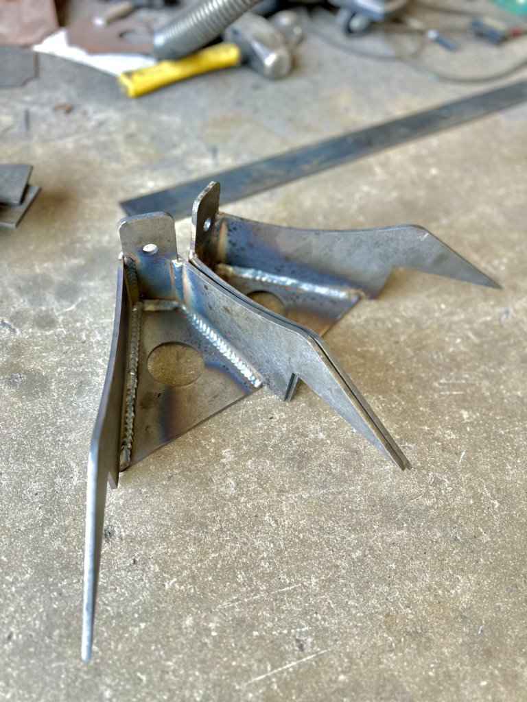

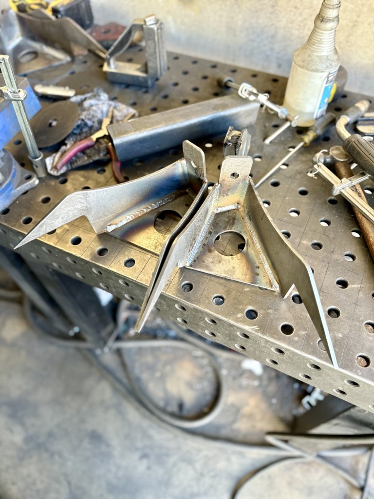

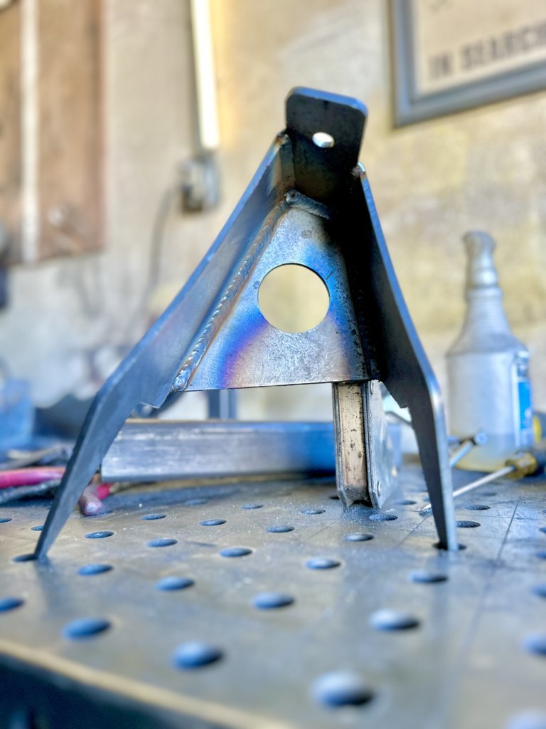

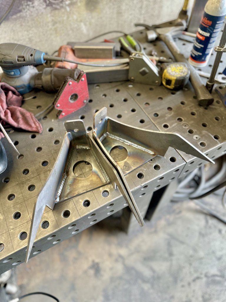

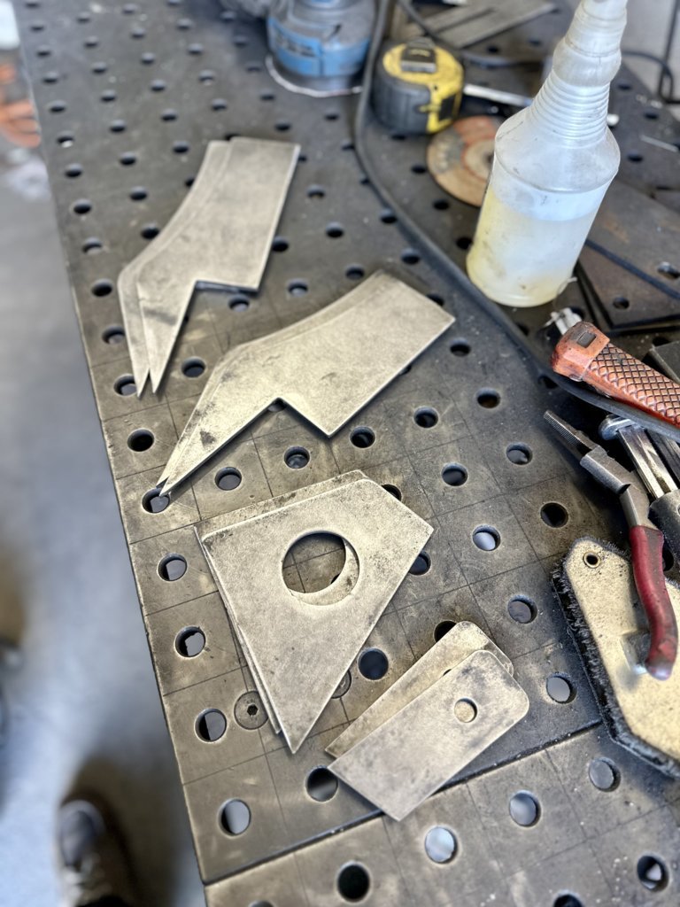

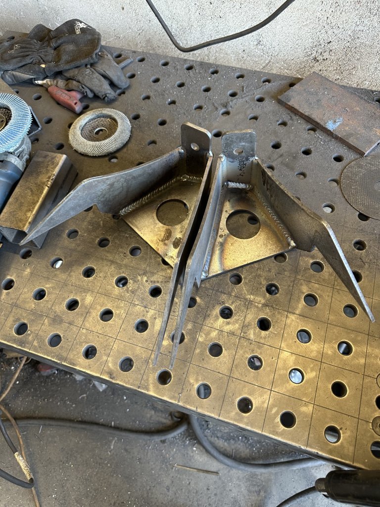

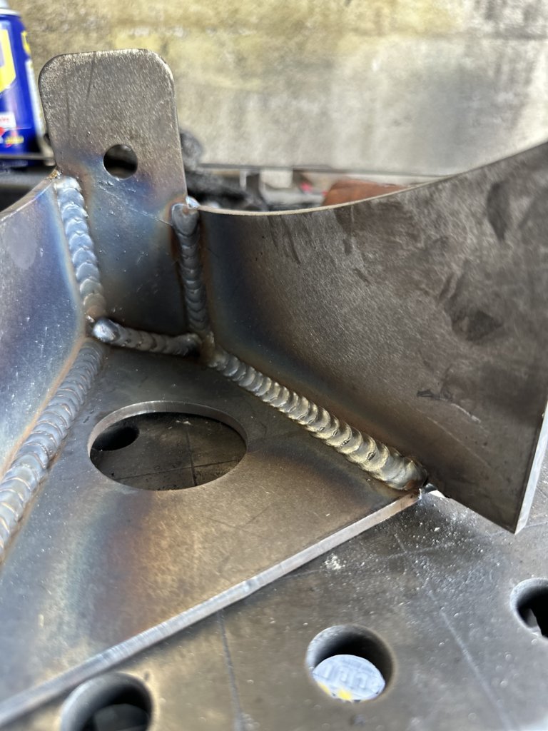

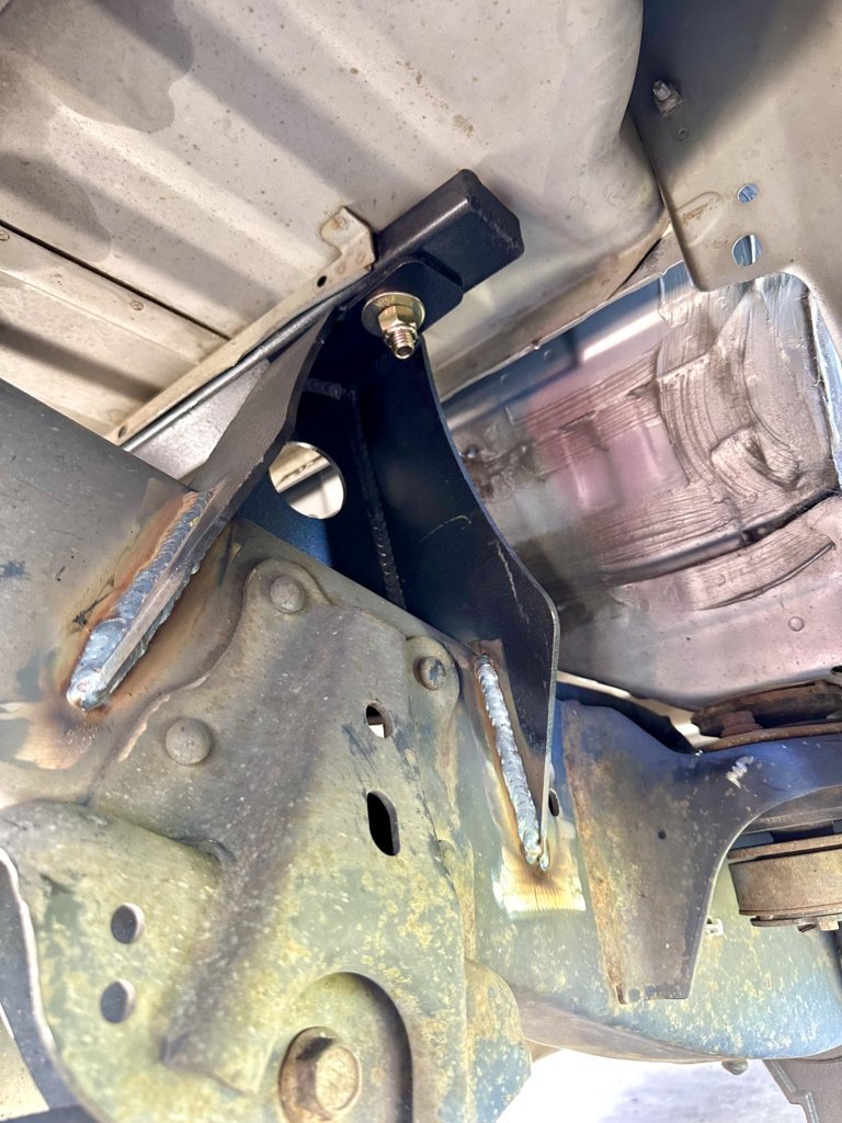

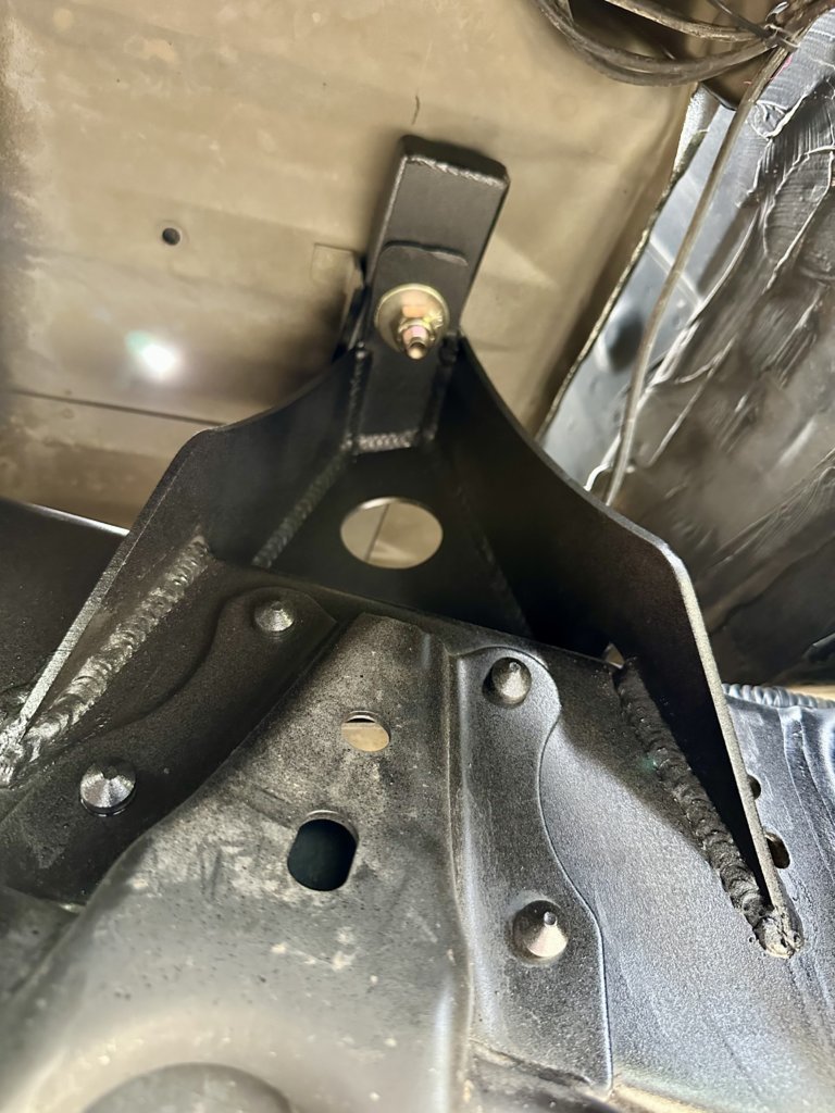

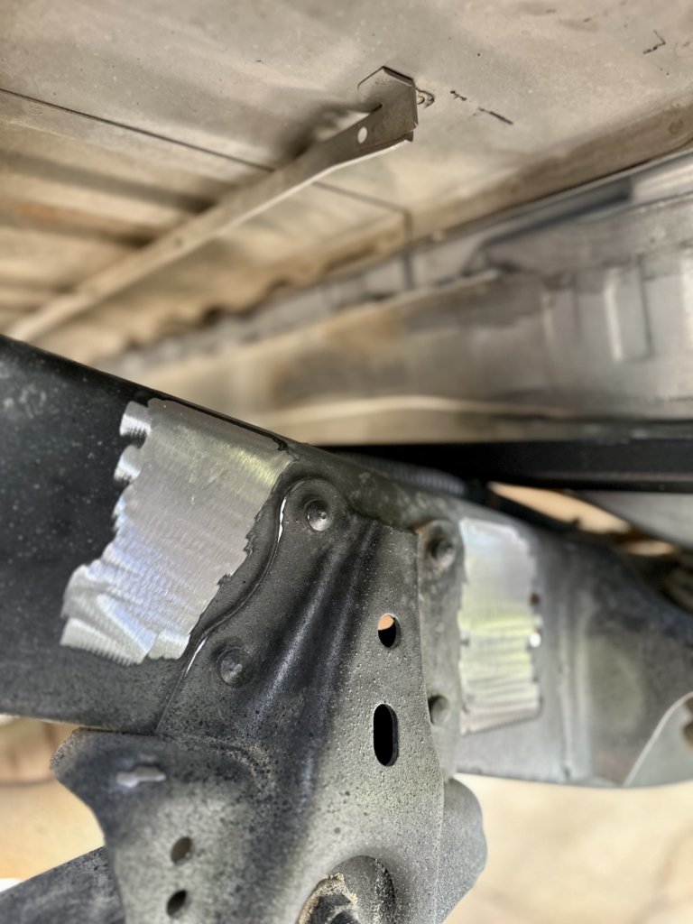

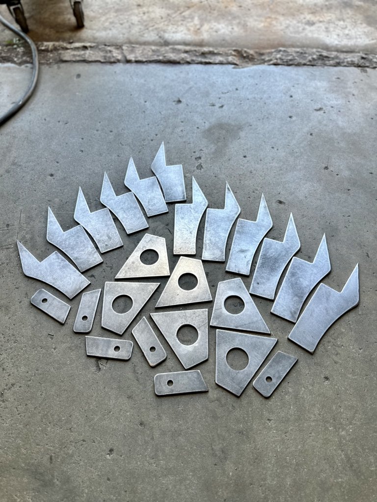

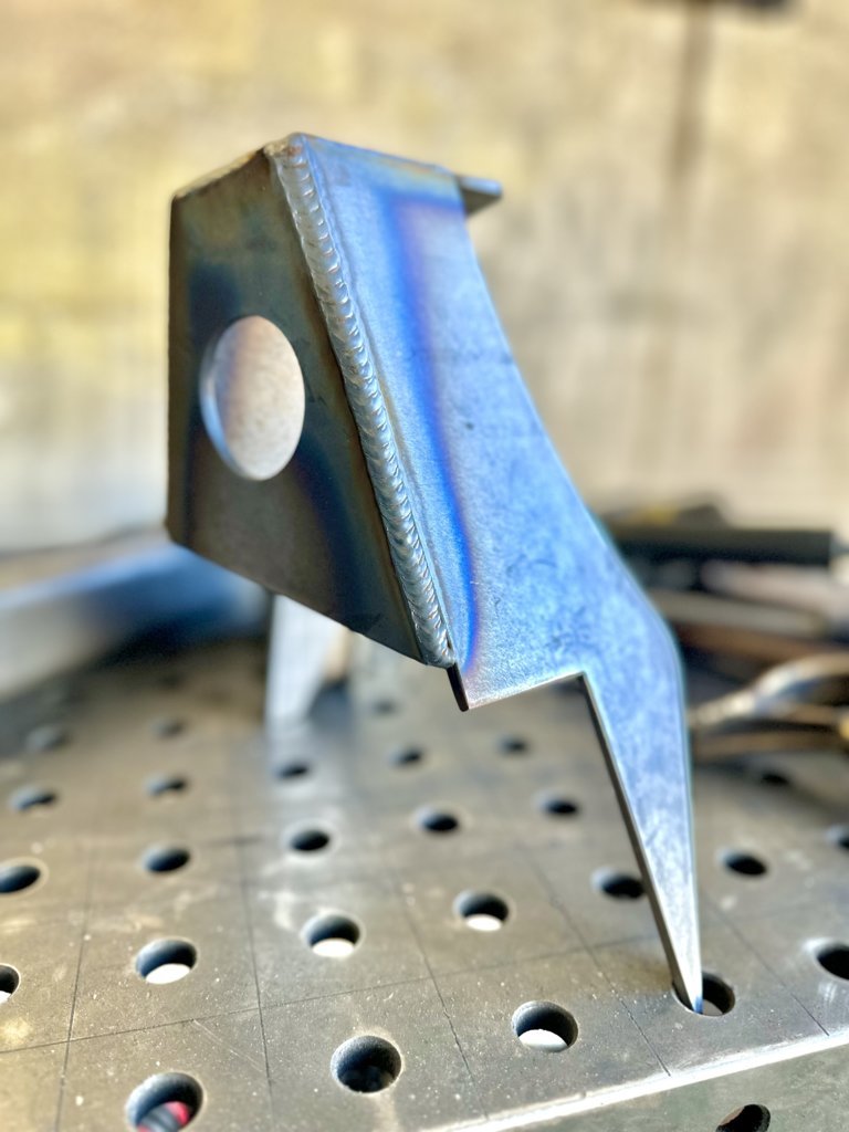

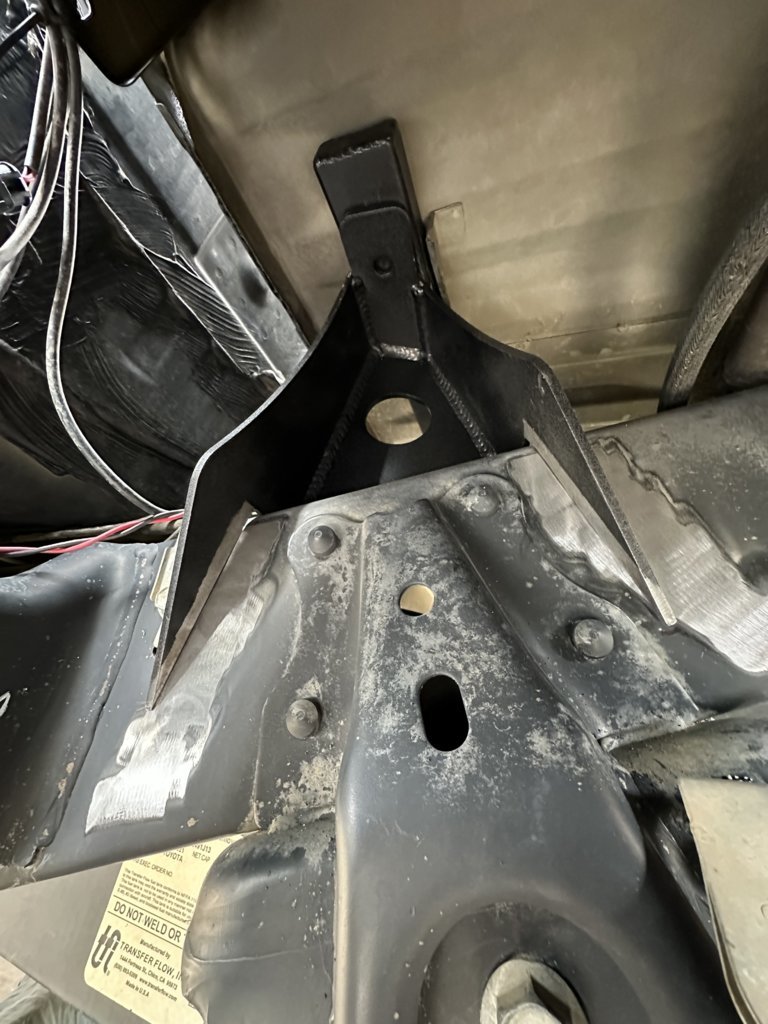

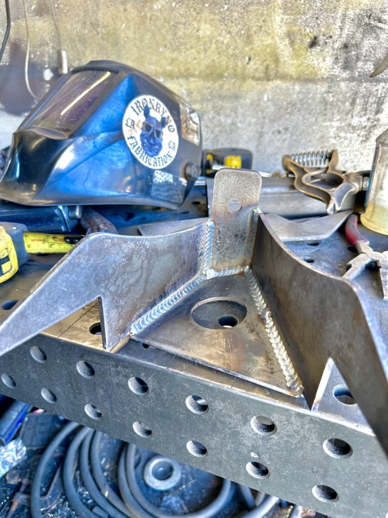

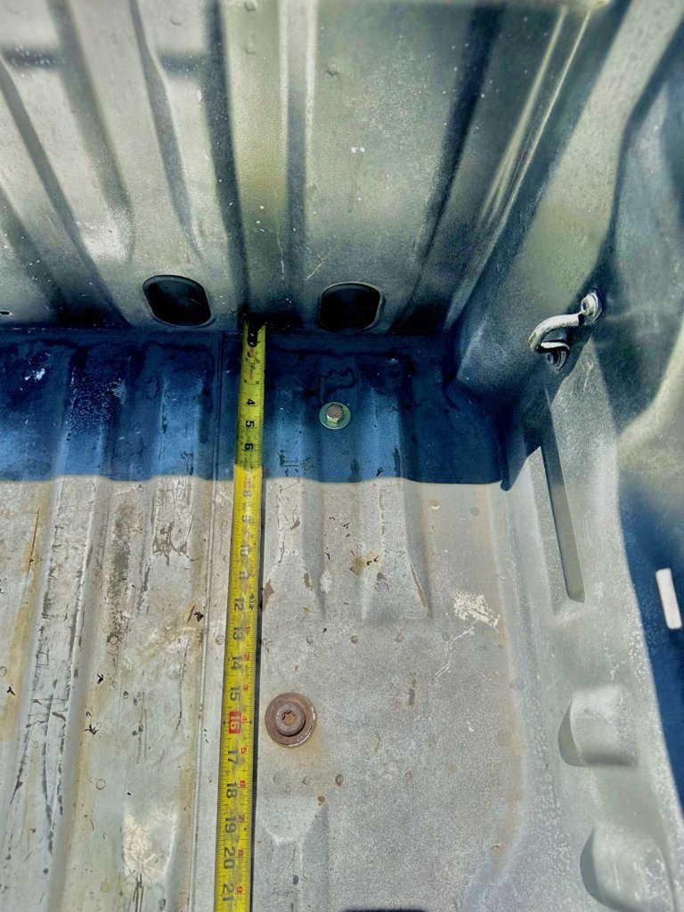

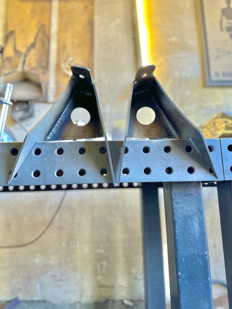

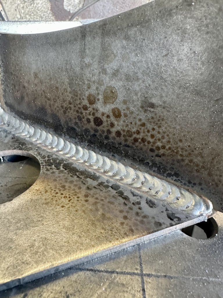

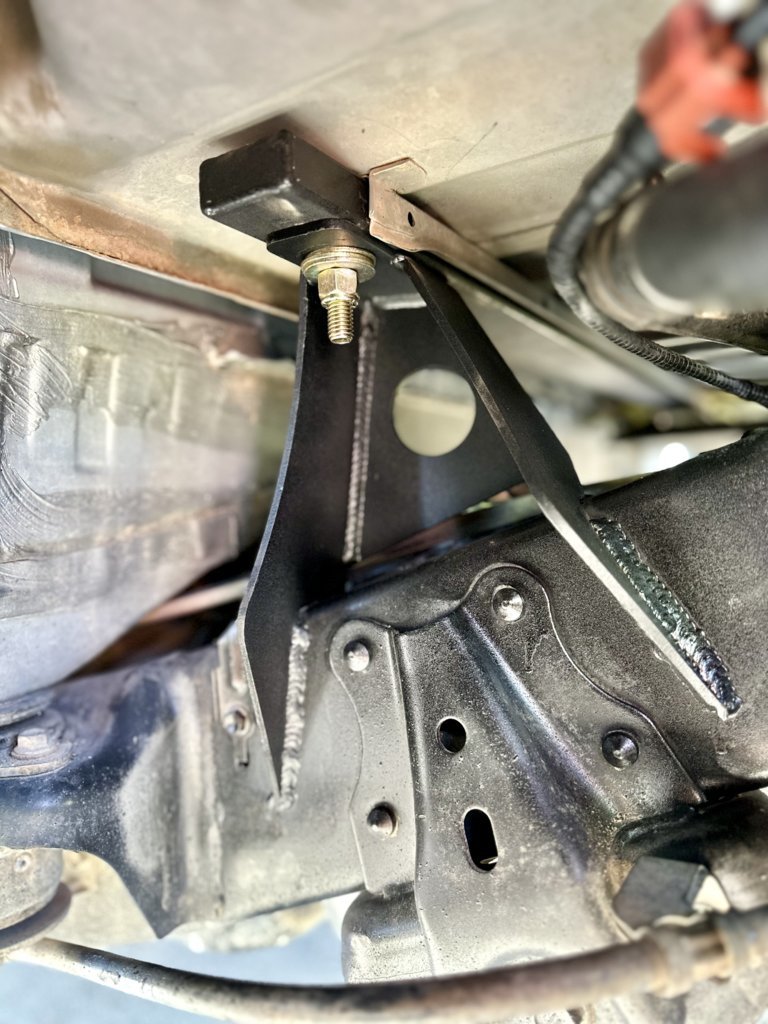

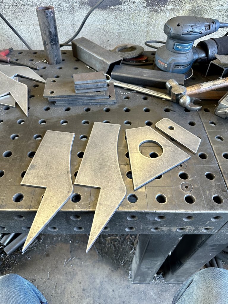

    A few months back my buddy Bijan @rcsbguy came to me with a project to solve an issue that I wasn’t aware was an issue in the first place. On the 2nd/2.5 gen Tundra RCSB and double cab standard bed, the front roughly 20” of the bed isn’t supported due to the front most bed mount being around 20” back from the behind the cab. Apparently when you throw a heavy camper or camping set up on the truck such as a GFC, Topo topper, 4 wheel camper, bed rack with a bunch of stuff loaded on it, these beds are cracking and collapsing towards the front. So Bijan brought his truck over and I came up with a simple “Bed support tower” that welds onto the frame and utilizes a crossbar between both sides to help support the front of the bed. The crossbar sits only about 4” back from the front of the bed which gives a ton more support to the front of the bed and reduces the chances of cracking or collapsing.

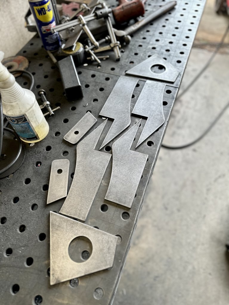

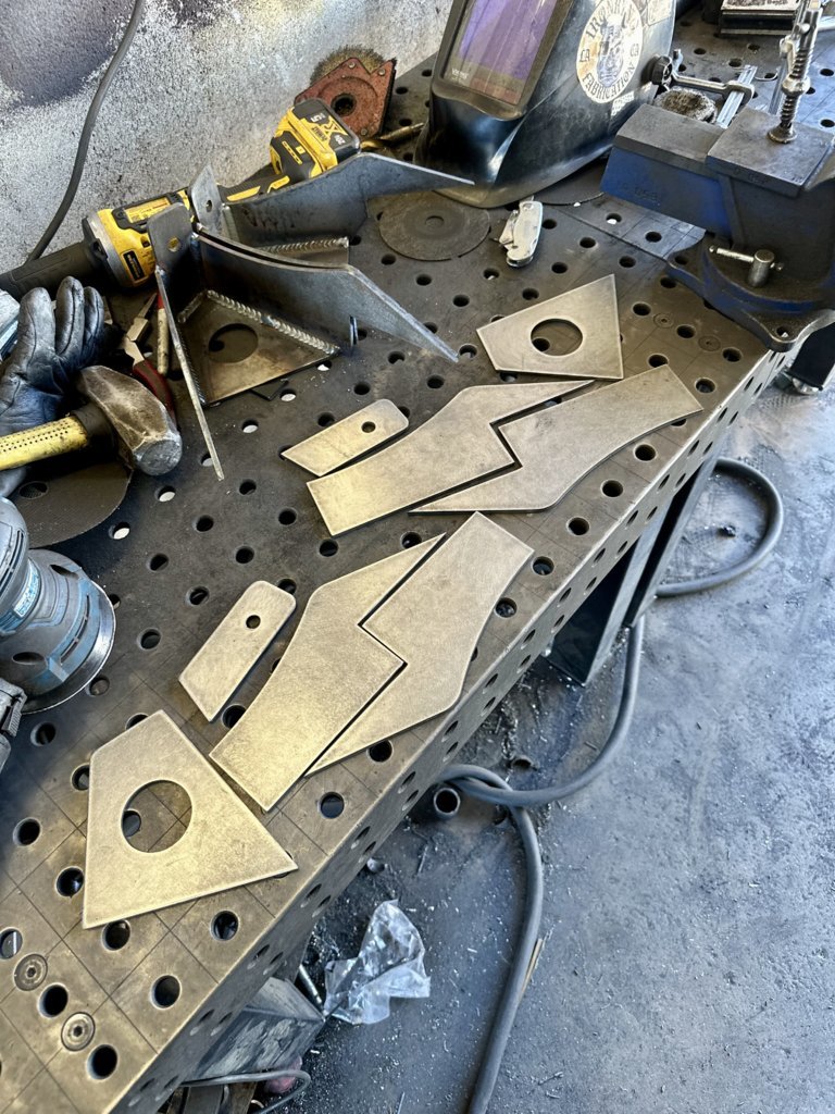

    My purpose for this post is that I’m offering these as a kit. I will cut out the plates and weld them together so that they’re ready for you to weld on to your truck. Anyone local to me I will be offering as a service as well.
    The crossbar is just 1x2” .120 wall rectangle tube and that will need to be sourced by you since it will kill shipping. It’s a 58” long piece.
    Anyone who is interested or has more questions I’d be happy to answer.
    Price for the kit is $250 and $27 shipping USPS flat rate box

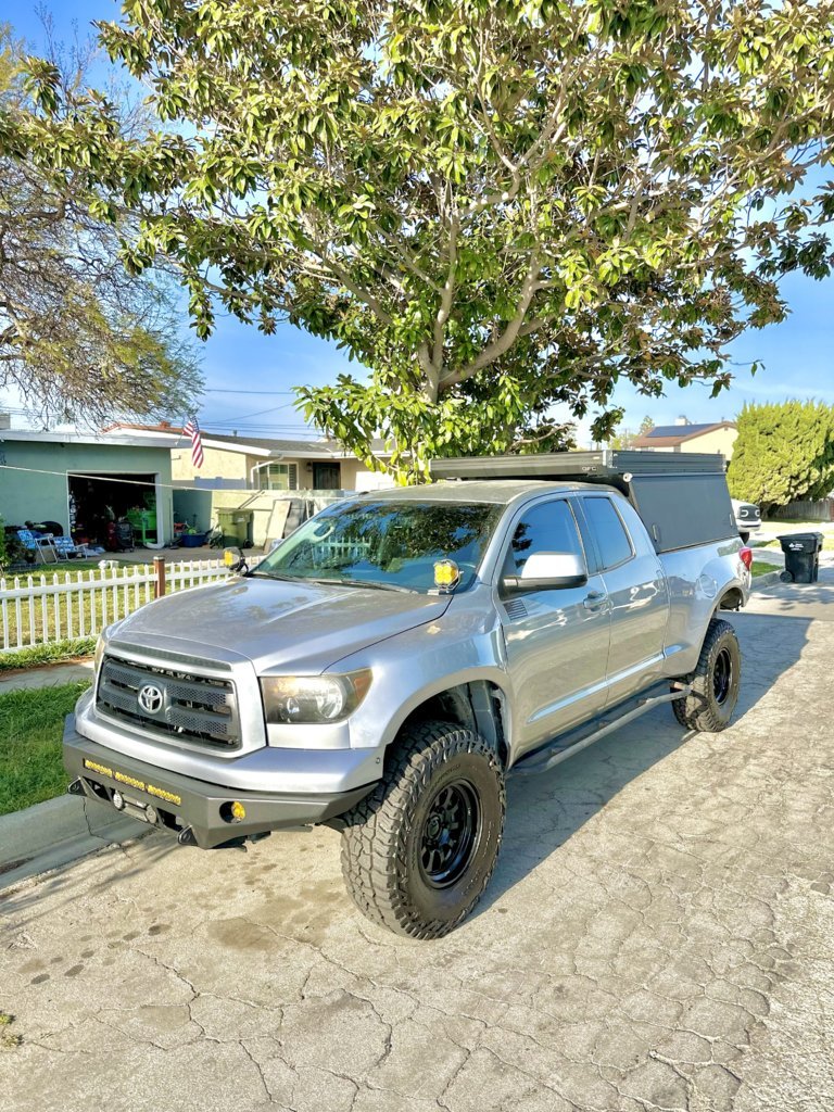

    Just did one for my guy Josh yesterday

    Closest to the cab. On the DCSB the closest bed mount to the front of the bed towards the cab is like 18”-20” and the frame tapers down so there’s no support there for the front end of the bed

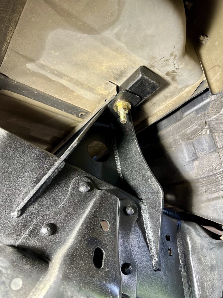

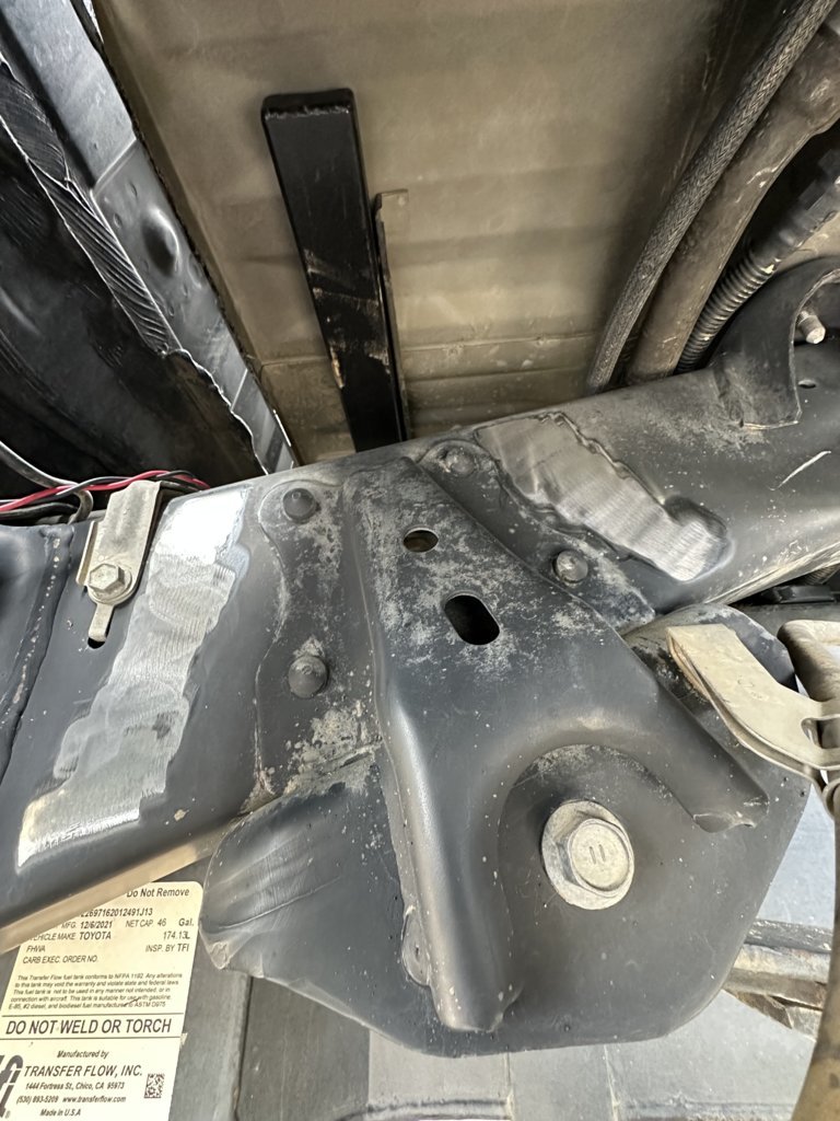

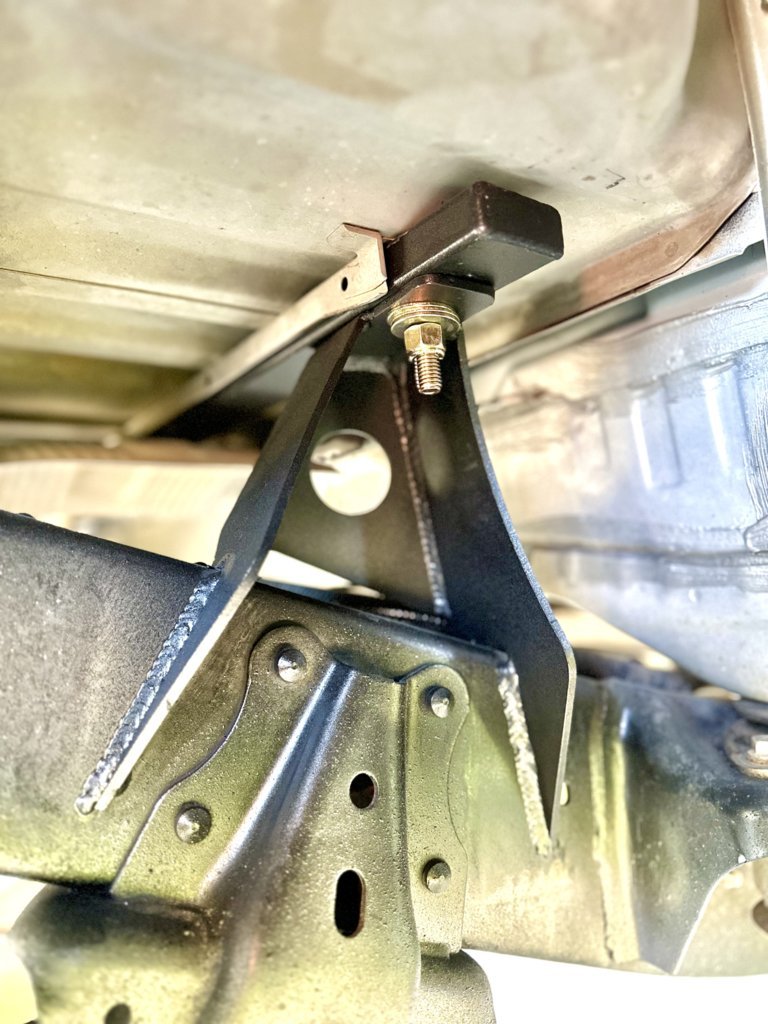

    Another set of Bed Support Towers for a Double Cab standard bed yesterday

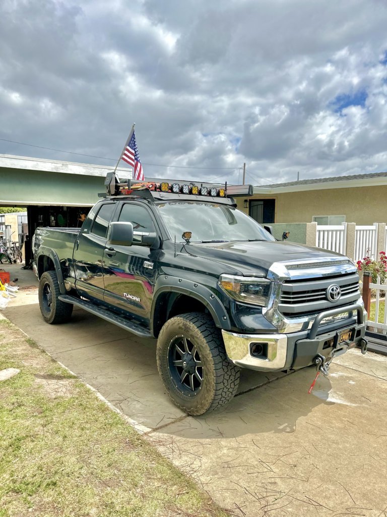

    Couple more sets installed in the last couple weeks

    I wonder if the frame flexing is going to begin causing cracks elsewhere now. Have you thought about or do these use a stiff rubber pad at the contact point to allow a little flex?
  18. May 17, 2025 at 11:13 AM
    rcsbguy
    rcsbguy New Member
    Jun 3, 2024
    #117908
    233
    FWIW if you ever pull your bed off, you’ll notice there are no bushings between the bed and frame.

    Bob
    2020 Tundra SR5
    3.5" lift

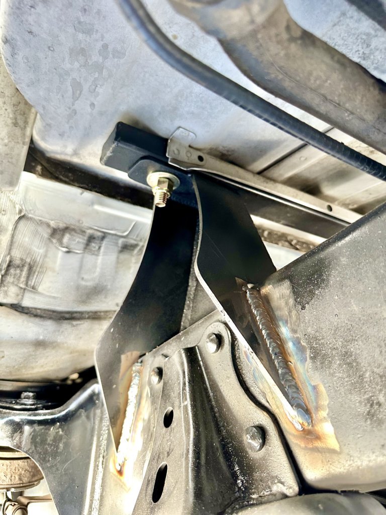

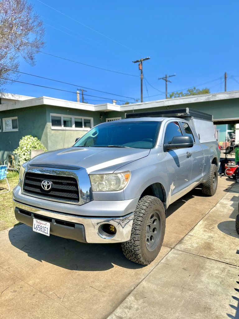

    A few weeks back Ryan, IronRhino Fabrication, hooked me up with a set of the bed supports for my 2020 extended cab tundra. The truck has had a smart cap and rooftop tent on it for the last 110K miles until April of this year when I purchased a Tune M1 lightweight topper. Within a week the over cab portion of the camper started bouncing off the antenna on the cab of the truck. The front floor of the bed had split at the spot welds that hold it to the front support under the bed causing it to dip down. With Ryan's braces welded on and a support bar the width of the front of the bed bolted to the underside the whole bed is much more rigid. I've had a lot of heavy material in the bed of the truck and have never had a problem until that camper. It acts like a giant lever arm on the unsupported front of the bed. If you are going to put any camper type top on your tundra long bed or or standard bed I highly recommend getting a set of these supports from Ryan. Your bed is eventually going to crack and cause a problem.
