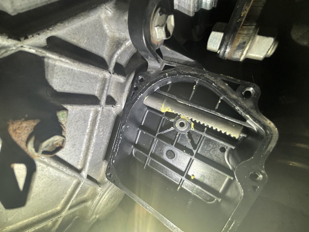

    Along these same lines with my 2010 Sequioa- all my motors are dandy but I want to properly set my gears. My 4LO Fork is only half way across. My 4HI fork is all the way out. To time my gears I’d like to make sure the selector is in the right position. Does this mean I’m in 2wd? I did a little test with jacking up my back end and I believe it’s only in 2wd. I’m making sure the 4HI for is supposed to be out.
    4HI Fork: (UPDATE, this is 4WD engaged)
    4LO Fork: (in high range)

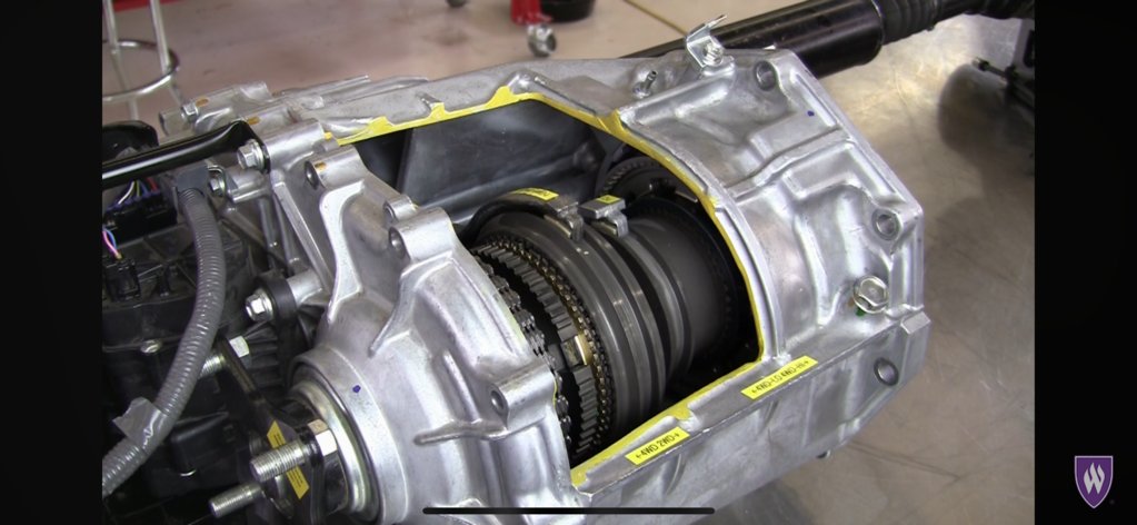

    Ok I’m answering my own question now bc I found this video that explains the fork positions. What I’m showing is 4HI. However, I wasn’t sure if my front axle was connected via the ADD. I was concerned that if I moved the 4HI fork in (to clock at 2wd) and the ADD was still in 4wd mode (connected the front 2 axels) I’d be back in error land. So I jacked up the front wheels and spun them. When I’d spin one, the other would counter rotate. This means ADD was in 4wd mode. Knowing that, I left the 4wd HI fork out and put the inside knob to 4HI. When I did the key to accessory, it clocked both the 4Hi and 4LO actuators correctly. I reassembled and 4HI worked fine. I could switch between 2HI and 4HI and center diff lock all with no issues.
    However, when I’d go from 4HI to 4LO, it would try but wouldn’t engage. It allowed me to move the selector back to 4HI and go about my way. My next move is to remove the 4LO actuator, yet again, but this time manually oscillate the fork to and fro to see if it’s just being stubborn. Maybe I just didn’t seat the gear properly.
    here’s a screenshot that shows the position of the fork and what it does.
    Video (8:00 minute mark)
    https://youtu.be/47m7QAPrpsI?si=qF1sKzmDkP8j_sh1
