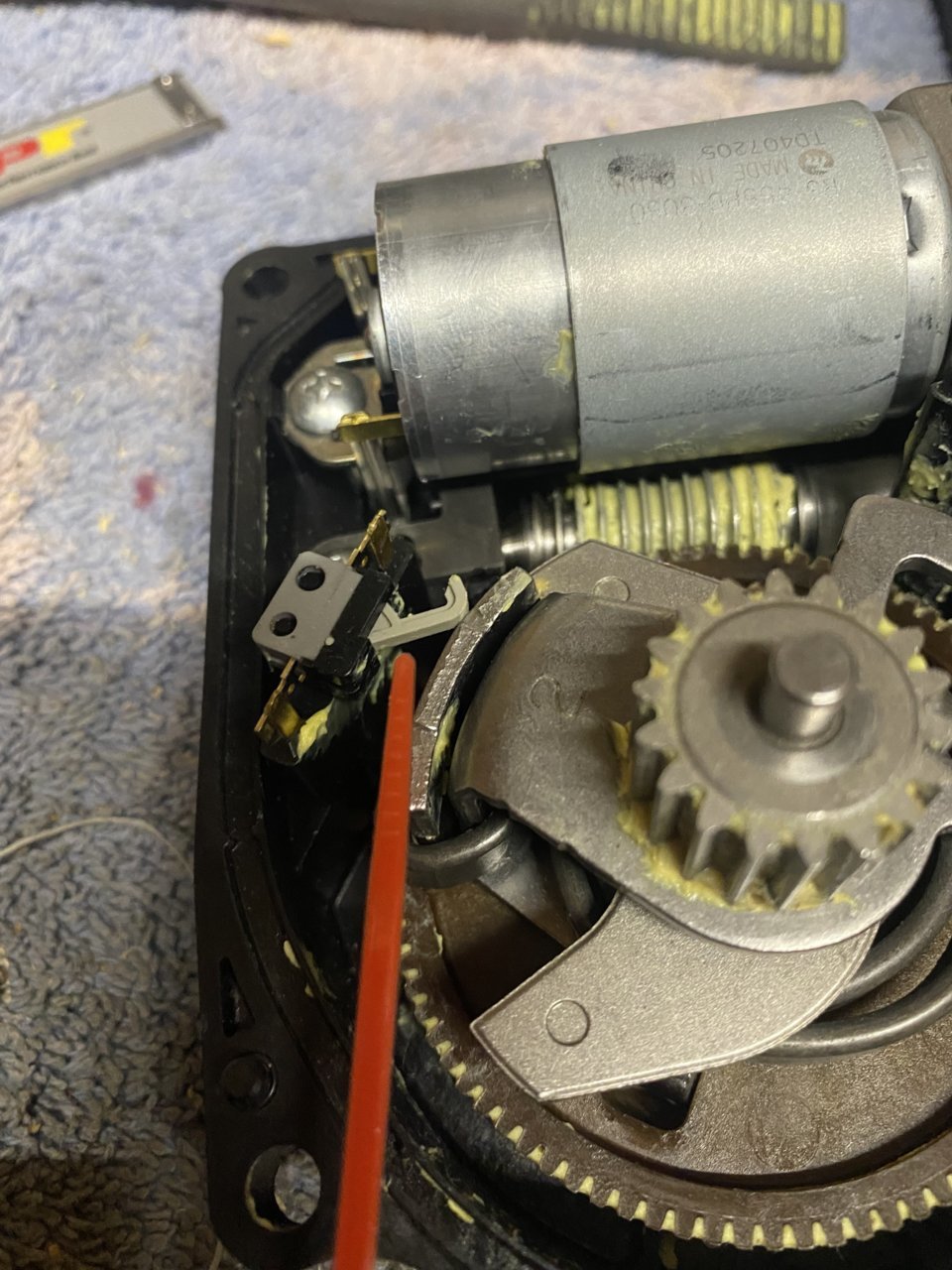

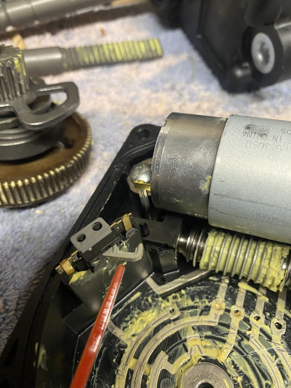

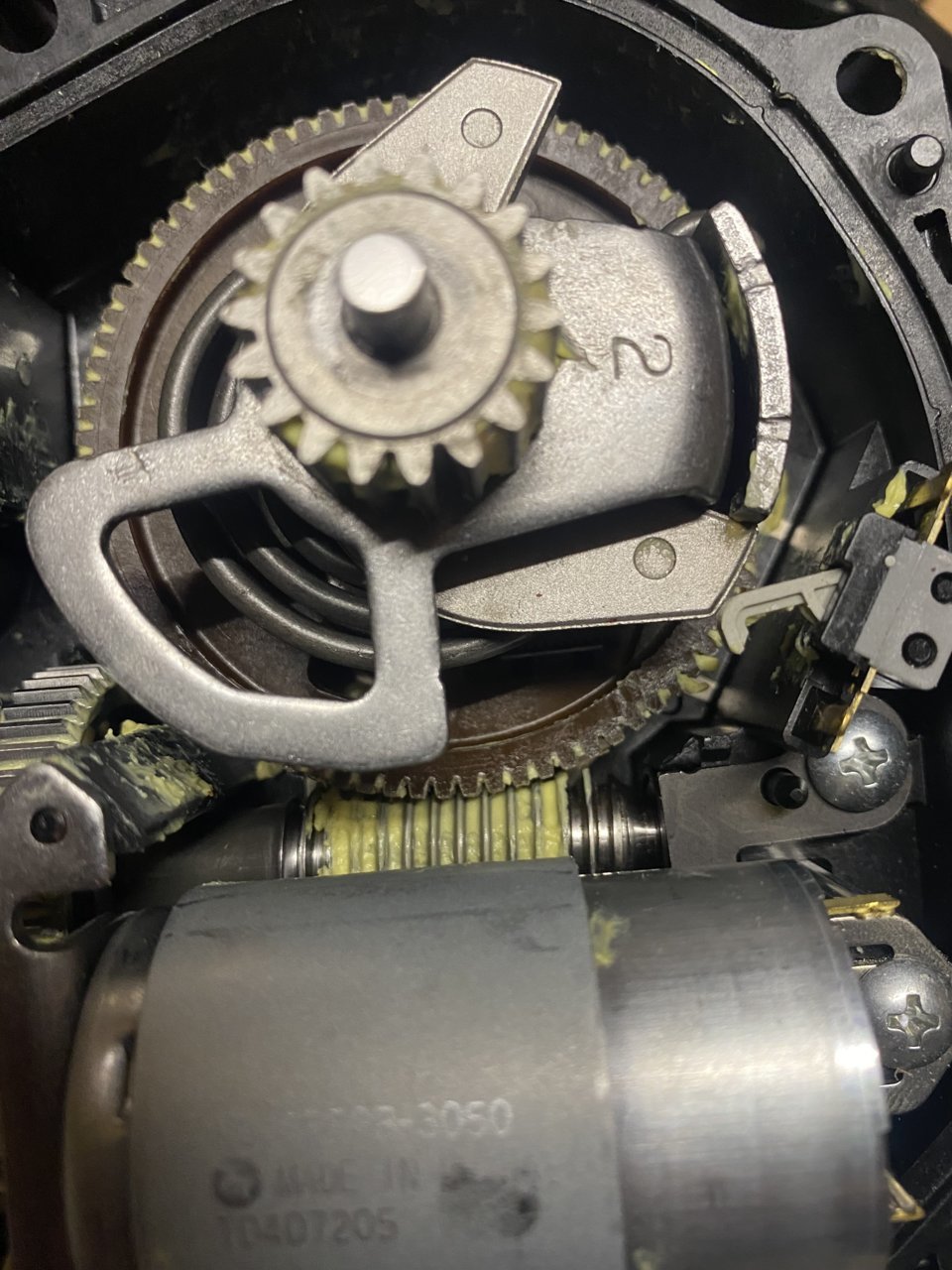

  5. Jul 5, 2022 at 5:41 PM
    #95
    frodotx
    frodotx New Member
    Sep 15, 2021
    #68092
    10
    2007 TRD Limited
    the micro switch in question.
    This is the approximate “clocking” of the gear that worked for me. “V@pors” has a description for aligning the gear in this thread. Note the micro-switch is not in the position that has worked for other members. I don’t know why it was different for mine. I tried every other option without success. I was getting very close to taking it to a dealer…. And we know where that goes. If you’re having difficulty try “v@pors” method. What do you have to lose? I got pretty good at removing and replacing the top “hat”. Oh… and the dental floss technique of holding the gears for reinstall works very well. I don’t recall who posted that hack.
    Yotaholic, zidaro and baraynavab like this.
  6. Aug 2, 2022 at 7:45 AM
    #96
    Yotaholic
    Yotaholic Amateur Professional
    Nov 24, 2020
    #55308
    172
    Lone Star Republic
    2011 TRD DC 4.6
    Your first and third photo seem to have the microswitch in two different positions. Am I looking at it wrong? I'm going on 2 years with inop 4wd :anonymous:
  7. Aug 2, 2022 at 4:22 PM
    #97
    frodotx
    frodotx New Member
    Sep 15, 2021
    #68092
    10
    2007 TRD Limited
    The photos were to identify the location of the microswitch. They were not identifying how they should calibrated.
    got to post #76 by "Vapors". he describes how he aligned gears. His positioning worked!
