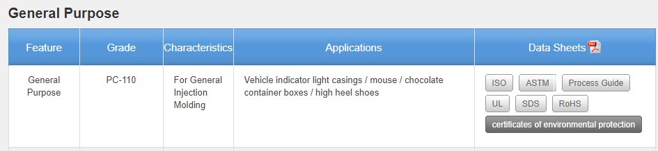

    The lamps are made with Chimei Wonderlite polycarbonate. This plastic, with the chosen UV-protective coating system, is rated to withstand just 3 years of sun exposure in Florida and Arizona before developing noticeable haze.
    Overall, I think the xB LEDs are a solid set of headlamps. The photometrics are better than a '06 Chrysler 300C, so Morimoto/TRS has that going for them.
    My only wish for the next generation would be that Morimoto/TRS chooses a 5 year plastic, instead of a 3 year plastic. Greater durability would be nice for the price they're asking.
