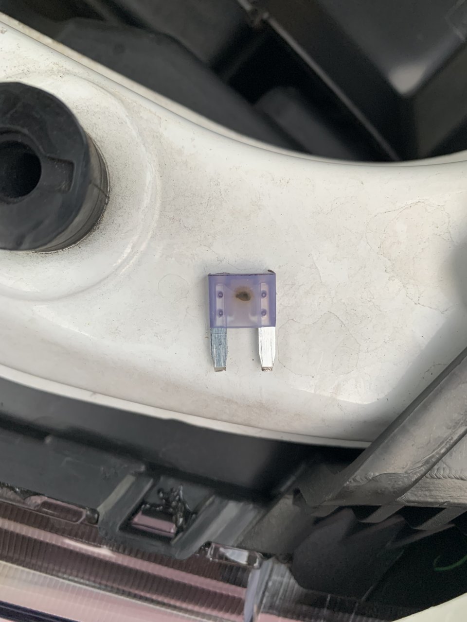

    So I have a pair of the new amber leds @Headlight Revolution i ordered and all was well but today went to turn the truck on and the drls are not lighting up until I turn on my parking lights and low beam headlights… when I go back to drls only I get nothing… @Headlight Revolution

    Where do you have the fuse tap plugged in? It should go in the 10A IGN fuse slot.

    It is… over the last month they worked fine until yesterday

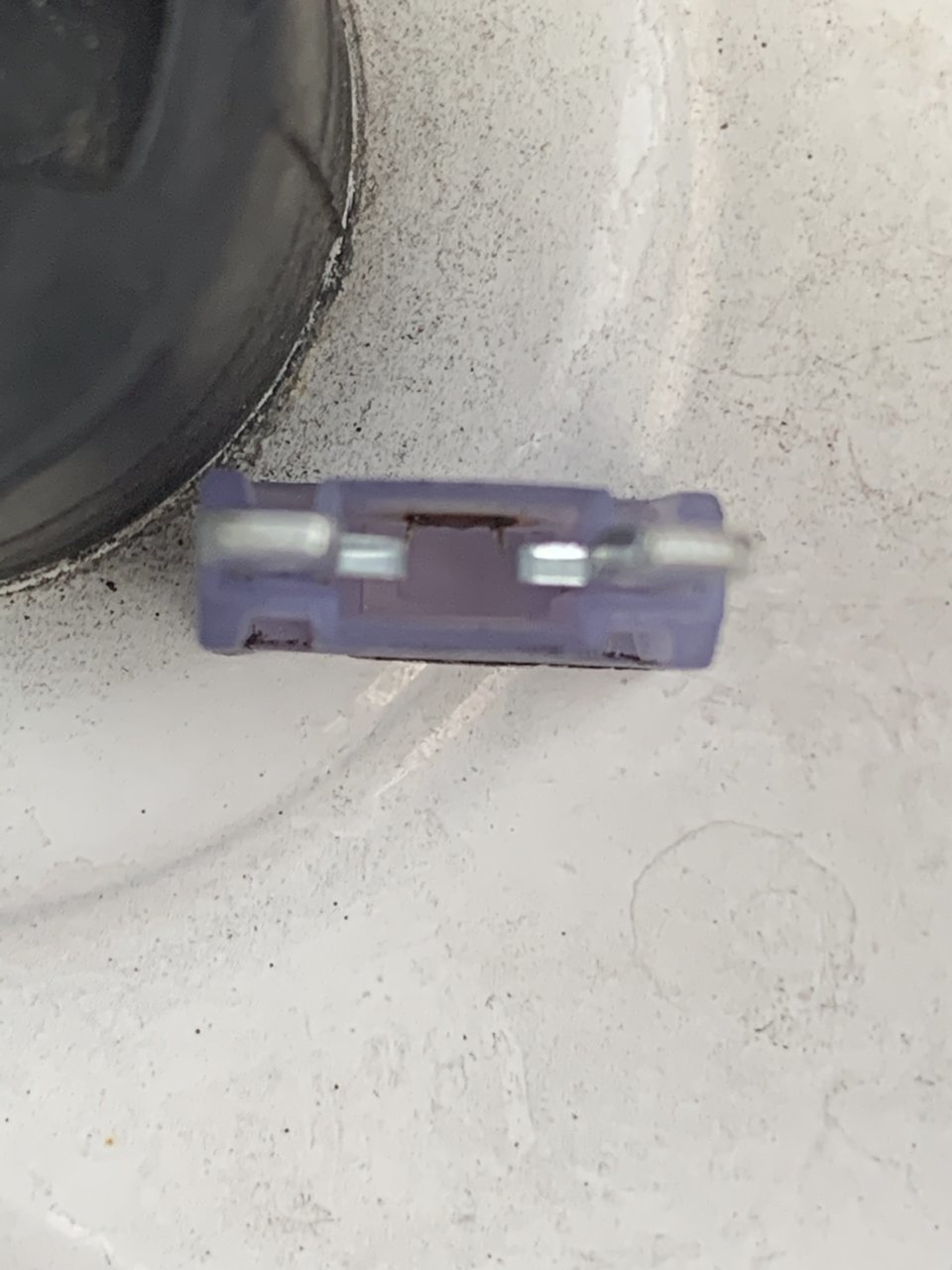

    here is my 3 amp fuse that’s tied into the fuse tap….. doesn’t look right

    I'm thinking that fuse is too small at 3 amps. Caleb @Headlight Revolution, aren't those fuse taps supposed to be 10 amp?

    No worries my man! Go ahead and install a 5A fuse in there if you have any issues, that'll solve your problem! :) Good question!

    I had the same problem. Burnrd a hole in mine too. I remember the same thing happening when the whites came out. I picked up 5A fuses.
