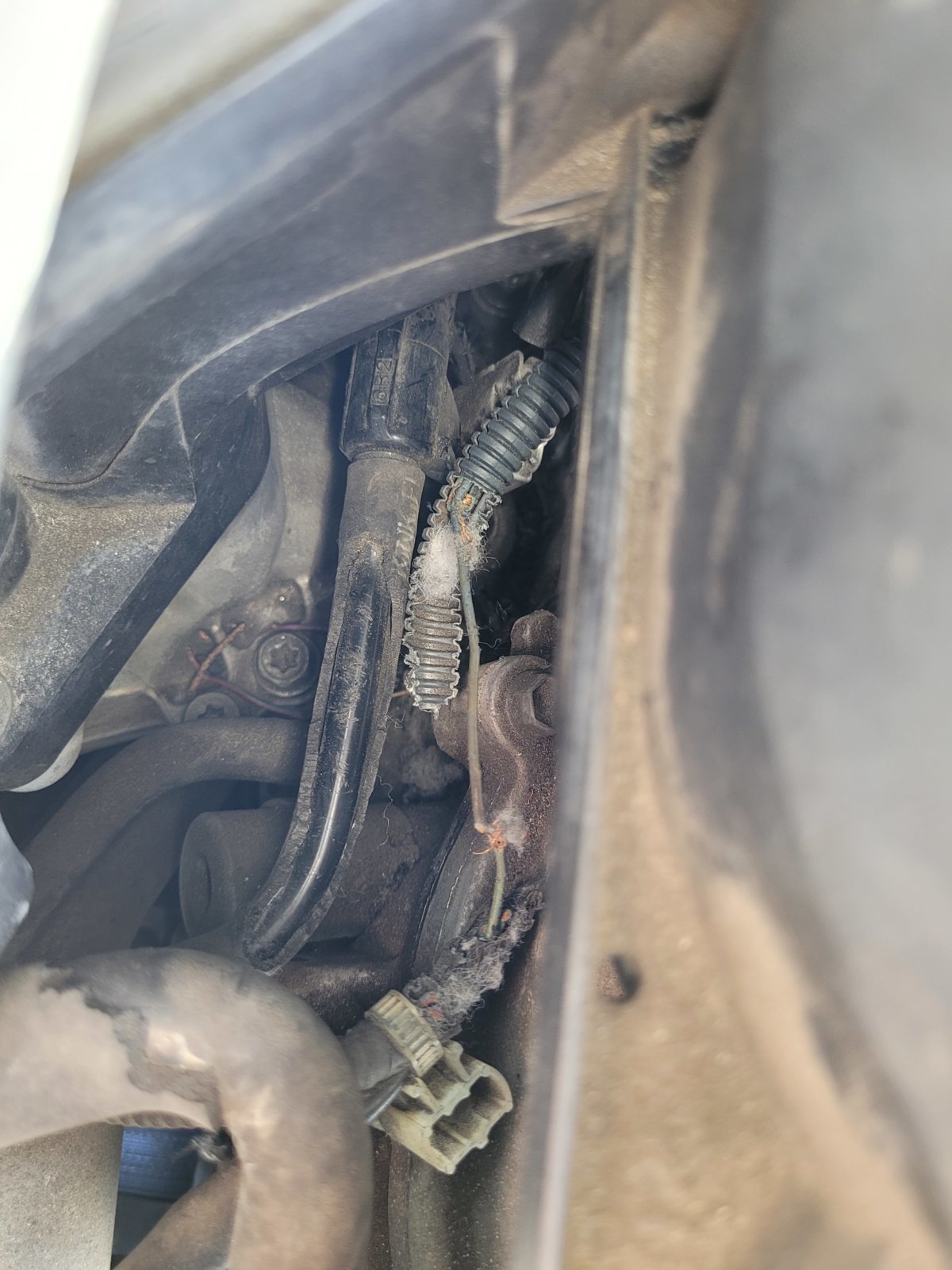

    HAPPY TO REPORT , I think I found my problem.
    even though I had looked at wires to chewing, I actually today removed the engine top cover and found a couple chewed wires on the top of the engine between the heads. Both wires go to sensors or plugs.
    Kind of tough to see exactly where that are going but tomorrow will access the area to get a better look. One I think goes to the injector sensor (the other end seems to be connected to the fuel line), other one seems to be the knock sensor 1. 2 plug wires chewed through m on with 2 wires one with 3. Hopefully I can just splice in some new wires. thank you everyone. Glad I didn't mess with the fuel pump
    Again I couldn't thank everyone enough.
    Freakin rodents!!!

    Truck runs, wires were a real pain to get to. But i was able to fix them. The rodents chewed wires basically in the gap underneath the intake manifold. I had looked up on top at the wires and from below but had really taken a flash light and looked down deep into the motor.
    Thank to all for helping

    Rodent damage is one of the things in the megathread as a legit issue with these trucks. Why it seems to be so much more than other vehicles I’ve owned over the decades is beyond me, but …
    I am happy your saga is over, I think the “ran out of gas, now it won’t start” was a red herring, so I gotta ask: how much time passed between running out of gas, and trying to restart? Hours, days, weeks, months, years? Is it possible you actually still had gas, albeit not a ton, but the truck actually died because of chewing?
