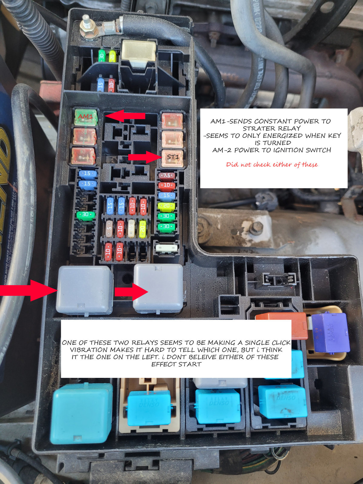

    Checked the neutral safety switch by putting the truck in neutral and trying to start(didn't start)- will try to check the pin in the starter relay to see if I can get a reading there.
    All my true idiot moment might come, and hopefully it will be finding out either the AM-1 (40amp) OR ST-1 (30 amp) fuse, that I didn't check (like a fool) is the issue.
    I wasn't sure that they pulled out. Pick enclosed of fuse/relay box, I had only pulled some of the relays(tested) which seemed pertinent, checked all the small blade fuses,
    but didn't check those bigger fuses. Hopefully my stupidity has an end. (pic enclosed)
    Also big grey relay now seem to be making 1 check when turning the key, think its the one on the left
    I need to end this electrical madness!!
  6. Feb 27, 2024 at 11:41 AM
    #36
    scooterprint
    scooterprint Idiot with a wrench
    Mar 11, 2020
    #43841
    373
    Jeremy
    Conway, AR
    ‘04 DC 4x4
    Bone stock
    Pull one of the relays and test for click. If that doesn't click, you know the one you pulled is your clicker.
    Relays for starter and fuel pump can be jumped with some wire to test for crank and fuel.
