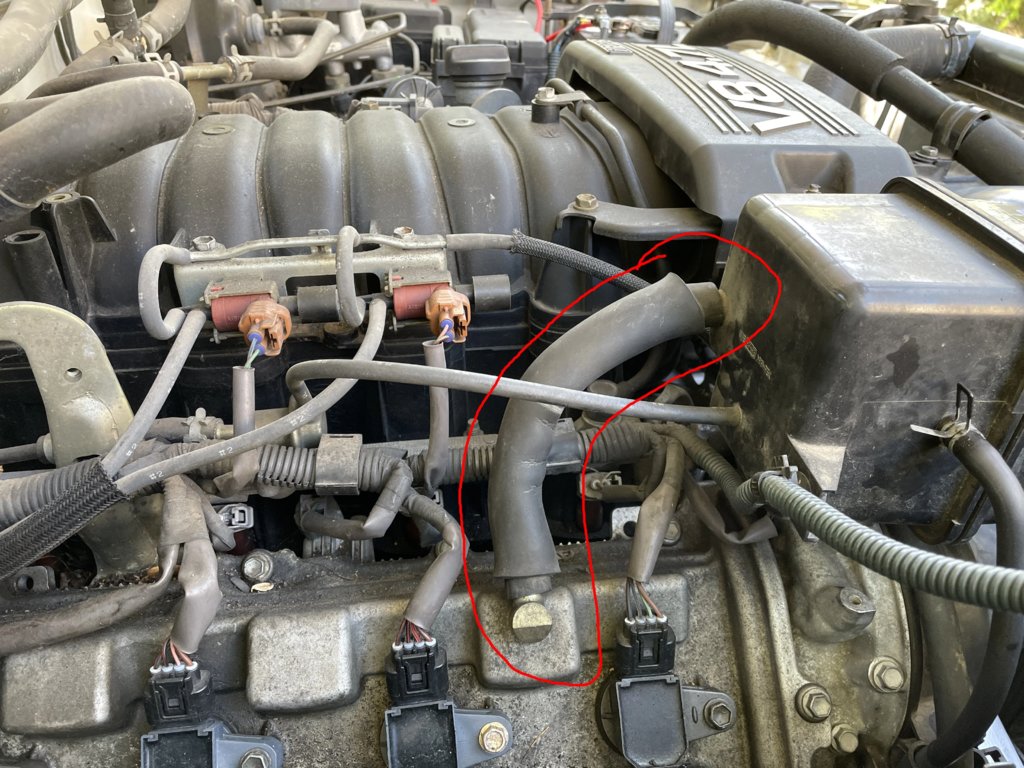

    Okay, so I might have screwed up a bit? The PCV that plugs into the back of the air intake has been unplugged for a month or more.. around when I did the timing belt change, I just noticed while I was doing a check of the engine and saw it was off on the engine side, not the side of the intake. Is this super bad? I just did the oil a few days ago and it wasn't burned, check the oil again after plugging it back in and the oil seems fine, normal levels, very new color still. I probably drove 2k+ miles with it unplugged. Now that it is plugged in, the ticking noise I was hearing before changing the timing belt is back as a side note. not my image below, but the same hose.

    Passenger side head actually doesn't see as much issue with varnish/buildup, so I'm thinking you're fine.
    Check the ends of the hose. They like to crack, and it's easier for them to pop loose. My 2006 at 70k(ish) origianl miles were cracked. I replaced both hoses, which on OEM comes with foams included, about 6months ago.

    Concur with @shifty` - it’s a vent but not connected vacuum like PCV hose. There might be a little by Venturi effect of the air intake but you’ll be fine. That part is still available for 2005-6 but discontinued for earlier FGTs. If yours is split or brittle replace now.

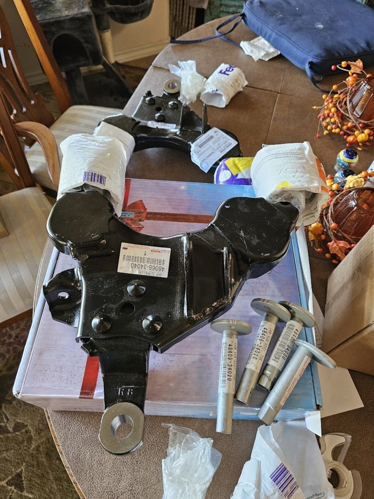

    Still a work in progress, got new LCA + hardware on the way, dunno what else I'm going to throw on at this time. I have around $4.5k as a "truck fund" and I'm not sure what to spend it on at this point. Appreciate all the help you guys have provided. (hood looks way better imo).
