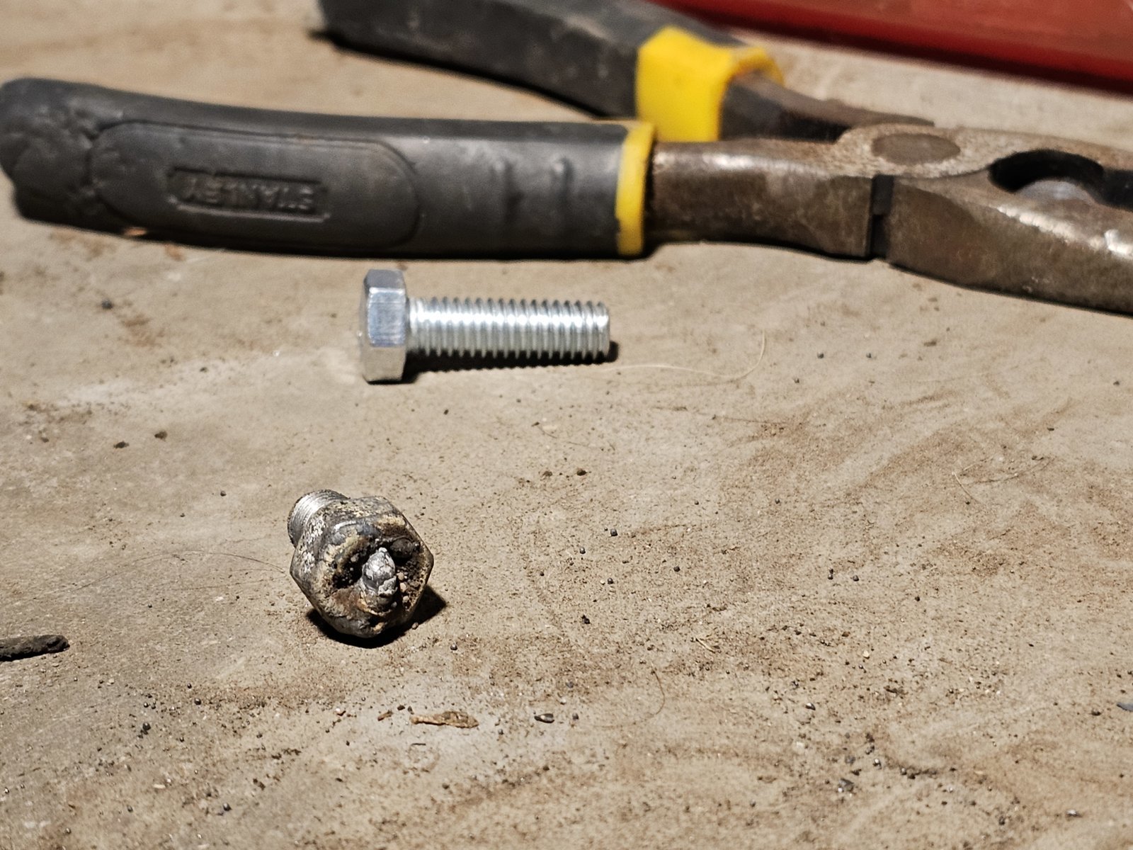

    I was going to say drill and extract, but I like your buddy's idea better.

    I actually have a question regarding that, do you happen to know what metal the engine is casted in? I know Iron, but is it white iron or? I tried to google, but it only gave me cast iron. (Apparently this is the best time for me to learn proper welding so hes making me do the welding). Will flux core from a mig welder stick to the block?

    Sure as flux will. I've seen 3/4" plate get stuck together with flux.

    So what should I use to make sure it doesn't stick to the block? I'm trying to get just the bolt out and not weld the bolt in there lol

    Do practice passes.
    Maybe try running a .030 wire instead of .035 to be a little more accurate.
    do more practice passes.

    I'd probably consider another method first like drilling and extracting. But if I were to weld it I'd consider an antispatter spray and then using a nut with ID smaller than the bolt OD with the weld tacking the center hole. Could run a test by threading a bolt flush with another nut to simulate. Summoning @JakeJake for more thoughts.

    The engine is cast iron.
    But the part the tension bolts too is part of the oil pump/front cover and is aluminum iirc.

    That bolt is a perfect candidate to weld a nut on, I really wouldn't think twice about it. I typically go in dry, fill the bolt up until its cherry red, and then let it cool a bit before spinning it out. The heat helps un stick what was left of the previous fastener.

    Is 10 ft./lb. within the accuracy range of that torque wrench or might it need to have the accuracy verified or be calibrated?

    That would be amazing, still in the holding pattern for the welder to arrive, when I was comparing the parts of the block, that area did look different compared to the rest of it. It looks like a bolted on cover.
    I have no idea, no other bolt besides that one failed, it's a brand new torque wrench so I assumed I was golden.

    I usually test them against a torque adapter like the $50 Quinn at harbor freight. Larger wrenches like one that goes up to 150 ft lbs might not have good accuracy at low ranges, so for 10 ft lbs I'd probably be using a 1/4" in lb wrench and convert to ft. lbs. Even a 3/8" 5-80 ft lb that has accuracy at top 20% of scale may not be that accurate at 10 ft lbs. The wrench you're using should claim it's accuracy range. And again, I test them after purchase and occassionally thereafter against the claim. Also can get a feel over time of what 10, 20, 90, and 132 ft lbs feels like with different wrench lengths so can sense when they are malfunctioning.

    For low torques I have a newton meter/inch-pound torque wrench. Like ToyotaDude said, any torque wrench, when you're at the lowest or highest end of its scale, is going to be far less accurate than its middle range.
    Sometimes bolts just break though.

    Check it with a magnet... If not magnetic its aluminum.

    You absolute genius, I totally forgot about that, I just ran out and it is... NOT magnetic! Its Aluminum! Thank you!!

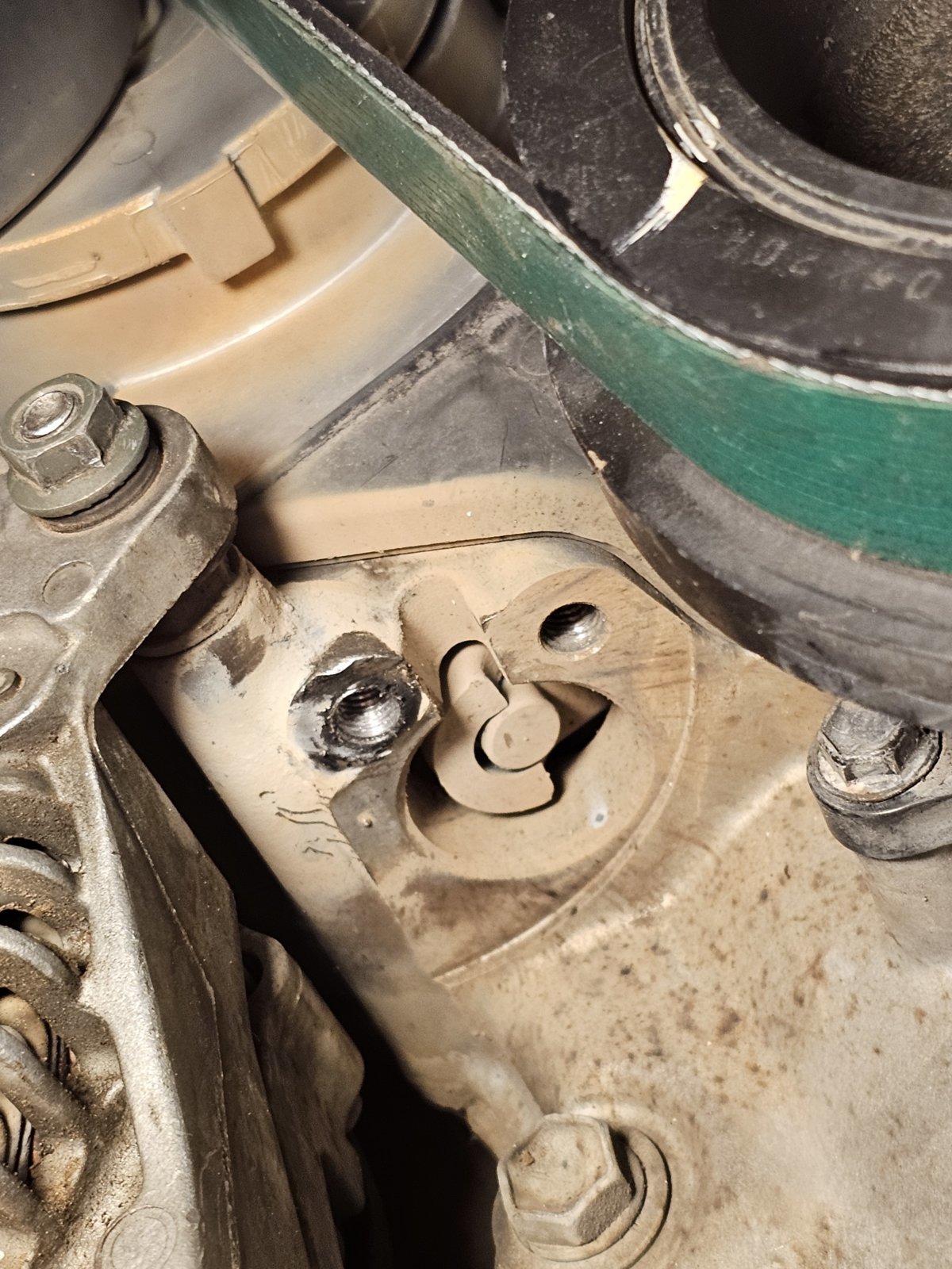

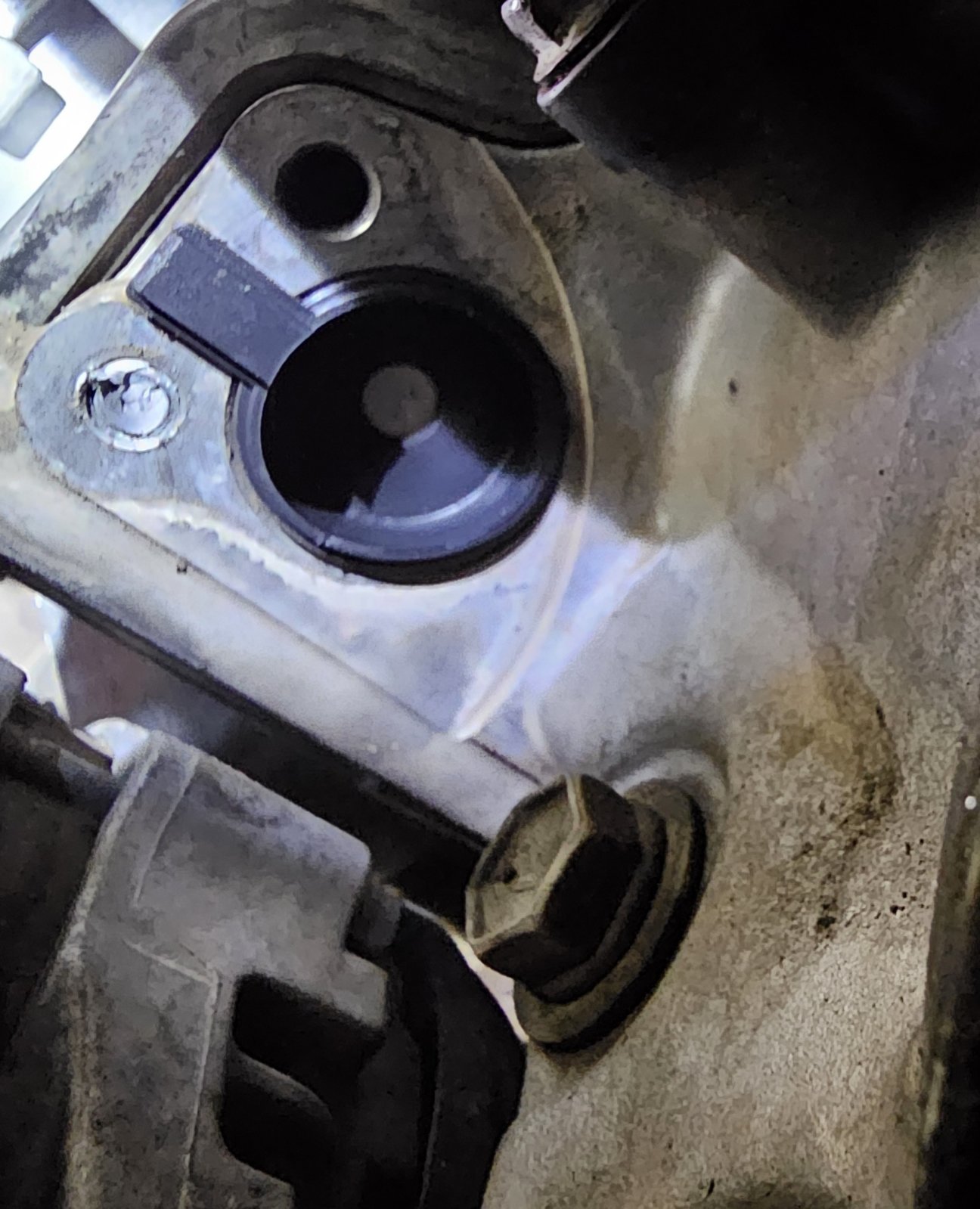

    I got it out, took a few attempts because of the limited working room. Ordered new bolts, should be here Wednesday.

    Nice work! Threads in the housing look ok?

    Yup, a little dirty, but I'm going to hit it with some parts cleaner and a brush.

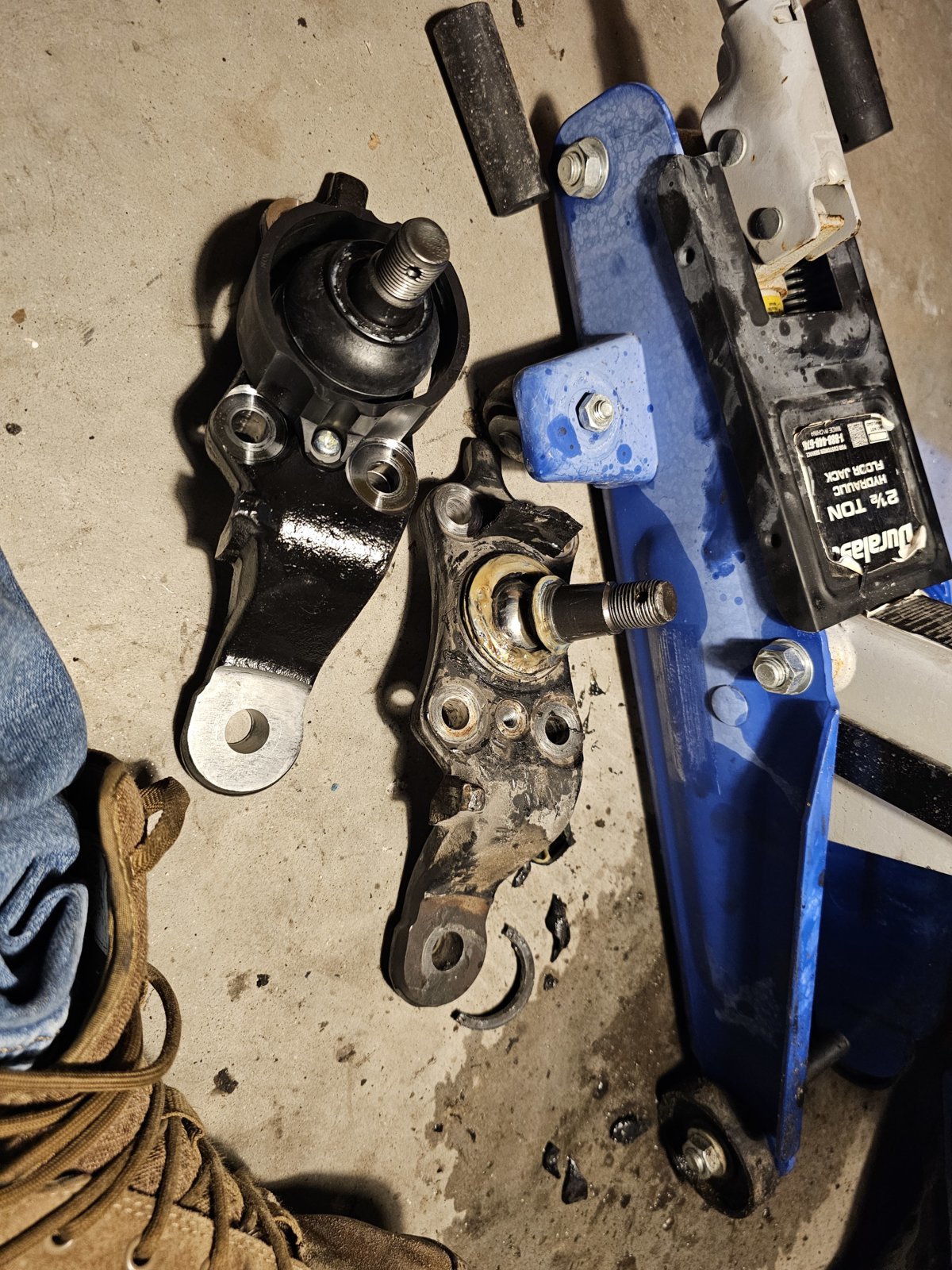

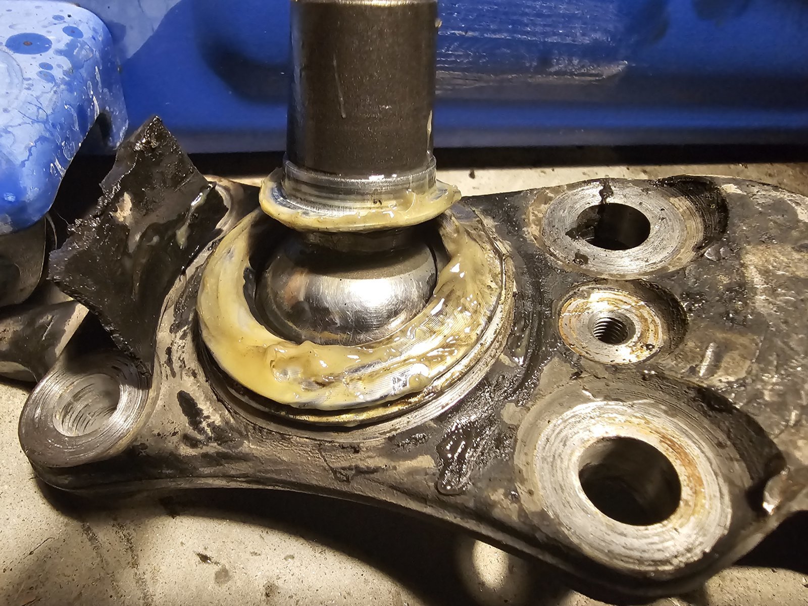

    These are the original LBJ that were put on the truck, it's insane how good of condition they're in. I almost feel like I shouldn't have bother to swap them out, though they were significantly broken in, there was no play in the joint at all.

    Nice.
    Doesn't matter, but I hear you. This isn't a part you let wear out before replacing. It's something to replace every 100,000 or so, regardless of condition, or anytime you buy a truck and aren't sure when they were last replaced, regardless of condition.
    Maybe someone on the facebook site will buy your old ones :)

    Yep, it's like car insurance or seat belts. Seat belt has never saved me from flying out a window, but I still buckle up every time, knowing if the time ever comes, I don't want to fly out the window. And insurance-wise, until recently when someone ran me off the road in the wife's SUV and my tire bumped a parked Tesla's front bumper, I can't tell you the last time I've had an incident where someone else's insurance failed to cover it. And yet I've paid tens of thousands of dollars into car insurance over the last couple decades.
    Some things you just handle proactively, pay up front, all in anticipation of an event where it's going to pay off. Sometimes the payoff is "a normal day without incident".
