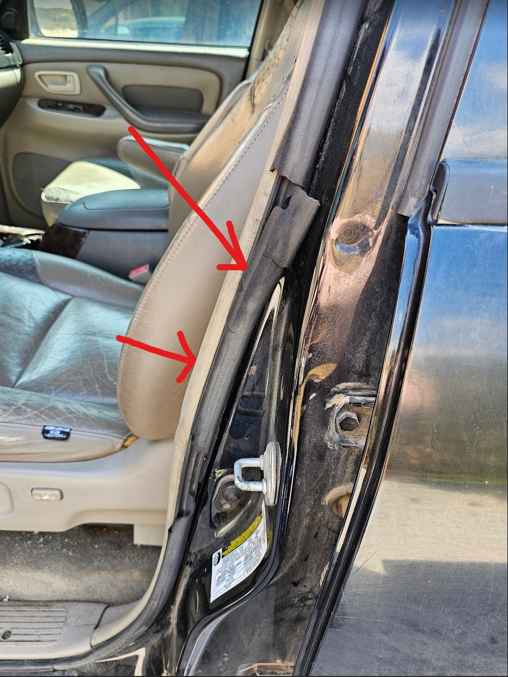

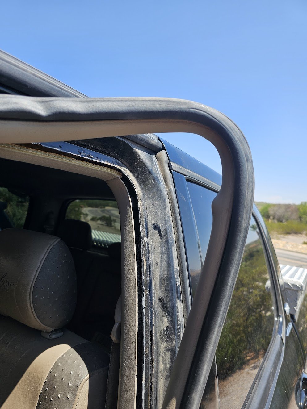

    Does anyone know if these 62312-0C030-E1 are the right part for the door seal? I'm trying to replace mine and I have this lip that goes over the interior panels, I just ordered door seal that was "an exact fit" for mine, but did not have this interior lip, 62312-0C010 was the part I ordered, and the 62312-0C030-E1 is the part the dealer at Ourisman told me is the correct part, but the image attached doesn't match at all. Is this a Lucchese issue only? The gap in the panel is really bothering me.

    The "E1" on the end of the number would suggest it's got something on it that's beige/fawn/oak in color. Can you show us a picture with an arrow scribbled on it for the part you're hunting?

    2006 Tundra Limited DC 4.7 4WD

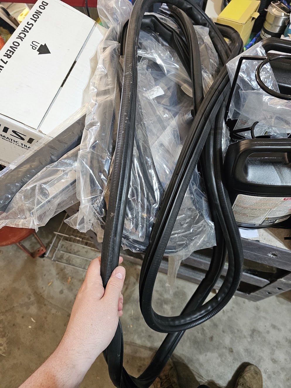

    This is what I'm looking for:
    This is what I got:

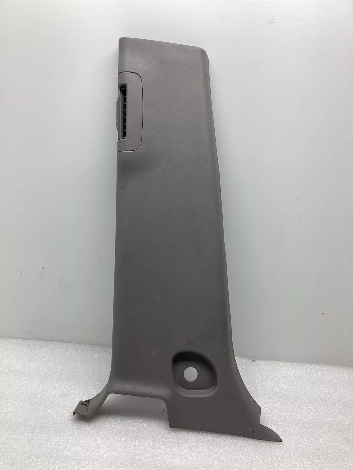

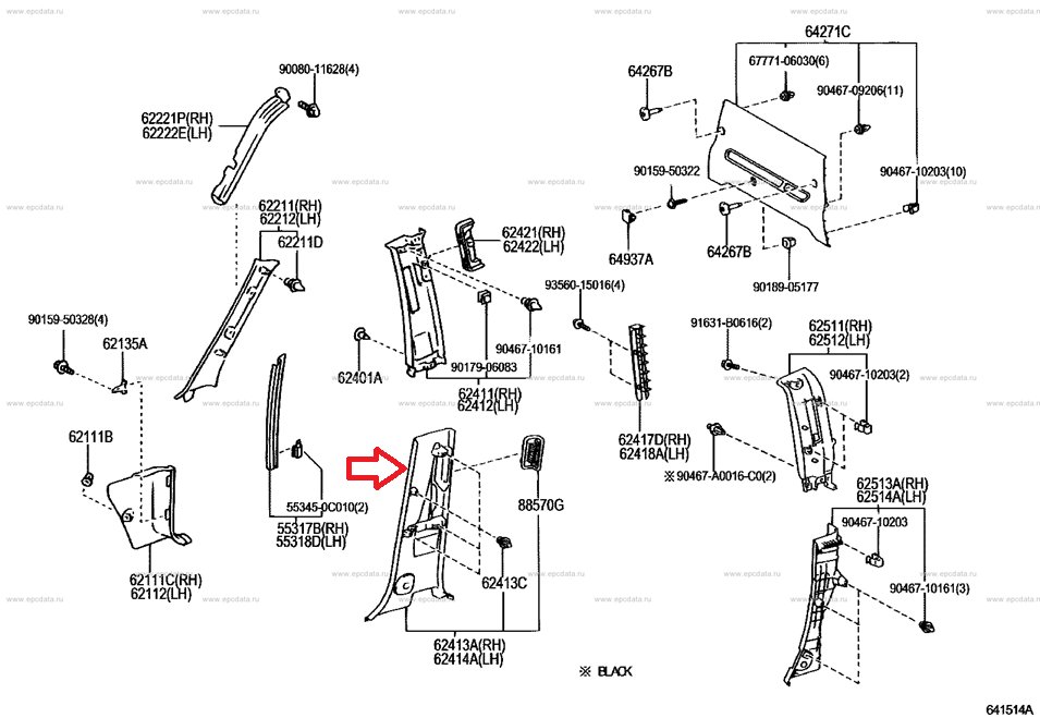

    Looks like you needed that seal anyhow. So you’re looking for the plastic cover for the B-pilllar (plastic cover over the metal between the doors). Junkyard is your best bet. The Toyota part will surely cost at least $100-150, probably more like $175-225.

    They're one single combined piece, the door seal goes over the B-pillar into the interior. That's what has me confused, I can't find one that is both like what I have currently.

    In almost every vehicle I've owned, that colored plastic piece actually snaps over the seal, and digs into it so tight you may not realize it's one piece. In the exploded diagrams, it's this piece:

    In your case, I *think* (emphasis on THINK) the part number is 62402-0C010-E1 and it should look roughly like this, although I don't think this is "E1" (tan/beige) so this may not be the right color, it's the only example I can find easily to show the shape of the part.

    Oh, and if you pop the trim piece off, many of the plastic pieces have a part number molded into them in the format of XXXXX-XXXXX, sometimes with an extra -XX on the end. If you pop the piece off,that may give away that either (A) I'm right about the piece being larger than you're thinking or (B) give you the part number you need to re-order ... just know, on the colored parts, they don't always include a -XX letter/number combo on the end to define the color (i.e. -E0, -E1, -B0, -B1 or whatever ... E's are shades of brown, Bs are shades of grey usually)

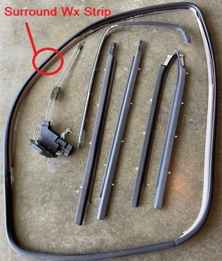

    Sorry, this is what I meant by them being one piece, the one in the other photo (the new door seal I purchased) lacks that tan part that seals over the trim leaving that gap you see in pic below.

    Is the replacement part the same shape, but all-black?

    Nope, it doesn't have the lip that goes over the interior at all, its only the black seal part. *Edit* the gap in the last pic is still there when I installed the black one, I can redo it again for pics if you want.

    Super weird. I'm digging thru the diagrams and I cannot find rubber seals anywhere. I know I found them for MY truck (access cab), but I can't seem to find the same for YOUR truck (double cab).

    I really appreciate it, I can't figure this out and I've contacted 5 dealers asking about it and they've all given me different part #'s. I spent a pretty penny on these new ones and they aren't the correct kind, so I might just have to carefully cut the lip on my old one and somehow glue it to the new one.

    You're giving the dealers the VIN and they can't identify the part? Hopefully at least they are refunding you.

    https://www.tundras.com/threads/par...molding-for-gen-1-tundra.107290/#post-2797459
    06 DC
    62311C WEATHERSTRIP, FRONT DOOR OPENING TRIM, RH
    62311-0C030-B0 MD.CHARCOAL, TRIM11
    62311-0C030-B1 MD.GRAY, TRIM12
    62311-0C030-E1 FAWN, TRIM42, 43
    62312C WEATHERSTRIP, FRONT DOOR OPENING TRIM, LH
    62312-0C030-B0 MD.CHARCOAL, TRIM11
    62312-0C030-B1 MD.GRAY, TRIM12
    62312-0C030-E1 FAWN, TRIM42

    I'll be taking pics soon of it all put back together very soon, the hood is on, but still needs polishing.
    Yeah, it's been a nightmare, I am trying to process a refund and haven't heard back yet.
    THIS LOOKS LIKE IT, REALLY SUPER DUPER CLOSE!! THANK YOU SO MUCH!
    I'm gonna buy this and cross my fingers, thank you!

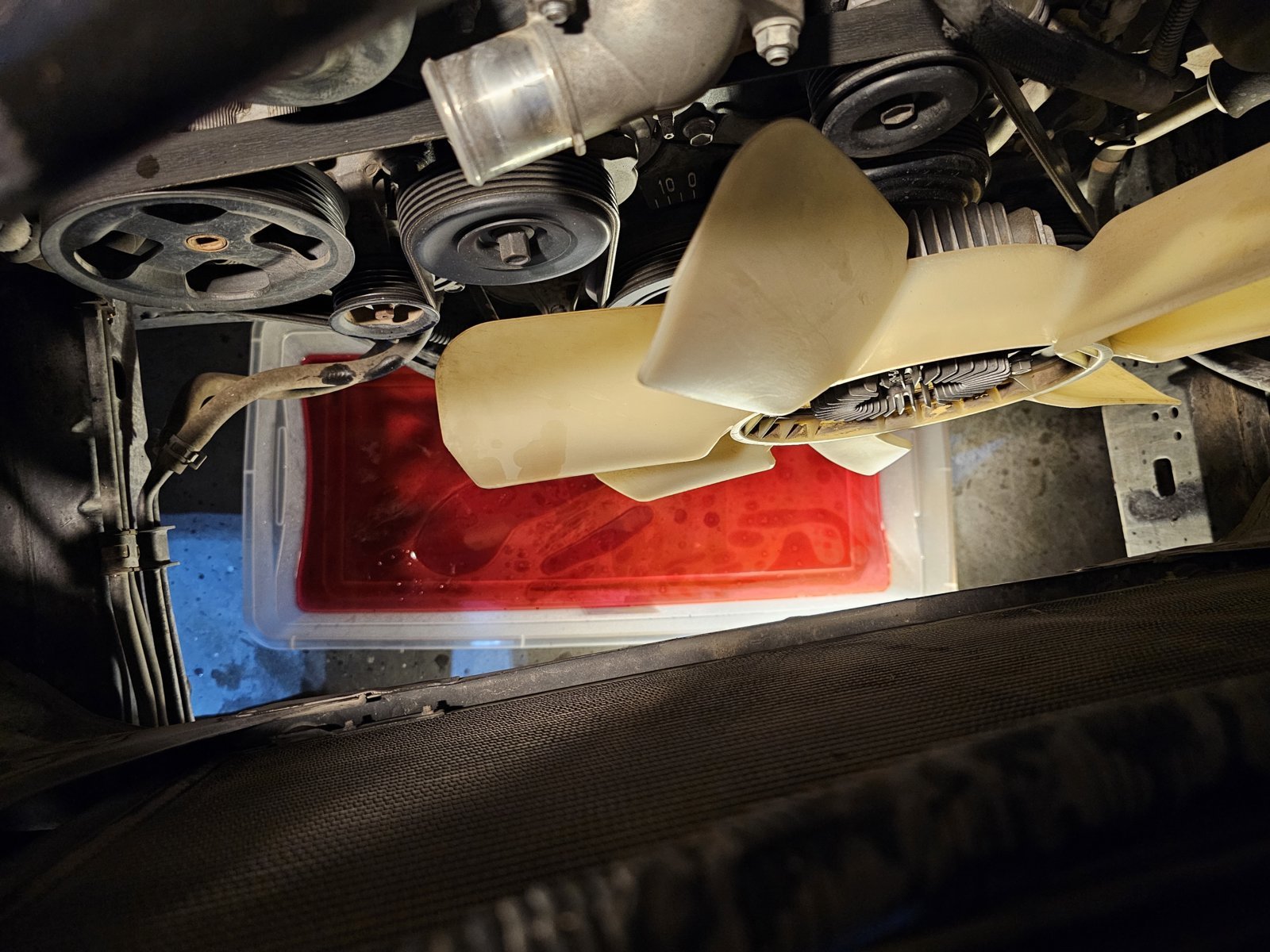

    Good news was no milk shake made by my radiator, also transmission fluid looks very clean
    Bad news one of the nuts on the fan clutch is nearly stripped, tried to get it for an hour. Gonna have to hit it tomorrow.

    I got the fan clutch off, working my way through the rest of it.. please tell me these aren't cam shaft seal leaks.. they look like valve cover gasket leaks to me, but I don't know. Something (oil) is definitely leaking though.

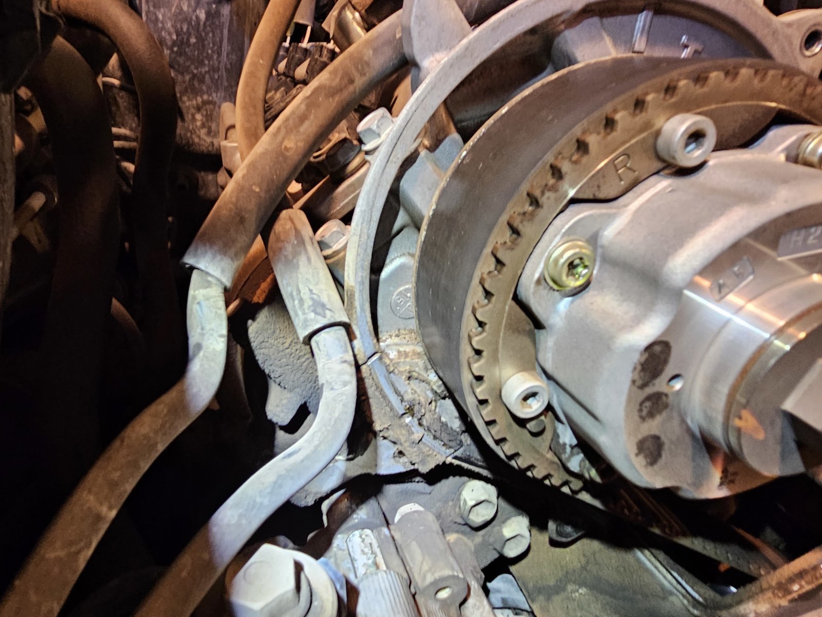

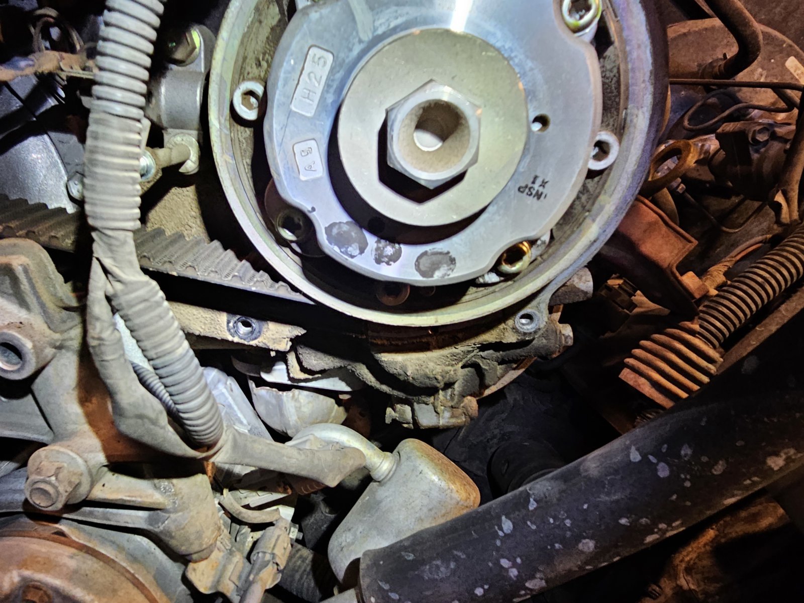

    Okay, I need some advice, I was putting in the timing belt tension bolts, one went righty loosey and broke off entirely, 2/3 of the bolt is still in the hole. I was using a digital torque wrench because I was afraid of this exact scenario. I got to 10ft/lbs and it snapped off. This is the ASIN kit replacement timing belt. How F***ed am I?
    *Not the pulley, the hydraulic tensioner with two bolts at the bottom.
    **Nevermind, I have a buddy coming over to weld a nut to it and extract it. It's not as bad as I thought it was.
