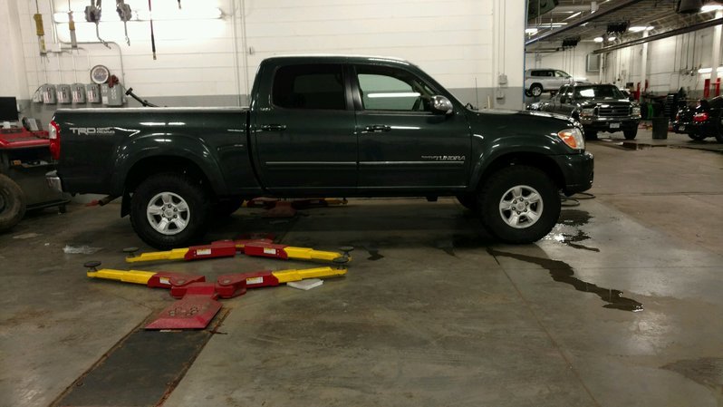

    The start of the build process, lift and tires. I found a good, almost unused set of 255/85r16 tires, Cooper ST Maxx. A skinny set of 33s that I love running on my Tacoma and 4runner. We will see how they feel on a Tundra. My initial thoughts, wish I got some skinny 35s.
    For a lift I went with a Toytec Boss system. I went with the 3 leaf progressive in the rear over the block. I also added some SPC upper arms for better alignment angles (the added benefit of replacing loose upper joints)
    I found out running a wheel spacer was needed for clearing the frame at full lock both directions, I happened to have a set and bolted them on while doing the lift.

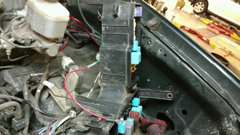

    I had to add communications and constant 12v power for a fridge. I like using open fuse spots in the factory block for a factory look.

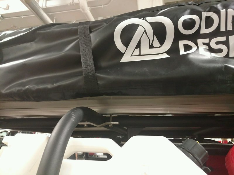

    I picked up a new tent, some light assembly required.
    I found the bolts too small for the tube size, so I needed longer bolts. I was not lucky enough to find a 60mm bolt with a 13mm head. Flat stock on tube wouldn't really hold that well anyways. I took two pieces of angle iron and my press and bent the flat stock.
    Has to hang off the back for antenna clearance.

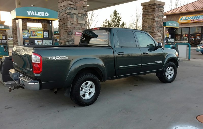

    Picked up some body damage so the bumper will be high clearance style.
