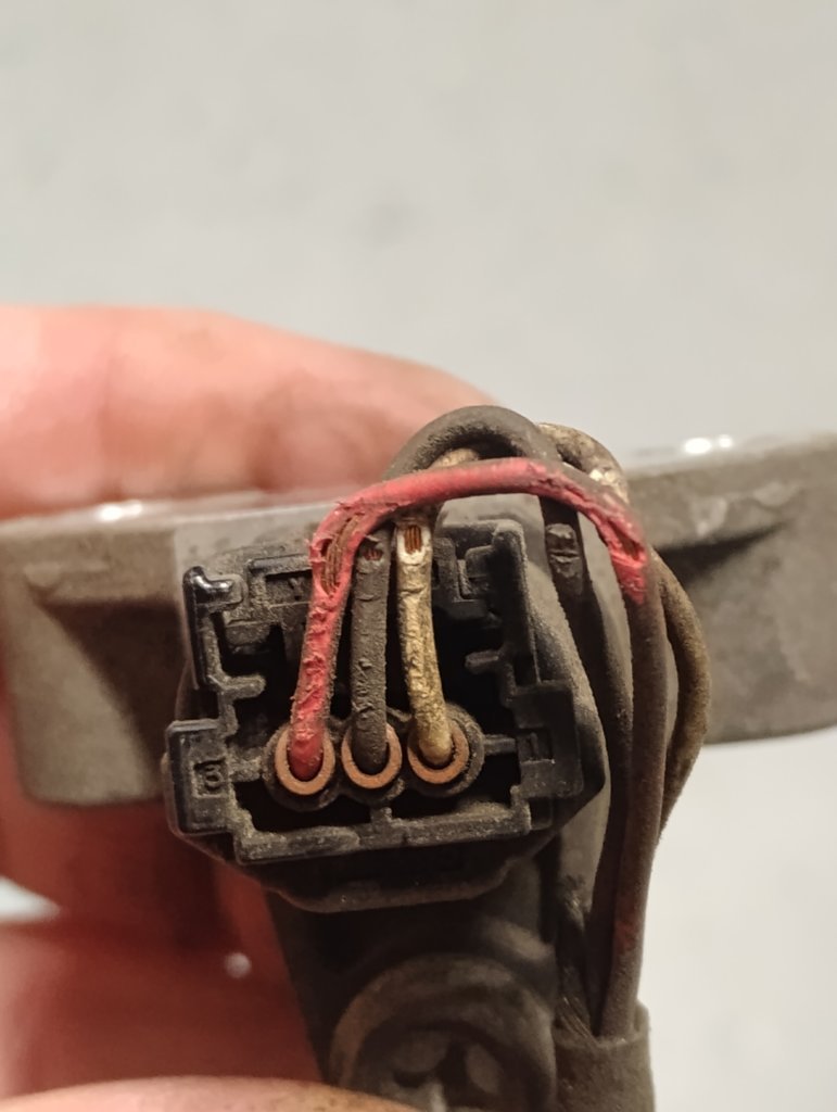

    This is the camshaft position sensor I replaced tonight. Bingo.
    And the more I think about it... I can guess what happened. When my friend (the mechanic who did the timing belt) put the front timing cover back on, the sensor wires got caught and were rubbing on something. I'm guessing there must be a shroud molded into the timing cover, to protect the sensor wires somewhat from the timing belt, and he got the wires pinched up under it. So I'm going to take that cover back off tomorrow night to make sure I didn't make the same mistake.
    CodyP, FrenchToasty and shifty` like this.

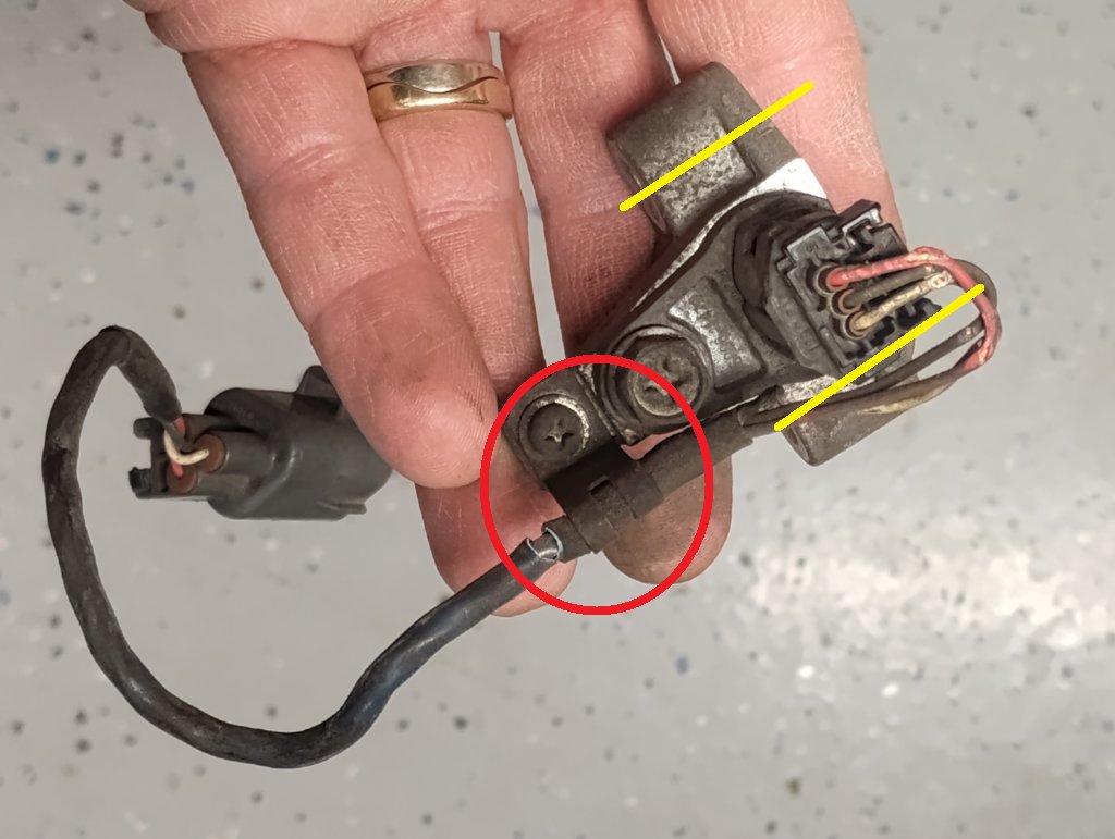

    2006 Tundra 4x4 Double Cab
    It was stupid of me not to determine exactly what the old sensor was rubbing on before I closed everything back up and zip tied all my cables out of the way of the belts. Now I'm concerned that I could have done something that will wreck the new sensor in the same way as the old one.
    I've looked at several videos online... it doesn't make sense now that the pinch on those wires would have come from the plastic timing cover. But it's obvious from the marks on the wires that they were all rubbed by the same straight edge of something. My best guess is that it's from the water pump replacement somehow, as he changed that out at the same time. But since all I did was change the sensor (i.e., no water pump or other work), and I visually verified that the wires were clear after I installed it, I should be in good shape. I'm going to pull the grommet out of the timing chain cover and stick a borescope camera in there before I drive it anymore though, to make sure that it's all good.

    The cam position sensor is supposed to pass thru a rubber grommet in the timing cover, and the plastic clip at the end of wire is somehow supposed to lock onto something, to keep it from touching anything moving.
  23. Nov 12, 2024 at 4:49 PM
    #53
    Alaska Archie
    Alaska Archie [OP] New Member
    Feb 13, 2023
    #92002
    38
    Roman
    Someone previously busted the clips for the wires you're referring to, so they were all zip-tied in place, I had to cut them free to replace my cam sensor. I've got them all zip-tied back out of the way. I'm talking about the red/black/white wires that come into the sensor itself, where the copper is exposed on those 2 pics. I think my mechanic must have somehow gotten the water pump hung up on them when he put the new one in. That looks like the only thing that could have rubbed out and exposed the copper in a straight line across all those wires. You can really see it well in my first picture, the one that's not as zoomed in.

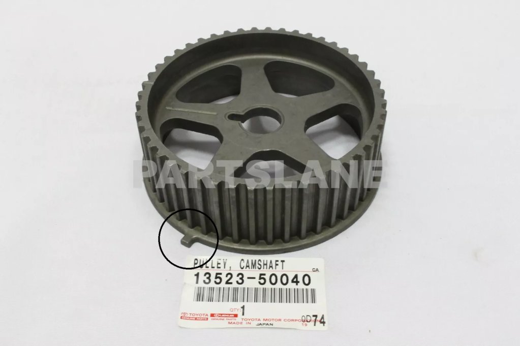

    IIRC, there are two bolts holding the sensor to the head and/or block where my yellow lines are here. The clip I circled in red is supposed to act as a tether to hold the wires back and away from harm's way. I can't rembmer the orientation of the sensor, but I feel like it'd have been rubbed by the timing belt, most likely. It wouldn't make sense for it to be rubbed by the cam itself. I'm quite certain the side that's touching your middle/index finger's fingerprints is what reads the little tab protruberance on the camshaft, so know when it's rotated.
    This is the tab it reads, IIRC. If this tab gets snapped off on the driver's side, you're pretty much fucked. And somehow, I've seen a lot of people snap that little bastard off.

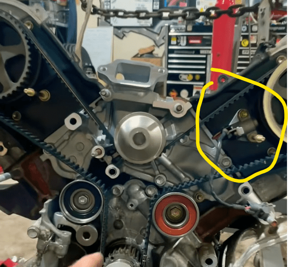

    Here's a great picture of that sensor. I'm 99.9% certain that mine was caught on the edge of the water pump when the pump was replaced.
