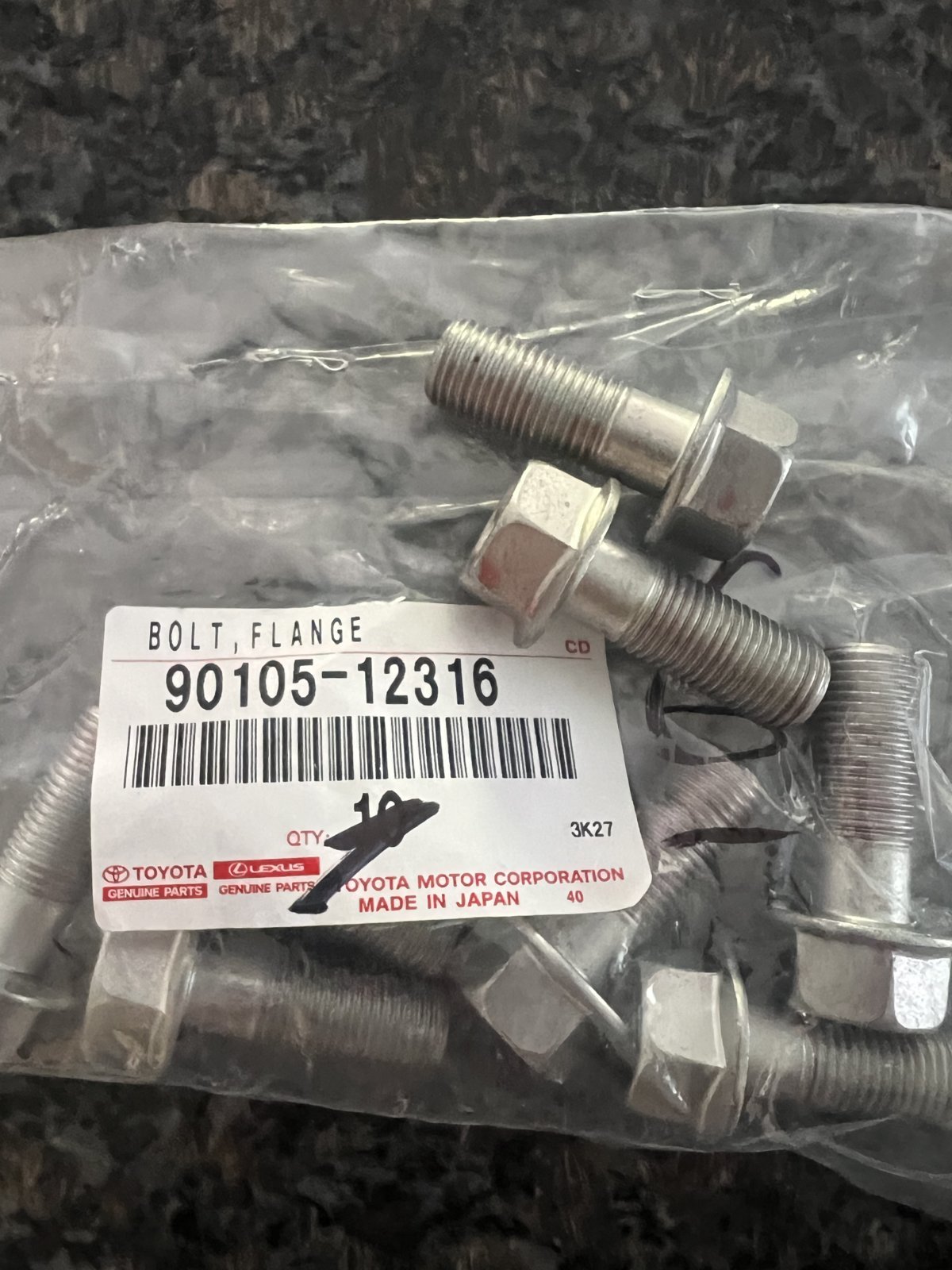

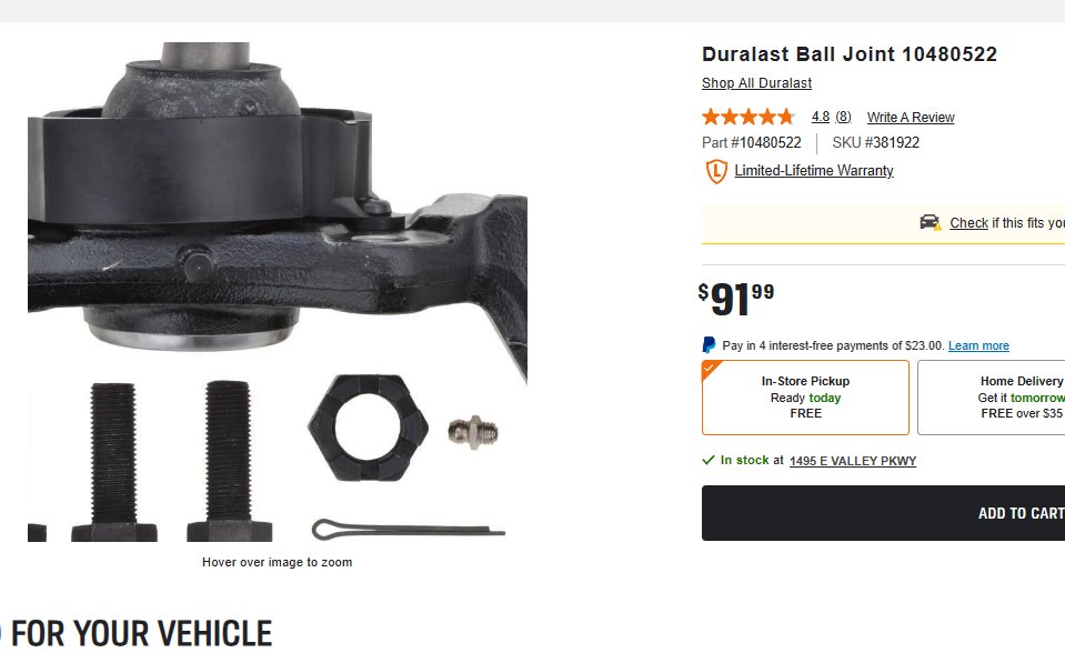

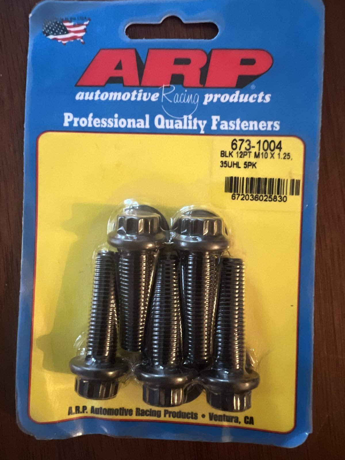

    Busy week - Sequoia continues to impress. I finally broke down and drove my truck today as it hadn’t moved since I brought the Sequoia home on 1/2.
    Couple additions / arrivals -
    @1lowlife was kind enough to send out a set of replacement hub caps so we didn’t have to roll with the black dust covers - really appreciate that! :hattip:
    Half of the bolts for the LBJs showed up - not sure why shipping time on Amazon suck lately.

    Could be wrong, but looking at the picture you posted of the LBJs on the truck, I'm pretty sure you have the later bigger (better) ball joints with M12 bolts, not the earlier style with the M10 bolts.

    I’ll have to double check.

    They’re definitely the wrong ones - thank you for catching this before it’s torn apart!

    Found the correct bolts - maybe doing the ball joints this weekend.

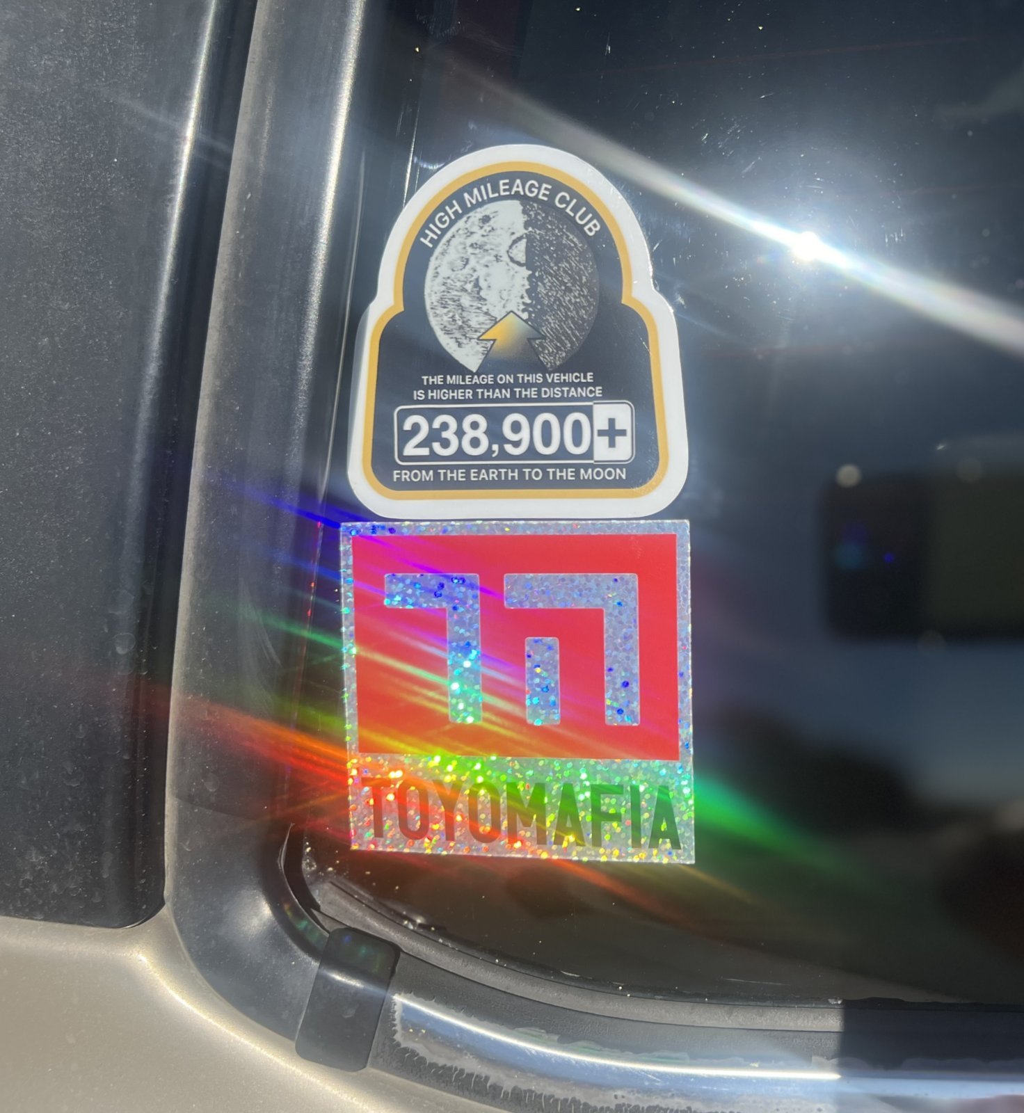

    More artwork -

    That mileage sticker is great.

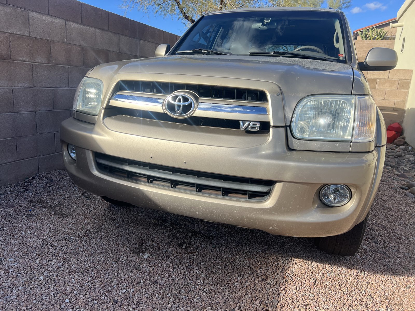

    Got a 3M lens restoration kit to clean up the fogs that were really cloudy - they cleaned up nice but now they make the headlights look tired.

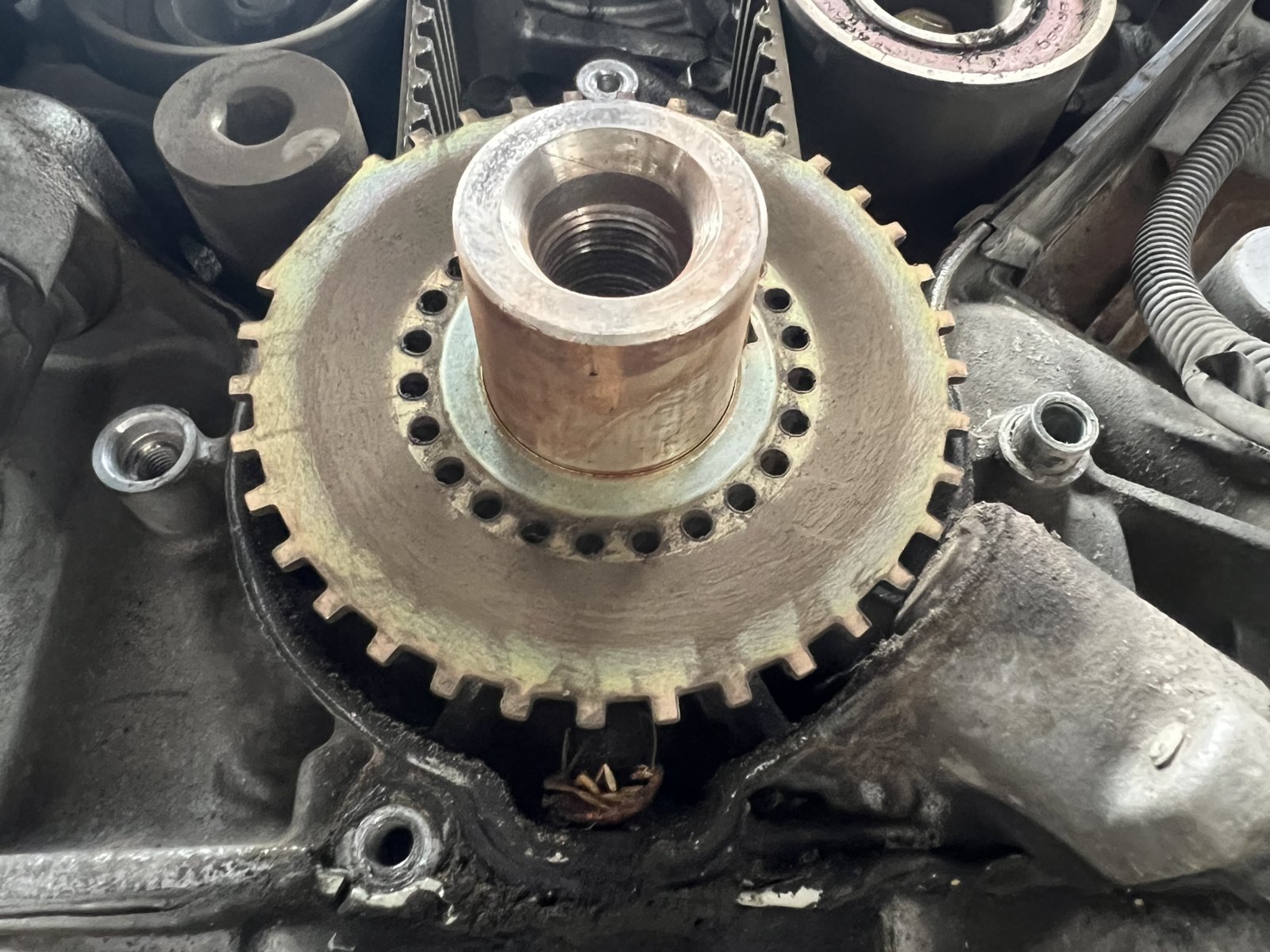

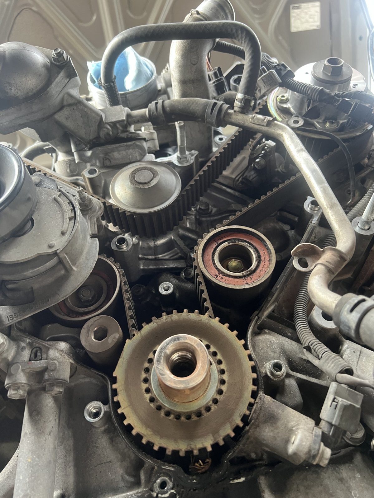

    Long time with no update. End of January the radiator started leaking on the front side. Didn’t drive it much since it was losing coolant but I didn’t want to change the radiator until I had time to do the water pump and timing belt. The time came yesterday - roughly 7 hours to complete the job for a couple first timers - a good hour of that was spent trying to get the fan off the hub. Not particularly easy but certainly could have been worse. Had to evict this guy.
    Fresh water pump, o-rings, timing belt, timing belt tensioner and pulleys, serp belt, radiator, and rad hoses. Need to knock out the ball joints then hopefully I’m done for a long while.

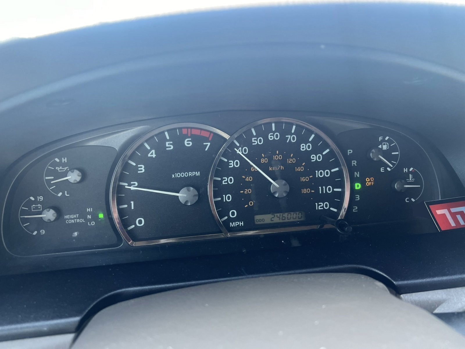

    Crossed 246k miles this morning. Still haven’t done the ball joints yet but truck is running / driving great.

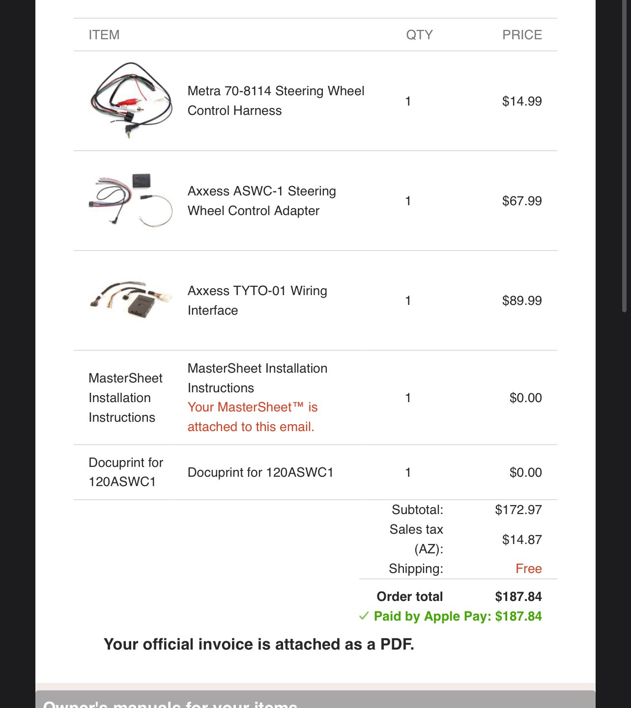

    Ordered parts for the Kenwood HU install. Harnesses / adapters cost more than I paid for my first HU.

    Does it not need a dash trim kit?
