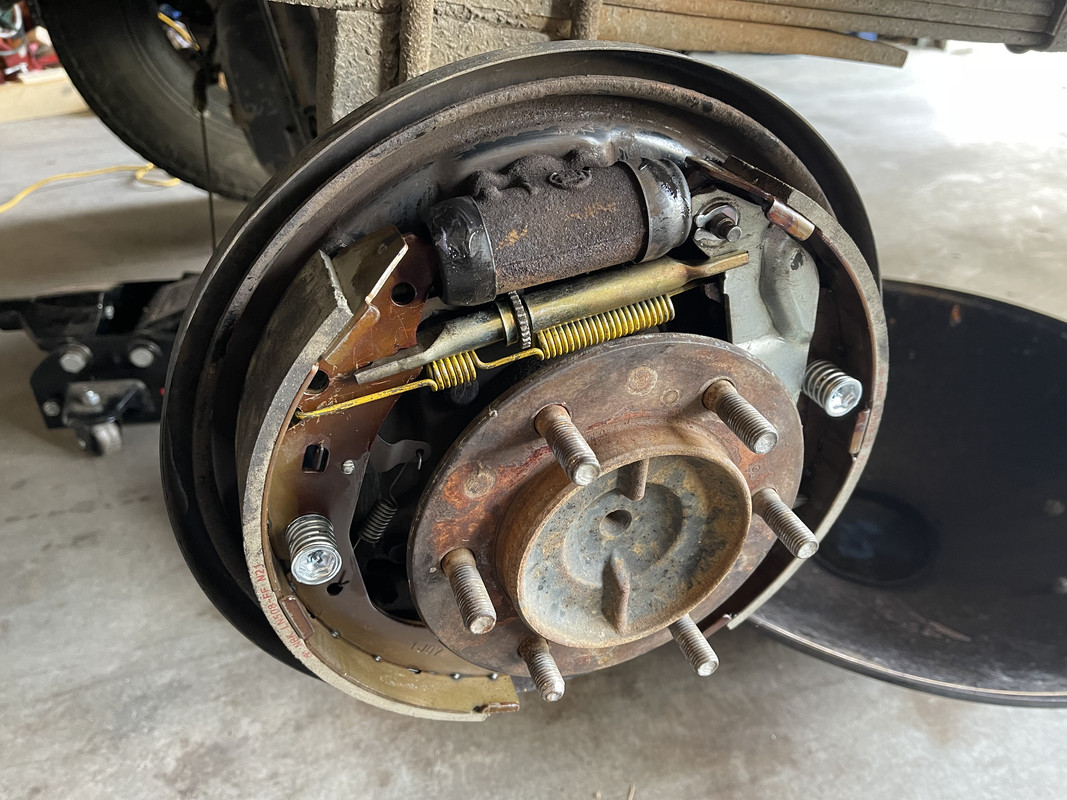

    Took the Tundra in to have the tires rotated and they let me know I needed the brakes done. I knew it was due but, Les Schwab really increased the urgency. I went home and ordered the parts. Stops better than ever.
    fronts redone:
    Rear redone:

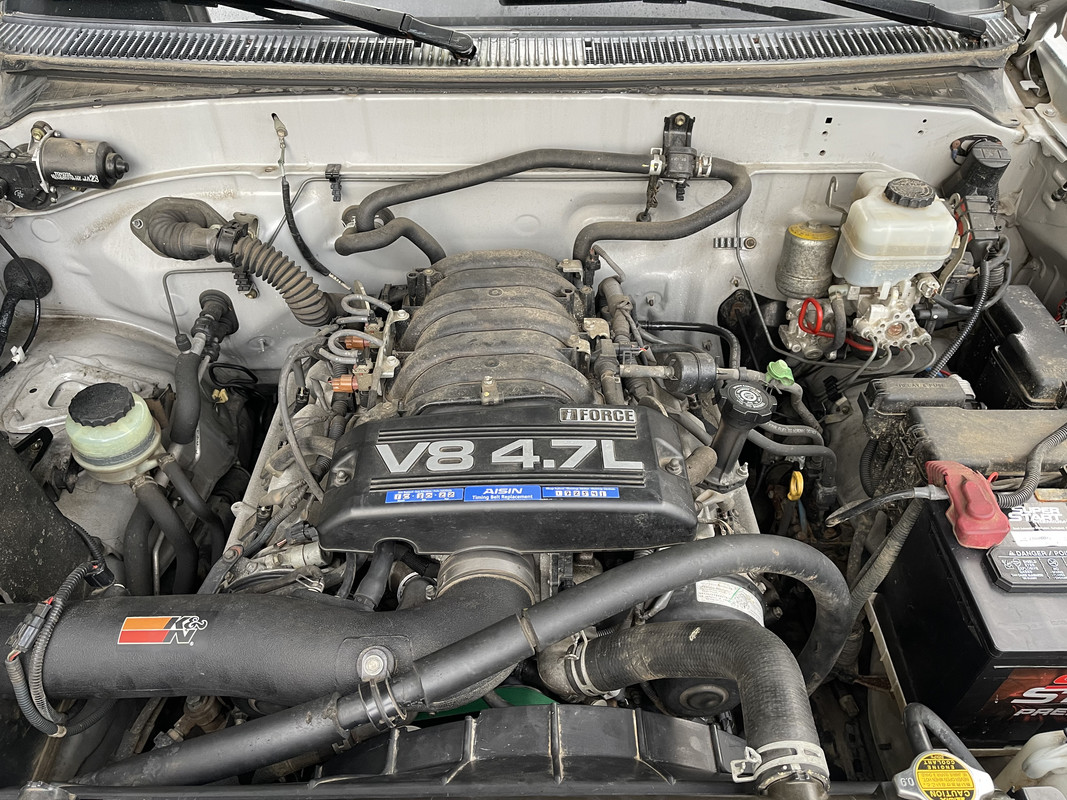

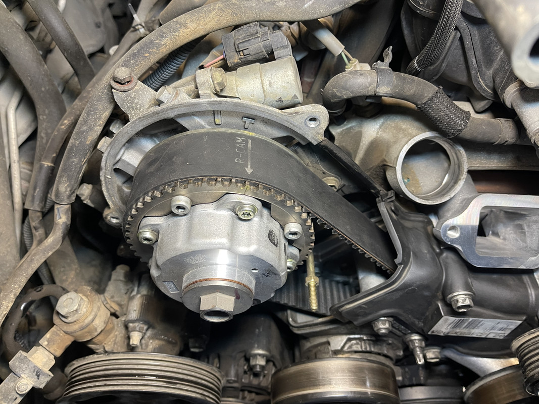

    I finally got around to doing the timing belt yesterday. I've heard it's a 9+ hour job. It was my first time around and it took me 12 hours. At about hour 10, I really started losing steam and it became not fun. There's a plethora of writeups and videos on the process so, I'm not going to do a service thread. Also, I didn't take many pictures of the process. I will share a few highlights that, I hope, can help some people.
    I've watched quite a few videos on doing the service in the past but, this is the one I watched as I was doing it. A good, quick and concise video of the process (with the exception of replacing the water pump).
    The screw on top of the AC compressor was a bear. I stripped the head trying to get it out. Had to use a drill and extractor to get it out. Putting a new bolt in was also a huge pain and took a thousand tries. Getting the bolt through the ground wire and bracket and into the threads was NOT easy.
    Another bump in the road was lining up the AC compressor with the fan pulley bracket. With the AC compressor unbolted, it feels like the rear bolts were holding it and it wouldn't move. When I installed the fan pulley bracket, the bolt holes didn't line up. After taking the new bracket off a number of times and lightly trying to pull the AC compressor up, I was having no luck. I even reinstalled the old one thinking the new casting was misaligned but, that didn't work. Finally, I reefed on the AC compressor and it budged up. That was huge relief. I was really at a loss when I thought the AC compressor wasn't going to be moving.
    Having a lifted pickup didn't make things easier.
    I got coolant everywhere. I suppose I could have spent more time draining it properly.
    Getting the timing belt on wasn't too bad. Advancing to ATDC (cam marks advanced to the "T") is the way to go. I had no problems with the cams moving.
    I didn't remove the rad. Like the guy in the above video, I placed cardboard in front of it. I didn't have any problems with space to work. FYI, the unfolded box for the Aisin fan pulley bracket is perfectly sized to protect the rad. It's surprisingly perfect, as if it was made for it. It's even got a tab that folds over the top of the rad that holds the cardboard in place.
    Everything off:
    Right and left cams at ATDC with new belt:
    Everything buttoned back up (except for the 4.7 cover): *updated*
    All in all, if I had to do it again, I would. It was a long job but, I'm sure I could do it in 1/2 to 2/3 the time. Like I said, it got long and stopped being a fun job at 10p-11p. I was getting tired of it and was really losing steam. Maybe I could have stopped and finished another day but, I just wanted it done. The next time won't take near as long. Also, the only special tool used was a crank pulley holder. Every other tool was a simple hand tool. I guess a torque wrench was used. I won't consider that a simple hand tool.
    Maybe I was tired and really done with it all but, it was really pretty anticlimactic getting it all buttoned back up and starting it for the first time. It all just worked like it did. Kind of boring, really. Not like getting new exhaust or tires and it looking, sounding or performing better. It's just the same old rig as I had before.
    Service done.

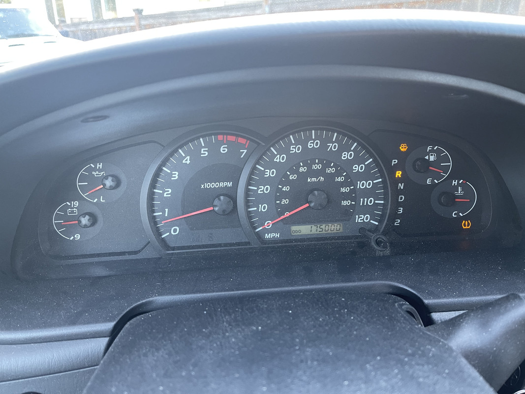

    I PMed you but, here’s the mileage from last night, as it sits.
