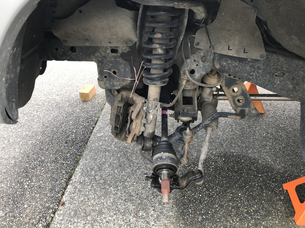

    Did the lower ball joints because I didn't know if or when they were last done. Maybe it's irrational, but I always had a fear they'd go on me. Replaced them without any trouble. Buttoned everything back up and it developed a cyclic wer wer wer when driving. Here's the thread trying to figure it out. It ended up being a wheel bearing. Took the spindles off and just dropped them off at a local-ish 4x4 shop. As long as they're out, I'm going to have the shop also do the upper ball joints. Hopefully I'll have them back by the weekend. The spindles with the RCD lift aren't toothpicks. Also, for anyone taking off the axle nut, 35mm = 1-3/8". I've said it once, I'll say it again; it irritates me Toyota went with a pressed in bearing, instead of a unit bearing. What could have been an hour job that could be done with hand tools is a trip to a shop and waiting for and paying them to do some press work. Bummer.

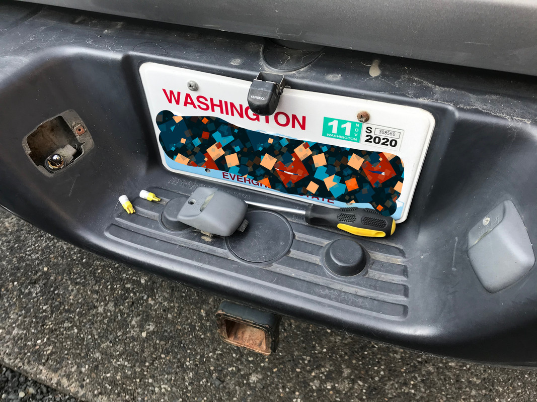

    I figured out wiring the ground lighting so they'd function how I wanted them to. With the short days, being in the dark when I go to and from work, they're nice to have. They mimic the cargo/bed lighting. When I unlock it, the ground lighting comes on. When I close the door or lock it, they go off.
    Wiring
    Lights
    Lights on
    Function

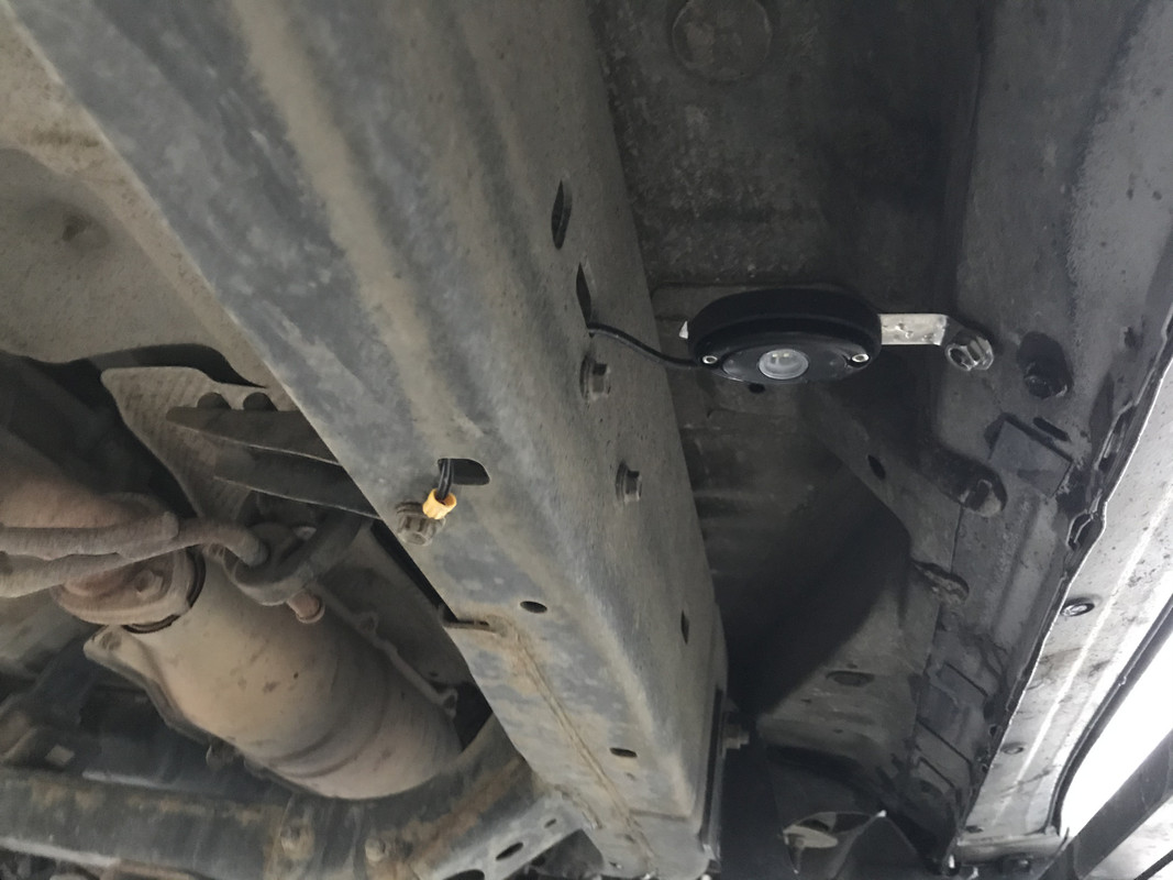

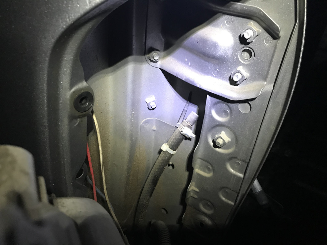

    While I had the housing removed, for posterity, I got a picture of the rear diff breather mod.

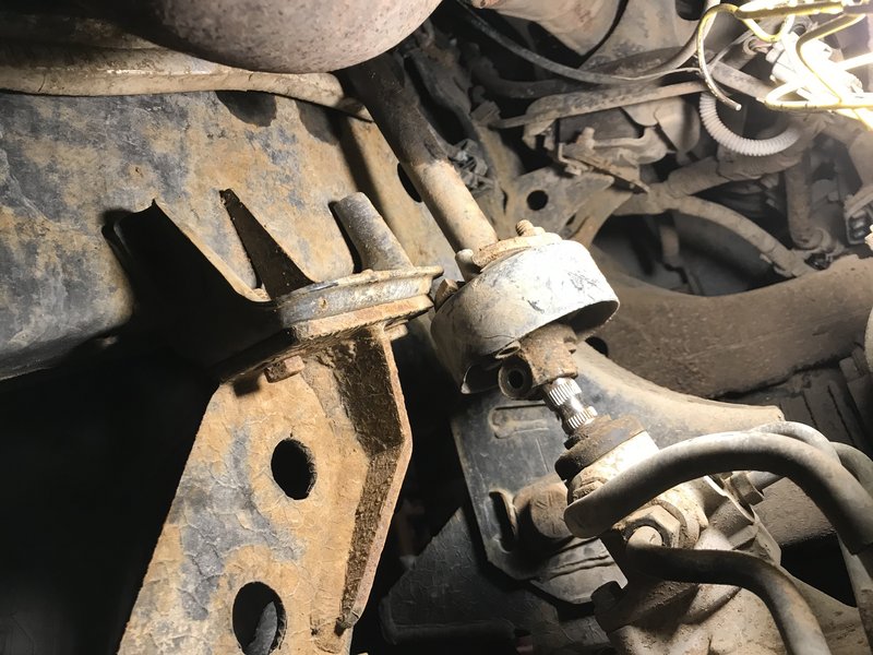

    I also replaced the steering shaft seal last night. I was inspired by and followed the instructions here.
    How it looked:
    The connecting rod on my '05 DC did not look like that in the DIY post. Mine was much longer and the upper bolt was further up in the engine bay.
    Theirs:
    Mine (picture from the top after liberal amount of PB Blaster applied):
    Getting the connecting rod off the steering rack shaft was easier than I thought it would be. Putting it back on, it didn't go as smoothly. It slipped right off when taking it apart, but the round housing was contacting the frame when I was trying to get it back together. With a long dowel and a BFH, things went back together.
    Tapping out the old seal was easier than expected. Really didn't take much to get it moving.
    The new seal went in very easily. The DIY thread mentions putting the seal in the freezer and letting it cool to help installation. I didn't freeze it and had no problem at all getting it in place.
    Out with the old, in with the new.
    I drove it a bit last night and to work this morning. The cab is a bit quieter. The greatest change I've noticed is how much quicker the heater warms up the cab and difference in humidity in the cab.
