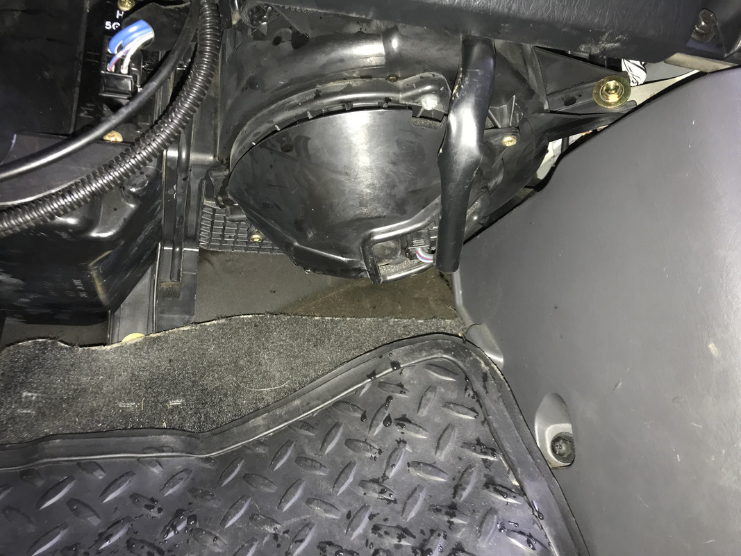

    What is this and what’s wrong that it’s dripping water into the cab? It drips, probably, close to 1/3 cup a day. It only started doing it in the last few days. I thought it was just kids getting into the truck, it’s been raining the last few days, but took a closer look and definitely saw it dripping through the square hole. A little insight/direction from someone here would be great.

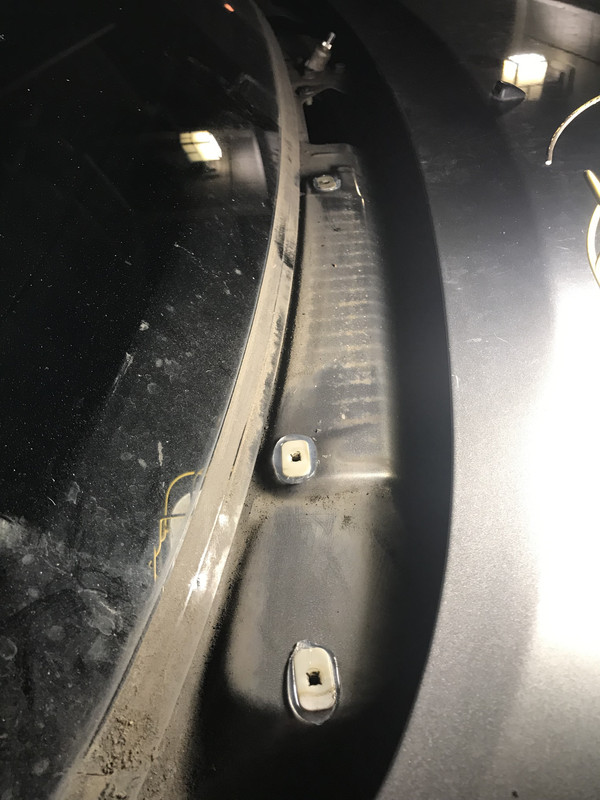

    LOL, I responded to that post and yes their fix does work. My 2004 used to leak, no more

    It doesn’t take much more than 30 mins. Do it today/tonight and it’ll be dry and fixed for your trip. Just remove wipers, then the cowl, brush away old rubber gaskets if still there and apply silicone around the inserts. Dry time should be 20 mins then reassemble.

    A little update. I finally got around to doing this. The biggest problem was getting a stuck wiper off. Once that was done, it was easy sailing. Looking forward to a whole lot less condensation in the cab.
