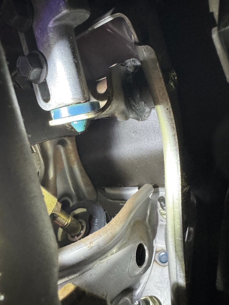

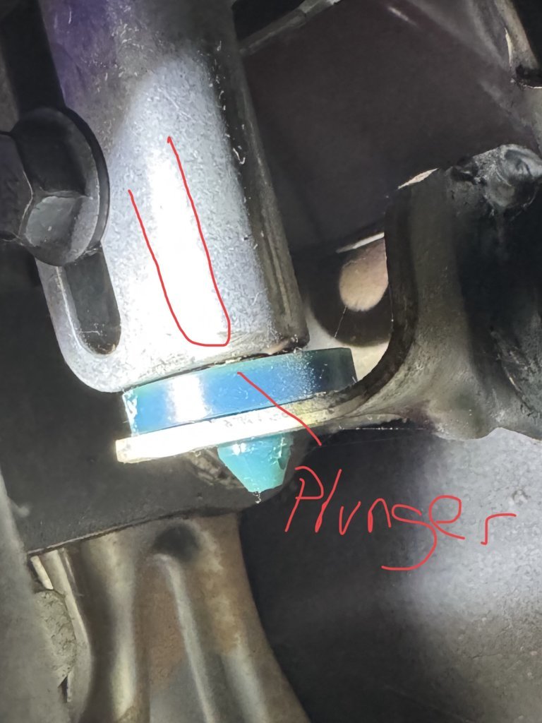

    Look under the dash. On each side of the brake pedal lever is a plastic button. The green one activates the brake light and the blue one holds in a spring loaded plunger on the column that locks the shifter. When you press the brake pedal the plunger moves out and unlocks the shifter. If there is any corrosion on the plunger, it can get stuck. If it’s stuck apply a dab of grease to the plunger ball end and work the plunger in and out multiple times by pressing on the end with a flat bladed screwdriver. Note the button is flush against the plunger because my engine was off and I couldn’t press the brake pedal at same time as taking the photo.

    Can you adjust the travel on the brake pedal? I’m finding that I have to really mash the pedal to get separation from the plunger and grommet to allow my truck to shift into gear.
  13. Sep 24, 2024 at 6:03 AM
    shifty`
    shifty` A means to an end, but the ends don't seem to meet
    Jun 20, 2020
    #48239
    25,401
    ATL
    '06 AC Limited V8/4WD
    I mean, I'm not saying it's so, but if you look at that picture, notice the flanged bolt is sitting in a slot, it would appear it can be adjusted. Maybe yours is loose and bottomed out? Or maybe that's not how it works. It's worth looking into though.
