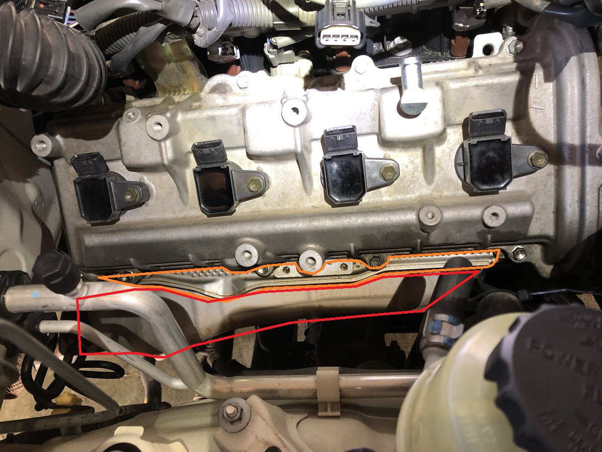

  5. Apr 20, 2023 at 8:55 AM
    shifty`
    shifty` We call it “riding the gravy train”
    Jun 20, 2020
    #48239
    29,827
    ATL
    '06 AC Limited V8/4WD
    You may not get an answer, this member hasn't been active in months.
